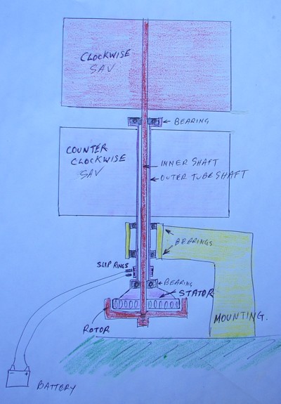

The idea is to have two counter rotating savs. One driving the stator and the other driving the rotor.
It doubles the speed of the generator without the power loss of a gearbox or other power loosing transmission. OK. So there is the losses of 4 bearings instead of 2, but that's bloody good for such an increase in gen speed.
What's more this setup is easy to mount an F&P on to and would be about right for a 2 x 200 litre drum rig.
Here's a sketch of how I see it:
Any better thoughts??
Cheers Gill _Cairns, FNQ

I have been pursuing this idea for a few months but went cold due to the slip rings for the rotating stator.Not having any previous experience with slip rings and indications from others comments were negative regarding expense.But I have a very similar design to the above concept and if slip rings are not an issue it definitely has merit.In my version the rotor is mounted by five of the ten drain holes directly to the base of the bottom Sav.A second F&P unit could be attached similar to Glenn's HWAT twin stator setup.Which might gain the best of both the torque and increased speed.
Anthony.

Good Idea in theory, but looks like a complicated nightmare to make. I don't like slip rings for a start. Good luck with it though.

Good one jarbar, I can't comment on the expense as that's a relative thing (to HER shopping plans).
No reason to stick with a sav, as a lenz would do just as well or much better.
I've a little difficulty understanding how it goes together with rotor screwed to one sav unless it was between them. Yes that could work.
No problem making slip rings if you have lathe access. Though without it I don't think I would try this project.
Posted: 01:52pm 24 Feb 2008
That's an intersting concept Gill. I see no problems with slip rings (I do have a lathe ) but there might be a problem balancing the stator since it has to hold all the rectifiers as well securely in place. Unless you opt for 3 slip rings for three phase AC output or even 7 slip rings with the 7 phase conversion.
Would not a Lenz2 be better for this idea?

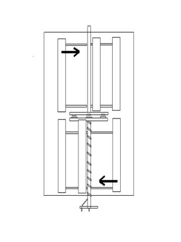

Hi Gill "Some thoughts"
Any thoughts to putting the stator in the middle of the mill?
Could there be turbulants from the two differant directions?
If the slip plates could be enclosed from the elements would they last better?

I think most VAWTS could use this system. Balancing would have to be of the shaft and all attachments (includes stator). Securely attaching rectifier is not such a drama if fitted with mounting hole or stud.
Wind Pirate,
Stator in the middle mentioned already. With the torque of these VAWTS, why not fit one in middle and on the bottom of the same mill? Ideal for Glen's dual staggered winding giving early cut-in as well as a high speed generation?
I can't see any great turbulence issues. Certainly none in the order of counter rotating propellers or helicopter rotors. That's why I don't see this as having any potential with HAWTS.

Many proven techniques (slip rings) can be porly designed or manufactured when utilised in specific equipment. As Gordon advised, it is a standard method on much higher rpm motors than we run VAWTS at. There is nothing wrong with the idea when it is correctly made.
All vehicle starter motors run heavy brushes on to a commutator and a commutator with its gaps and arcing is much more severe than any smooth slip ring.

There would not be any serious problem issues with the relative speeds of the 2 sections. The stator and rotor of the F&P will still perform the energy conversion. If one section is spinning more slowly, then the total relative RPM will be less.
A VAWT of the same physical size, and only spinning one way will still have the problem of wind exposure difference between the upper and lower parts.
Mechanical issues with a gearing system or a counter rotating system would still be there. The losses in a step up gearbox would probably be greater, but may provide a better alternator match as any step up gear ratio can be selected. The counter rotating system I think can only give a max x2 RPM speed increase at the alternator.

I'm with Gizmo, think a single unit of the same dimensions with a 2:1 synchronous (toothed flat) belt drive would be easier to maintain and make pretty much the same power.
Unless the bottom of top unit and the top of the bottom unit were full discs there would be a fair bit of turbulence and drag as the two sections passed each other.
Synchronous belts are pretty efficient and would allow fine tuning of ratio.
Hope so anyway or will have to redraw my Lenz2 plans.
