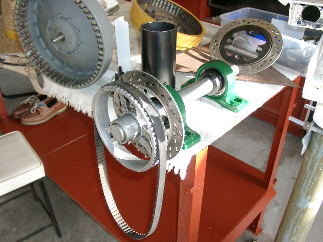

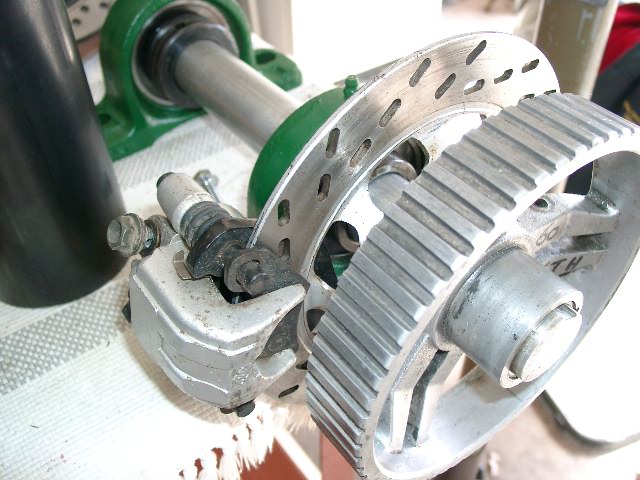

Hello Crew,, been working on a new geared timing belt drive shaft ,lately. I've fitted a motorcycle disc brake for easy shut down in storms-we get a few through here,100+ Kph .
The shaft is 32mm and will have the hub at one end for the blades and the other end will carry the disc and gear wheel,, will try a 3:1 ratio at firts,,big 13-14 foot mill should have plety of grunt to over come any friction,he hopes ..
the drive train for the F&P dual set-up will be opposite to sort of balance the weight on the tower -main yaw bearing will be 90mm pipe greased and revolving on a similar ring below ,welded to the stub pipe that will be bolted to the tower steel. I'll angle back the blades to get around 600mm clearence.

Jon Bennett
Joined: 01/11/2007
Posts: 27
Posted: 02:42am 26 Feb 2008
Looks good,how are you going to activate the brake?

Posted: 05:38am 14 Feb 2011
I just found this ,, unfinished project incorporating a motor cycle disc brake .
Tried a bicycle type and it worked ok on a smalle mill
