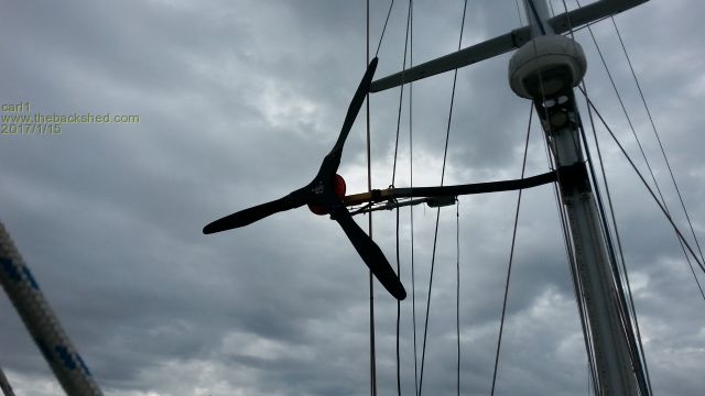

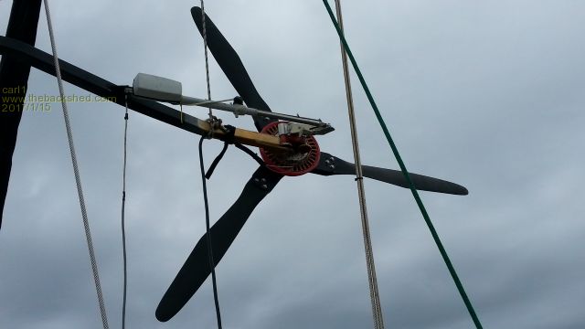

Do you have a figure (Nm) for the cogging resistence of the black rotor smart drive?
I have a set of blades 2.2m , ex Lakota mill, which don't overcome cogging so easy.
At the moment I use an LG motor , decogged with " Black 600 blades " 2.0 m , poor output ( 12v system) : 20knts - 20 amps with MPPT.

That's a big wind generator for a yacht
The furling is ingenious,it looks like an electric ram from a medical plinth was used.
I use a similar ram for remote steering (from the bow) on my yacht.

As much I know cogging has nothing to do which way the motor is wired.
My LG motor , even decogged , rounded ends and twisted, has to much magnetic holding force for the " Lakota" blades to start, unless a gust of 15kts comes thru..
From data I did 10 years ago ( see my old entries) at that time the new " 60DS" had a cogging of around 80 to 100gramms , I can't remember if this was at the rotor measured or at 1m radius. With the new black rotor it might be more?
I can't go bigger in blades dia, they won't fit thru the entrance of the boat. The windmill is only up at anchor.
re: 12V ; I use a Midnight classis MPPT. so max. open voltage is 150VDC.
from your published data: F&P Stator power O/P MPPT vs battery:
the 3x4c should be the pefect setup with your programming data of the MTTP - thanks!! If cogging permits it.
Measuering the holding torque of the rotor should be simple: tape a stick even across the front of the rotor and measure the weight you need to put on one end when it starts overcoming the magnetic holding force.
cheers
Harald
Btw: a week ago in a gust at Inskip , 35kts, 35amps , 1.6m 3-blade , the whole mill crashed down on deck when the pivoting pin sheared off. Lost my best blades (old frg) from a German " Black 300 ", extended to 1.6m.
