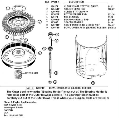

I have been trying to compile a list of F&P rotor and stator part numbers. Has anybody done this? I am looking for the part numbers for what is referred to as the 60 series. The drawing on the "which fp" page states that it is decogged. Is that factory decogged or modified as shown on the "decogging" page?
I have recived a 42774p rotor from F&P, but can not figure out which stator to purchase. I an doing the 7 phase mismatch with the 36 pole rotor and the 42 coil stator. I live in Texas so there are no junk parts available, only new.
Gill

Thanks Gill. I was under the impression that the 426454 was a 36 coil as stated here...http://www.thebackshed.com/Windmill/FORUM1/forum_post s.asp?TID=396&PN=2
The What F&P is it page.. http://www.thebackshed.com/windmill/WhatFP.asp states that the 60 series is 42 pole. You are looking at the stator so I believe you have the right info so one of the other pages must be wrong, or am I wrong?
Gill
Joined: 11/11/2006
Posts: 669
Posted: 01:47am 22 Aug 2008
Barney,
Yes that post by tinbender cannot be correct. I can assure you stator 426454 is 42pole and is the 60 Series with 6mm wire.
I see he advised a part number change from 420775 to 426454 and this was for the 36 pole stator. I feel this is incorrect and perhaps the parts people is USA are not fully aware of the differences. I note the parts list he posted is also incorrect in that the shaft (8) and rotor nut suits the old 42 pole models and not the modern 36 pole stator. The 36 pole shaft uses a bolt and not a nut.
Count the poles of the stator, there's 42. The Rotor number is also for the 42 pole motor. You've been given a bum steer I'm afraid. I'd stick with 420775P for the 36 pole stator and 420774P for the matching rotor.

Just received stator 426454p. Work of art. 42 poles. Do you know the part number for the proper shaft fot the 36 pole rotor? I assume that it is more important that the rotor matches the shaft...so I need the rotor for the 36 pole...right?

Great stuff Barney, now you have the electric bits, lets get the mechanical supporting parts sorted.
With ref to Tinbenders parts pic:
I suggest the following:
Shaft 8
plates 1 x2
nut 5
bearings 6 x2
spacer 7
rotor nut n/a (suit the old rotor)
Further comment,
Some of these parts (bearings & spacer) depends on just how you intend mounting the shaft to the mill.
I like to use a hacked out piece if the Bowl 9 but don't recommend this to you for cost reasons. Glenn uses a different bearing arrangement and this supports the shaft closer to the prop which is a structurally superior design. I have never used this design but feel it better suits your lack of F&P resources. Glenn's construction details are on this site.
I think you could also use the new shaft as it's rotor spline and all other aspects are the same EXCEPT for the bolt and mating shaft hole for securing the rotor. The old method used the threaded shaft end and Rotor nut as shown in the parts pic. So either new or old shaft with their corresponding bolt or nut will do the job. Your choice really.
