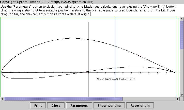

Just starting the second atempt at a VAWT and will be making to the design at the bottom of: http://club.cycom.co.uk/vertAxis.html
Starting to get the bits together but mulling around ideas for the best way to make the blades.
The blades need to be 2m long (3 off)with the profile shown below 23cm wide.

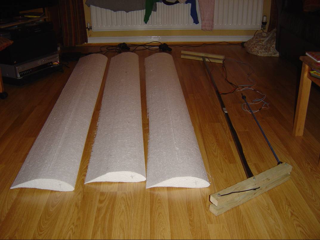

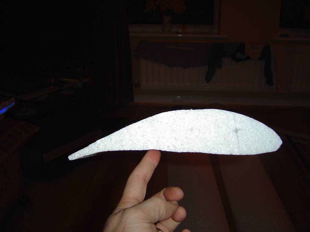

Well had some blade cutting fun, I guess all the web sites that talk about using a battery charger aren't trying to cut 2m long blades, stone cold. In desperation opted for 240v mains and a dimmer switch....ooooooh, don't reccomend that, the singing wire cut one brilliant cut, went orange and snapped, yee haaah.
So with sensible head on, borrowed a comercial DC transformer from work, took some practice, and got better every go, but results below, look ok to me.
Any suggestions from anyone on how easiest to coat them for strength, fiberglass mat would be messy, must be some sort of paint on stuff?

Hi Chris,
You can't use ordinary fibreglass resin on that foam, it just gets eaten away in no time.
You *have* to use epoxy resin, but you can't use glass mat for that either as it wont wet out proprly due the binder in the mat.
Get some woven glass cloth and epoxy resin and you're on your way to strenghten these blades. This task may be more involved than you bargained for if you want a halfway decent finish .
Make sure you have some non crushable inserts under the glass where the mounting screws go.

Tinker, your suggestion feels like the one for me, just had a look for glass fibre cloth and came up with: 50mm wide / 50m long by 0.23mm thick, how does that sound to you, should be easily enough to cover it, just not sure about the thickness?
Chris
Posted: 02:29pm 28 Mar 2008
Chris, before you do any glass taping (BTW, you can get that tape wider as well, 50mm looks too narrow to me) you ought to fair the foam with bog first. Use microspheres for your epoxy fairing mix, it sands very easy.
Run the tape longitudinally afterwards,many thin layers are better (stronger) than one thick layer. If you have never used epoxy before practice on a piece of scrap first. Do read the safety sheet, I always wear rubber gloves when handling that stuff.

Hello Chris,what is the diameter or swing of wings when mounted.And did you calculate this profile using the program from cycom.Or just use the example above.And well done on the cutting.How did the fibre glassing go.
Anthony.
Chris_Psmith
Joined: 06/03/2008
Posts: 5
Posted: 05:18pm 19 Apr 2008
I just used the example they gave for the wing profile as the diameter was just what i was looking for, haven't started on the fiberglass yet, will post picks as soon as i get it done.
