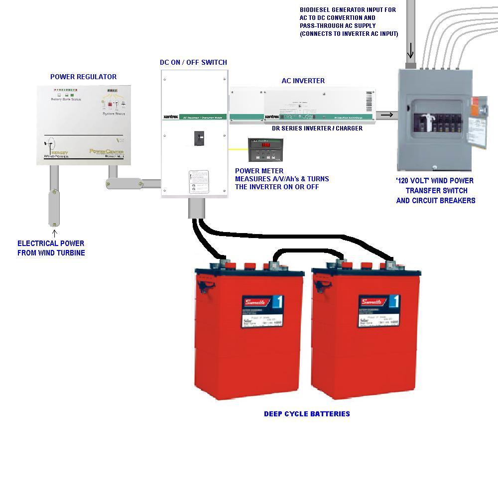

If you are going use a biodiesel gen-set for backup, then I strongly suggest using a Xantrex 'DR series' inverter for your main source of AC power. This inverter has an automatic multi-stage high current battery charger built in. And when the diesel turns on the inverter will automatically start charging your battery bank. The instant your diesel generator shuts off the Inverter will convert your battery power into 120 AC power. The main inverter AC output connects to your load center (fuse box) and from there, supplies electricity to all of your electrical circuits in your house. At no time will you be in the dark.
This type of system will be the best for reliability and is well proven. It is also economical and simple. I can pre-assemble/wire the inverter and all other controls up to a 4' x 6' piece of plywood and ship it to you. The best batteries for your purpose are the ones shown in the picture. They are Surrette L-16's that are 460 Ah and they are made in Spinghill, Nova-Scotia http://www.surrette.com/home.htm
