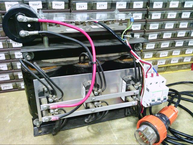

Just to mention something I did a while back that may or may not be useful or relevant to all of this.
I have a large three phase transformer that originally came out of a 24v industrial battery charger, must be about 5Kw, not really sure. But it does have three independent secondary windings, rather like an F&P.
As we know, star or delta connection gives a choice of two different dc output voltages, but there is a third way.
What I did was connect each winding to its own conventional four diode bridge rectifier. The three bridge rectifier dc outputs could then be connected either in parallel or in series.
The parallel connection behaved just like a normal six diode delta connection giving a nice smooth low ripple 30 volts dc output as expected.
Connecting the three bridge rectifiers in series exactly doubled the output voltage to 60v, also giving a nice smooth low ripple output which is higher than you can get with star connection.
I have no idea if this has any practical application for wind turbines, but just thought I would throw this into the discussion.

Posted: 08:18pm 05 Jun 2017
  oztules said
Warp..... that would require cap filtering to work?
The waveform coming out of the three bridge rectifiers series connection is almost pure dc with only a very few percent of ripple. No capacitors required anywhere.
It appears that all three phases when added together in series (through individual rectifier bridges) add up to twice the peak voltage of one phase. And due to the magic of sine waves this addition produces an almost constant dc output.

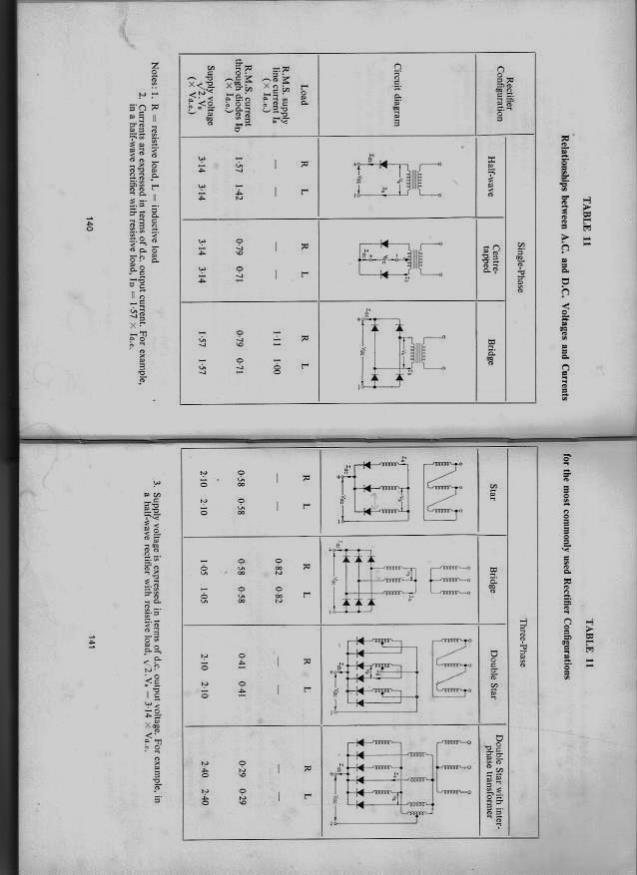

I was curious about this as I have never seen it described in any engineering texts. But it definitely works giving exactly twice the dc output voltage that you would expect from a delta connection plus single six diode bridge.
If I had a camera I could show you the beast, the measured voltages and the waveforms.
I bet it could beat a capacitor multiplier, especially at very low frequency.
How it could be incorporated into a wind turbine I have no idea.
But I leave it for others to try out and experiment with.
Its easy enough to try.

  Warpspeed said   That uprated alternator worked fine. I had no idea it was such a simple conversion, I thought it must have been rewound.
It was designed with the quick change to delta for easy fitment to match the revs of diesel engines probably made back to 1970 or maybe even earlier. I think with a twin v belt pulley that was slightly larger diameter as well. The bosch was OK but the early lucas was a pain, the voltage regulator and other bits were constantly failing from vibration and dust.
DaveP68
Joined: 25/11/2014
Posts: 292
Posted: 09:36pm 13 Jun 2017
Hi Tony
Have tried wiring up an 80's stator in the configuration you suggested. Removed the star point and wired each set of 14 poles per phase to it's own rectifier as per your drawing below.
  Warpspeed said   This is the general idea:
Got the exact results as you described.
One advantage to taking this approach is the voltage levels are better than the standard star output.
Standard Star on an 80s is 0.685 VDC per 1 RPM vs Delta at 0.395 VDC per 1 RPM.
With your set up we get a slightly higher volts per RPM in the series mode of 0.787 VDC per 1 RPM. The parallel set up is the same as Delta at about 0.394 VDC per 1 RPM.
I can see merit in the way this works as the cut in RPM can be reduced by about 18 % if required (18 % higher for same RPM).
Good work and keep those new ideas coming through.
Next step is to try out your switching idea with the view to publishing the results. This could take me a week or 2, as got a bit of other stuff on my plate at present.
DavidEdited by DaveP68 2017-06-15
