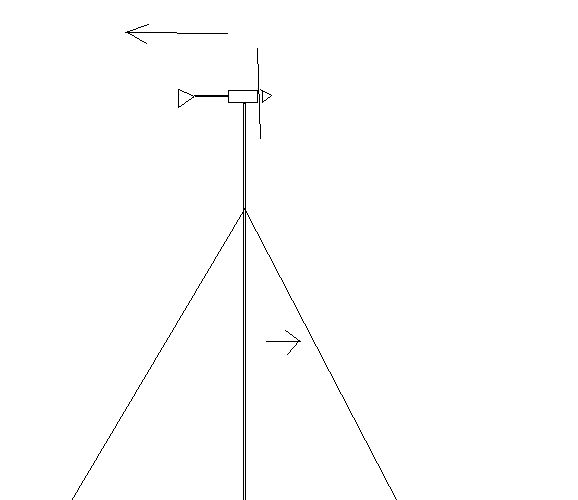

Whatever you decide with a guyed pole I think you need to get the guys as high a possible without fouling the blade tips. As this little diagram shows pressure on the mill causes the pole to bow in the direction of the lower arrow.

Awhile ago I made a tilting tower according to Glenn's drawings but didnt put the guy wires high enough and the first real storm we had BENT 2" thick wall rural gal pipe like a pipe cleaner. The tilting tower is a beaut concept but rigidity is the most important part and make sure your guy wires are just below the blades. I'm my opnion the gin pole tower setup is the best but for a 30' tower the tilting arrangement would also be feasable.

Looking at your ideas I would suggest to make the section up to the tilt pipe a triangular lattice mast. Pipe is just not stiff enough with just one set of guy wires. Just have a look how securely yacht masts are guyed and they normally don't tilt.
