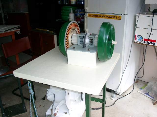

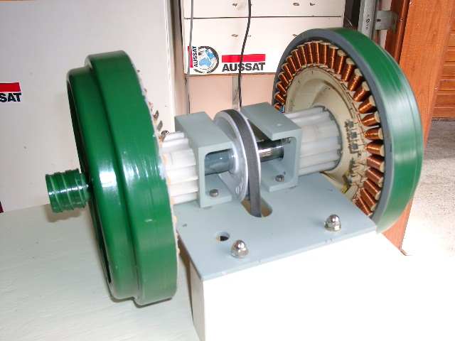

Hi Crew,, I've finally finished making a test bed for testing different re-wires of Stators and running up Neo Rotors .. I'll make an adaptor to fit the Seeley motor also -- With the gearbox (old floor polished) and 1.5 hp motor ,I get 400 rpm ..This can be changed by different pulleys .. Runs smooth ,just the normal gearbox noise..
Bushboy
Posted: 10:51pm 10 Apr 2008
Well done Bruce, very neat.
Do you have any way of measuring your drive motor current and F&P RPM? With those figures you can make some very accurate measurements.
Your workshop looks too clean!

where did you get the gears/pulleys? Where did you get the braces to hold the white plastic to your table?
How are you holding the gear to the shaft? It looks like you have screw. Did you drill a screw hole into the shaft?Edited by imsmooth 2008-04-12

IM,, the white plastic bearing holders were cut from the bowl of the F&P ,,drilled and tapped ,mounted onto Aluminium channel which is drilled and bolted to the Aluminium plate on the top of those 2 blocks of wood to give some clearence..
The pulley is bored on my lathe to tightly fit the shaft and a small seating hole was bored to accept the grub screw in the pulley.
Lots of lathe work and scavenging of parts ... the gearbox was an industrial floor scrubber ,found discarded at the local tip..
The actual frame was an old saw table complete with rise and fall mechanism and a 1 HP 240v motor .. local tip shop ,,$20.
Glenn,, could use a clamp meter and digital hand held rpm meter to do the above,,but Gordon has different ideas,,which I'll try to implement,as I get organized...
Yeah,,workshop is still nice and clean,,,,and all my gear is cleaned and oiled after use..
Bruce
BruceEdited by brucedownunder2 2008-04-12

The rpm are easily measured with a flash strobe light. You can get them locally or on Ebay. Just put a white marker on the hub and you can track with the stobe flash.
I measured my current with a clamp amp meter.

But as I have Mentioned a few times before rigid mounting of the stator in you design prevents the oportunity to measure the input torque and hence the input power directly as done in dynotesters. I will not harp on about it as I have mentioned many times before but notice the forum is not intersted.
I have always used my lathe and supported the stator via the spring balence.
Measuring the input current is so full inacuracies its usless Dr Chalko did but he likely had access to very accurate instruments.
At present I have plans to build a separate tester to fre up my lathe plan is to use an old saw bench and hang FP unit off the shaft with a swinging arm to stop the rotor turning.
Rpm is as said easier to measure digital tacho very cheap nowdays or I have old Mechanical one.
Another thought if you do measure motor current dont forget this current from the AC is lagging voltage so PF must be allowed for this was the major confusion with the measurements given in the use of capacitor topic

Hi Herb,, never thought of the measurements you are talking about --This is just a "gadget" to run up some differently wired stators I have ..
from some of the crude voltages I get ,I'll be able to guage which stators MIGHT be suitable for different rpm's.,,so therefore allowing me to make a rough judgement as to whether one is more suitable than an other for ,say, light winds..

Herb, Bruce, I suppose a jockey wheel to measure belt tension on the 'pull' side could be used to measure input torque?

actually looking you design If you replaced channel with two plumb bearings and attached arms to stop stators turning you would have it you attach spring balence to arms when measuring torque if not rest on table to take torque.
sorry what cost two bearings I generaly use FP setup for my projects.
A idea but it would not be much work to do the above and more accurate. In fact if only one side is done only need one beraing
