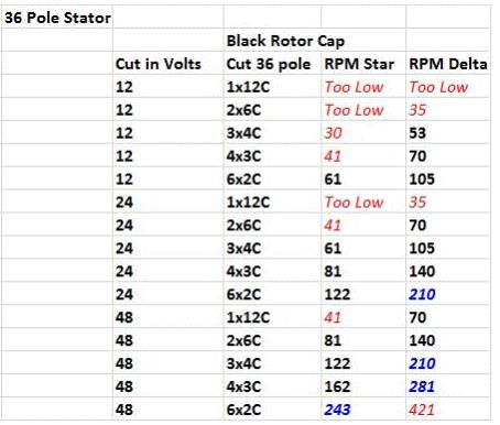

Hi Iv just joined after some time just looking and thinking I must have a go at a windmill, for now I want to just play around and see if I can get any decent results, I got a F&P 36 POLE .6MM wire unit, with a black cap 48 pole rotor these are single magnets, from a used washer, in your rewire section there is no mention of this set up. Im after a general speed mill with either 12 volt or 24 volt output, and dont want to have to re solder because I picked the wrong connections. any advice.

  kalidupakid said   in your rewire section there is no mention of this set up.
F&P stator rewire
I thought this would be your unit. What is different? is it the wire resistance? We can sort something out, getting a motor charging is not rocket surgery. the 5 wiring digrams for a 36 pole is just above the charts. You should be able to click on them to get a larger image.
if you are not sure about some of the formulas to work out amps and watts from free spinning rpm, stator resistance and battery voltage we can help a little with that.

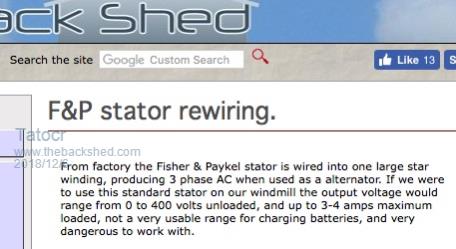

Posted: 07:44am 06 Dec 2018
Hi, Pete. I'm not using anything. I understand that the tests mentioned by DaveP68 are empty, without load. I'm wrong?
Here it also says that it is empty
I'm wrong? Sorry but my English is very poorEdited by Tatocr 2018-12-07
