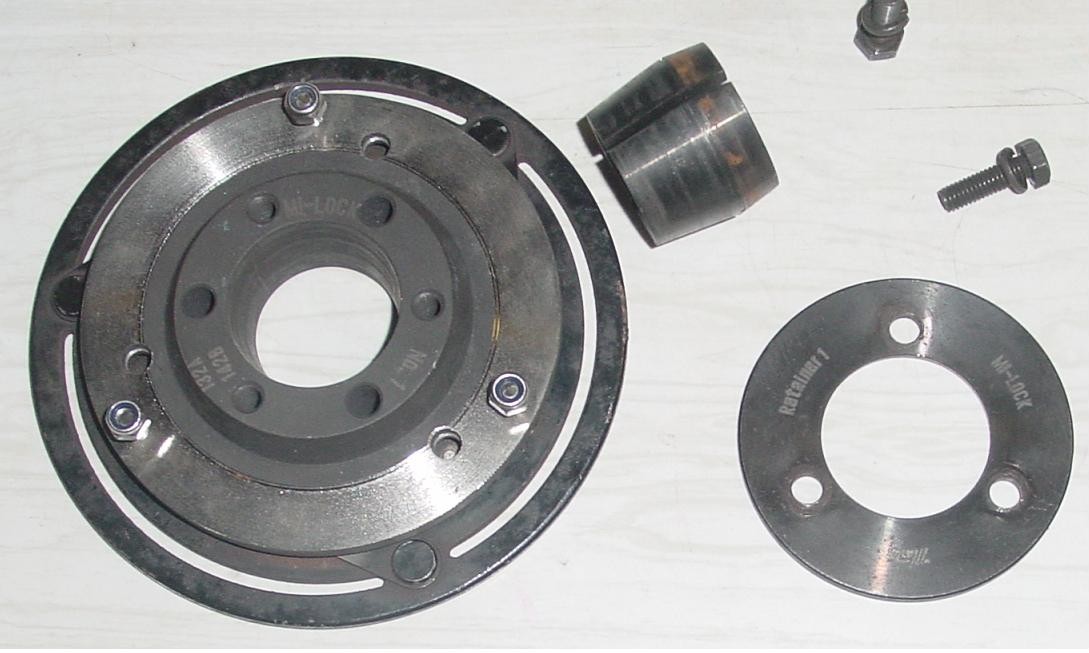

Hi to all
I have use taperlock system with success.
The product name I use is " mi-lock" around 25$ for the set for 25mm, plus whatever size pully you need to use.
I just turned the shaft around, nothing to machine, except the way you want to fix the rotor to the pulley.
I have run a timing pulley 1:1 connected to the propellor shaft of my boat and did some test changing direction of rotating, going from full forward to full reverse @ ~ 1000rpm without a problem.
A few days ago I even made a rotor, rivited to a alu plate, and this plate bolted to a electro magnetic clutch.
I used alu rivets with alu pins, that the rotor doesn't get cracks.
cheers Harald
