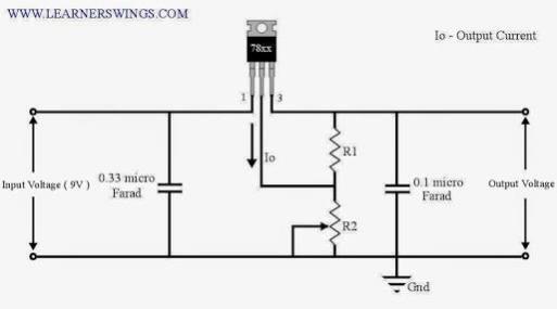

I have some PCB's that are using MCP1703/500 regulators that are supplying 5.0 volts and I would like to know if it is possible to raise the regulated output with either external resistors or a diode in the ground connection?

Datasheet for MCP1703 does not mention anything like this. My guess is that you PROBABLY can, but if I were you, I would be sending an email to Microchip asking the same question. Their technical gurus would know for sure.

Same concept would be for the humble 7805... i guess... the values of the resistors may need tweeking... and it can ONLY adjust to a higher voltage.. the centre pin is the ground connection, so you would do the same with the MCP1703.

Yes, I agree - PROBABLY. The reason for my saying 'probably' is that we don't have an internal schematic for the 1703 regulator, but it is most likely just a variation of the old analogue ones with lower quiescent current and drop-out voltage etc. I would still recommend that you ask Microchip in an email, then you could be sure.
Raising the 1703's ground-reference point might work fine, then again, it might make the regulator unstable. We KNOW we can do this with the 78xx/79xx regulators, as they describe how to do it in the datasheet.

True... why i said " i guess " .. looking at the block diagram i can't see why not.. but i agree asking the manufacturer is always best practice
