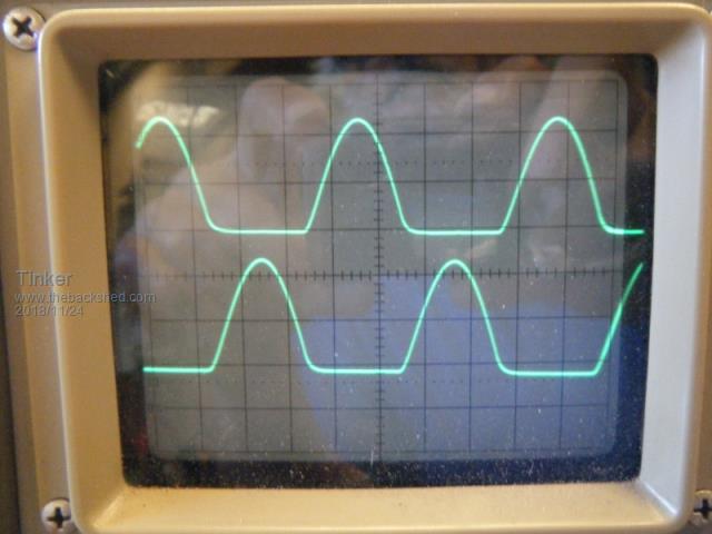

There is this trace at D9 & D10 pins - via the resistor /cap filter:

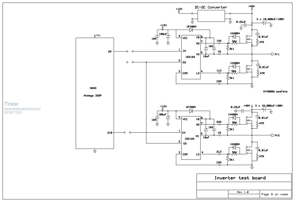

Now what an I do with that? Made a little test board, using this schematic:
Please disregard the big capacitors shown at the 48v rail, only 2 x 4700uF are used.
But the output from that is anything but nice. A quite vague sine wave, with lots of noise spikes appears on the 235V AC side of my little test toroid.
Toroid making unhappy noises.
Bench power supply (50V) drawing too much current for no load output.
2 of the 4 mosfets are getting hot.
Can anybody see a problem with my schematic? I keep staring at it but obviously cant see if there is something wrong .

Tinker, it may be a problem with the layout and grounding more than the circuit. The only unusual thing I could see in the circuit is 2 x 1n4004 diodes on the FET gates - these should be UF4004 some use 1n4148's but Im nor sure they are causing this problem.
Perhaps you could sketch or take a picture - not so we can see how neat it is but more to see the grounding. Because the IR2184's only have a single ground pin for the digital input and drive output it is a bit critical for grounding.
The nano should connect as close as possible to the 2 x pin 3 connections to the IR2184, this is also the exact point the output Fets sources should be tied to. I assume the SD pin of the IR2184's is connected to pin 8 of the nano board - with a 1K pull down resistor. If all is ok except for the distorted output try adding a 1nF capacitor between pins 2 & 3 of both IR2184's - perhaps the SD pin is picking up noise ? Which 2 FETs are getting hot - I assume you are using a choke in series with the toroid ?.

Thanks wiseguy, you were spot on - it looks like a grounding problem.
Connecting the ground to IC2 exactly the same way as at IC1 (an oversight of mine) did improve the trace, the mosfets no longer got hot either.
The whole exercise was just to see how that 2 wire drive signal looks at the power end. And I got a grounding lesson in the bargain .
