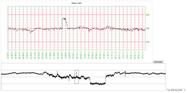

Resulting from another project, I have data of the mains voltage measured
at the wall outlet at my office where I work.
This is 240V AC single phase. We have a 50 or 100A 3 phase feed coming into the factory.
Which phase this is I can not tell you and it would not make any sense.
I record the voltage every 2 seconds.
Data exists for November 2018
I find it surprising how much variation there is minute by minute and day by day.
Some days there is little disturbance from 240V
Other days it's madness.
I thought we might we interested to see what voltages you get from
a "normal" 240V outlet.
It makes you wonder how important it is to set our inverter's AC output voltage.
The web page takes about 17 seconds to load, so please give it time.
this is last Tuesday's data
drag the lower small rectangle to chose the zoomed in upper data view.
Just choose a different date from the drop down list.

That is a good example of grid voltage fluctuations
some time back before we went offgrid we where getting nasty voltage spikes and over/under voltage 275vac to 160vac and possibly further out than that. (wont fit on your data sheet), this went on day after day for nearly a week.
The voltage would build up higher towards midday then blackout then come back on a bit later at low voltage then sag some more.
Must have been hell for the grid tie inverters, likely they cut out with all this going on.
some appliances blew up, lights and a tv other people had compressors and fans that would not start or run properly.
The fridge and freezer were making horrible groaning sounds trying to keep running, ended up starting the Genny up and running the house off that all afternoon just to keep everything happy.
Apparently there was some problems at the local substation.
And don't get me started on lightning and power lines.
Glad I'm off the grid, and away from all that.
These off grid inverters, I reckon you could draw pretty straight line for the voltage output and frequency.
No blackouts (at least very rare) except for some user intervention, no more blown up appliances and seldom use the generator now, it used to get a lot when we had the grid connection
Got to love these inverters.
The old generator we have would make an interesting graph, with some voltage and frequency drop, we mostly run it up to full load when charging batteries and running the house and other things at the same time.

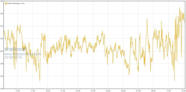

This a typical day on the mid north coast NSW. Sometimes it ranges from 236 to 262, but in general stays in the mid 240's to high 250's.
A little while back a local had their TV soundbar go on fire, presumably from over voltage in this area.

Ever measure the approximate source resistance at that wall outlet?
Any big (heavy electrical load) machines at your factory that may kick on and off either completely or partially?
I may get around to measuring my residential mains regulation in the US, but will measure effectively at the service entrance, thus eliminate fluctuations caused by wiring resistance between service entrance and the wall outlets. I think I'll also use just stepped down rectified voltage with 10 bit resolution and full span sampling (no offset).
Your location does experience greater percentage variation than my home voltage for sure.

No, and I have no idea how I would. Can you tell how one would go about this,
assuming I want to do it and don't. Too dangerous.
The short term fluctuations are likely due to "local" load changes.
objects within the building switching on or off, and objects in nearby buildings, including objects that are sharing the same 415V 3 phase trunk but are located streets
away. All these can impact the local voltage.
My other project aims to get an idea of long term voltage movements due to small scale solar array feed in.
