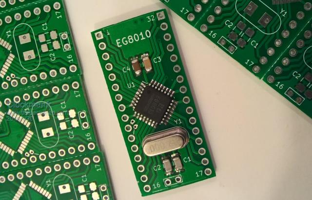

I will also talk about 'Gaspo's' shoot through work, see photo, and other contributors.
