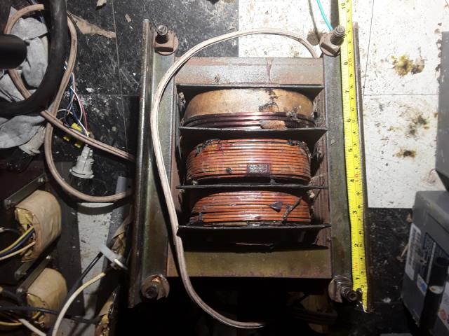

Posted: 03:40am 26 Feb 2019
Would this Transformer be good for a inverter project
it is very heavy
I tested the no load current on it it was 0.05
I tested it with volt metter clamp with no load on secondary
you can leave it plugged in for days and it won't even warm up a little bit
Would anybody have a guess to how many watts it may be
the two to the left are 3000 va together out of smart apc ups are thay good for inverter
I would appreciate any and all feedback on this subject thanks everybody Edited by BenandAmber 2019-02-27
azhaque
Joined: 21/02/2017
Location: Pakistan
Posts: 131
Posted: 07:18am 26 Feb 2019

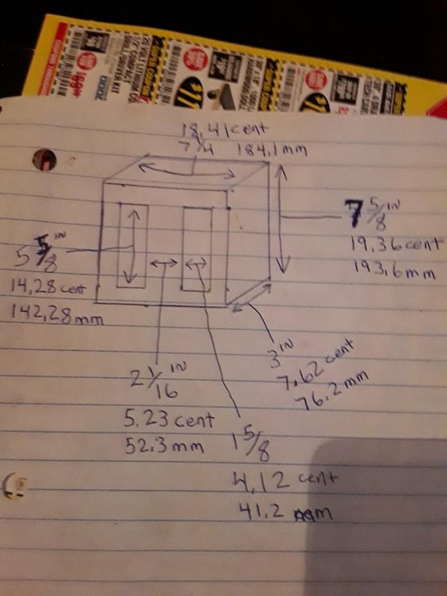

BenandAmber,
The transfo looks a little beat up with possible shorted turns.
To determine the usefulness of this for an inverter, please measure the physical size of the core, particularly its center leg plus the size of the stack, for an E-I or E-E core.
I have an Excel sheet in another thread on this forum which helps to calculate the parameters of the transfo, by putting in the physical data in the Excel sheet's designated cells. If you don't have a PC, just copy the data here and we can do the calculation.

Posted: 10:09pm 26 Feb 2019
This is the Transformer I'm trying to figure out the wattage
Or what the core is capable of
Thank you for your time

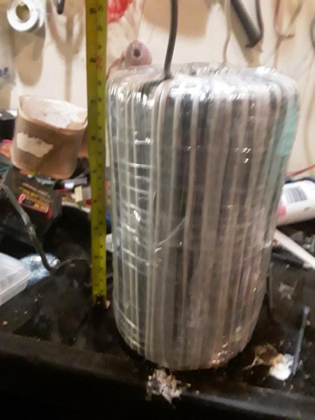

BenandAmber
Joined: 16/02/2019
Posts: 961
Posted: 10:47pm 26 Feb 2019
This is a Transformer Amber was working on
the question here is
She stacked for Transformer cores together and bonded them with epoxy
the four Transformers cores where 250 VA a piece
by stacking them this tall will it hurt the performance of these Transformers
if so how
second question is do you add the 250 v a four times to come up with the new VA
or will it be different
we have both research this and can't get no answers
we found other people asking the same question but no answer
thanks for your time I really appreciate itEdited by BenandAmber 2019-02-28

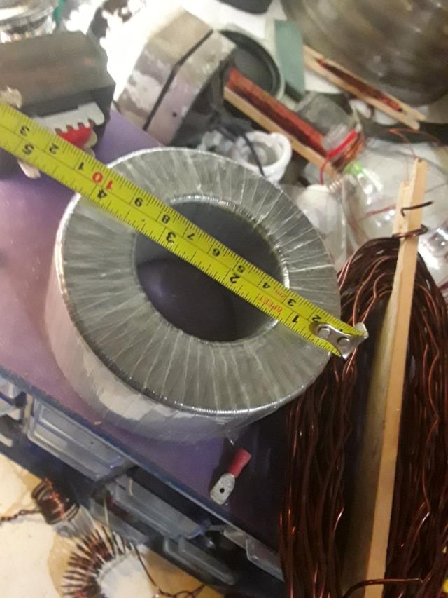

BenandAmber
Joined: 16/02/2019
Posts: 961
Posted: 11:02pm 26 Feb 2019
This is like the transformer cores she stacked together
They are made up of incredibly thin layers
Sorry guys I still haven't figured out how to put two pictures together on the same post
I would like to finish winding this Transformer for the little Chinese eBay board
I am debating between this one
the square one above
or maybe some smart Apc UPS Square Transformers I have I think the toroid might be the most efficient
If you have an opinion on this please let me know I would appreciate all opinions
Thank you for your timeEdited by BenandAmber 2019-02-28

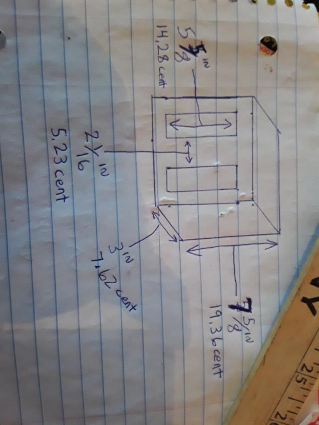

BenandAmber
Joined: 16/02/2019
Posts: 961
Posted: 03:38am 27 Feb 2019
I left out one of the window measurements in the first pick
I've been searching all over the internet I can't make heads nor tails of how calculate this va
If anyone knows of a tutorial or something I can read somewhere that simple for someone like me to understand
I would really appreciate it
I know the width times the depth equals core area or something but that don't give me VA
Thanks for your timeEdited by BenandAmber 2019-02-28
tinyt
Joined: 12/11/2017
Posts: 564
Posted: 04:48am 27 Feb 2019
Found this transformer tutorial with spreadsheet calculator
Tried your transformer width and stack height, it gave me a VA of 871 at 60 Hz. I don't know if it is accurate. Not yet finished reading it.Edited by tinyt 2019-02-28
