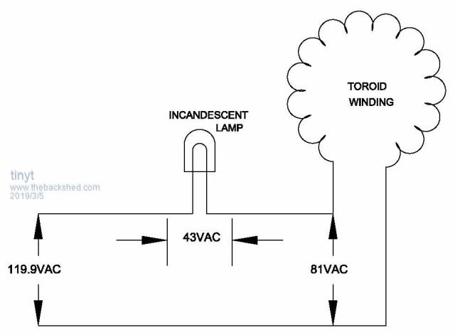

Posts: 961
Posted: 08:37pm 03 Mar 2019
119.9 main wall outlet
81 volts after light bulb
43 across the light bulb

  BenandAmber said   119.9 main wall outlet
I'm trying to figure out volts per turn
The way I understand the above, the connection looks like this. Lamp wattage is not given. I don't know which winding is connected. It should be the one with the higher number of turns for this test.
And there is no load on the other winding. For an efficient transformer, the voltage across the lamp should be low and almost all of the 120vac should be across the transformer winding being tested.

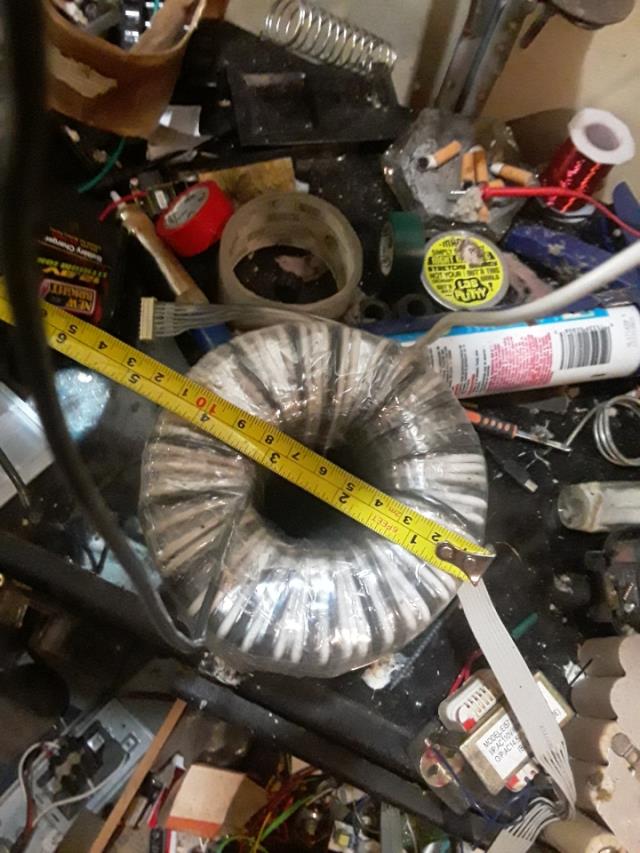

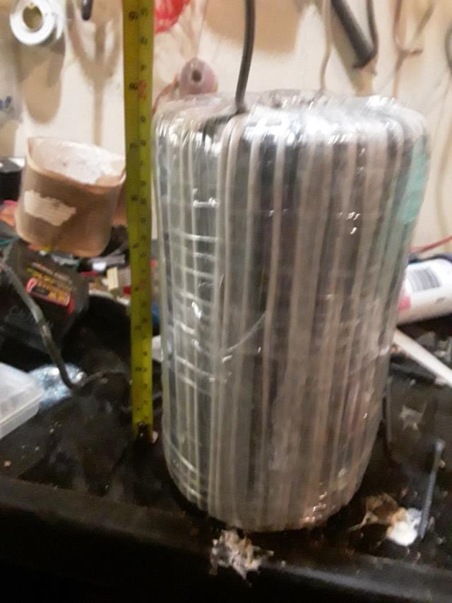

Based on the pictures, the toroid is roughly 4 inches OD and 2 inches ID and the toroid core stack is 7 inches (177.8mm). The toroid core ring width is roughly (4-2)/2 = 1 inch (25.4mm).
So the toroid core cross section is 25.4 x 177.8 = 4516mm sq.(roughly)
Using the magic number of 2800 (for 50Hz) in Clockman's guide, the volts/turn(?) ratio is 4516/2800 = 1.6128. So, for the 120vac winding, the number of turns is 75 (for 50Hz). I think we can just use the ratio 5/6 to get 75*5/6 = 63 turns for 60 Hz.

core size OD 101.6mm ID 50.8mm, HT 177.8mm
core area 4516cm2
Flux density : 0.875 T @ 60Hz
Primary : 114 turns (1.053V/turn) - 120V input
Secondary : 22 Turns - 23.16V output
You need closer to 30 turns for 32V
I think... 1st edit..Edited by ltopower 2019-03-17
