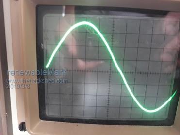

I got the chips from Mad that he has been running.
This is it with full power but no caps.
No wobble with the voltage like the others.
Will fit the big caps and re test.
Very frustrating that your success is dependant on quality control from unknown sources.
I still can't see the difference in the signals coming from the 2010 test points, there has to be something.

I don't think it's the EG8010 chip provenance.
I suspect there is a problem elsewhere, probably the gate drive ICs or the system power supply.
You want to come over with the control board and we verify it's all good?
This weekend I'm making some beer so I am home.
We could make some adapter to drive the badly abused victim test inverter on my bench
with your driver board. Things might become clear when we do this.
