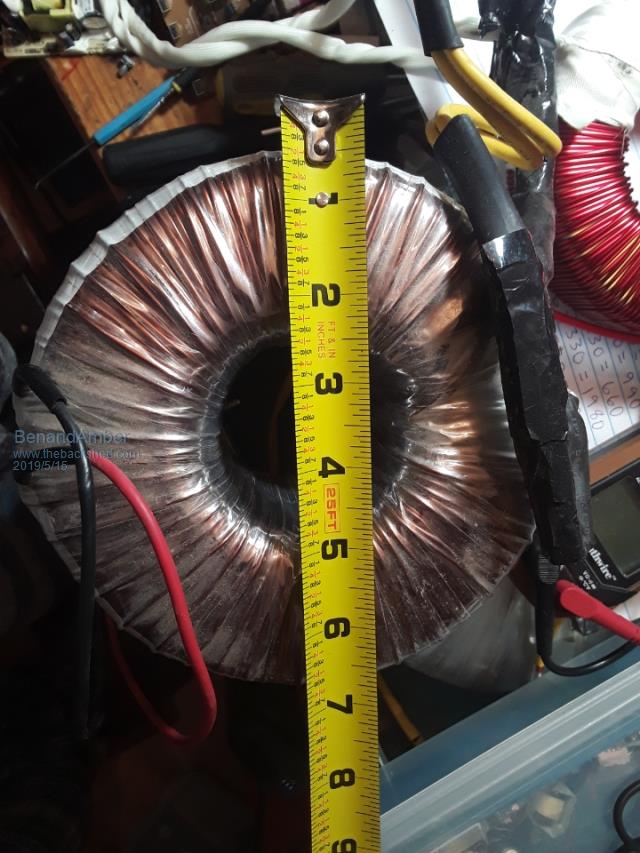

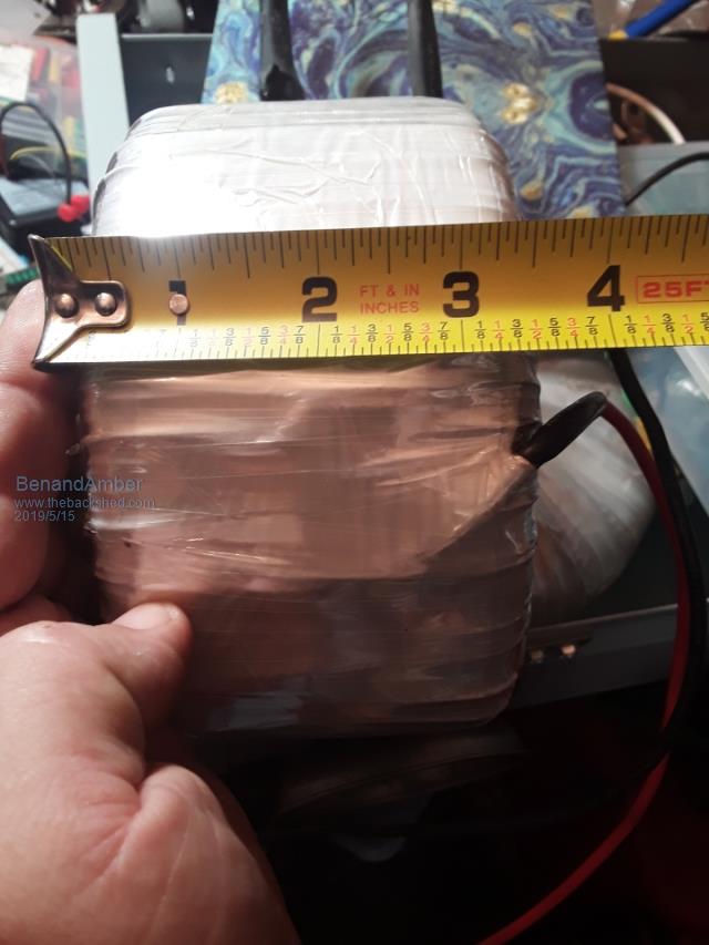

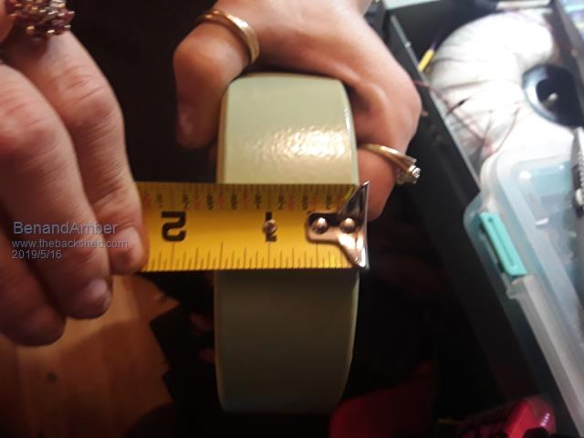

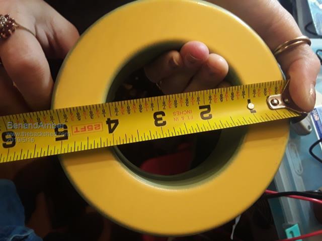

would this Transformer be good 4 a
warpspeed inverter
It came out of Amber's 8000 Watt 230 volt Power jack inverter
And if so which one of the three Transformers that a warp speed inverter uses
would it be good for and how many wattsEdited by BenandAmber 2019-05-16
Posted: 10:45pm 14 May 2019
Very difficult to judge.
You would need to strip off all the wire and measure up the bare core.
From that you can then calculate the required number of turns on both the primary and the secondary.
Then its a case of working out what wire sizes will actually fit onto that core while still being able to reach the required number of turns.
Trying to guess all of that from just a picture is not really possible.

Posted: 12:44am 15 May 2019
The core itself does not really have a direct power rating.
Power rating only refers to the allowable maximum "safe" temperature rise, and its the wire that gets hot, not the core.
How you decide to use that core will determine the final continuous power capability, and thermal mass will pretty much set the surge limit, assuming your mosfets or something else does not blow up first.
Its fun to speculate, but it really comes down to measuring it all up and deciding what is practical as far as the number of turns required, and the wire sizes that will actually fit through the available hole size.
There is no simple one step formula to tie all these variables together. Its an iterative process where you try a whole lot of different combinations, juggle the figures around, to try and reach something you feel is practical to finally build.
I can only suggest that you base your design on 1.0 Tesla (10,000 Gauss) flux density in the core, and 4 amps per mm squared current density in the wire, or figures reasonably close to those.
Those figures will tell you the number of turns and the required wire sizes. If it will fit onto the core, fine.
If not you will need to change something until it will fit.
Its no good showing me a picture of some transformer and asking me will this handle xxx watts ? I have absolutely no idea.

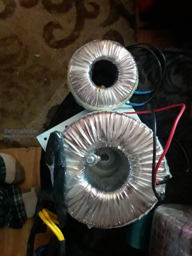

Ben, I have here a 1KVA rated toroid which looks of a similar size than the one you pictured.
I will be using it for #4 (the smallest) toroid, simply because the hole is too small to feed a lot of turns through, as required with the other, bigger voltage, toroids.
For your #1 (biggest) toroid look for something that has a 3.5" hole left when all the wires are removed if you want something capable of a few KW.
I would suggest you put the building a warpinverter plan on the shelf for a while and cut your teeth with building a decent size single toroid inverter from *scratch*, that means no pre assembled Chinese kit boards.
By the time you got that running with no blow ups you learned enough about toroids and how to rate them to proceed to a warp inverter - which is a much more complex beast with its 4 toroids to calculate windings for.

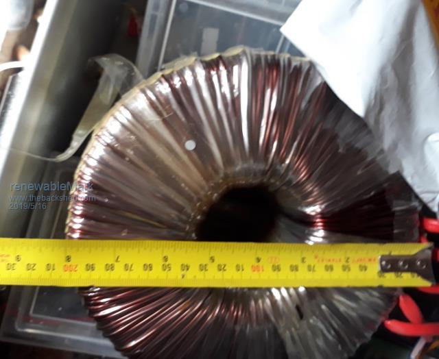

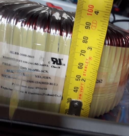

Looks like a decent size Ben.
Here are some pics of a fully wound 3kw aerosharp 240v for size reference.
Like Tony said it will depend on stripping it, doing calculations and rewinding it to know exactly what you have.
Looks like a reasonable size and there is still a 2.5 inch hole in the centre on yours.

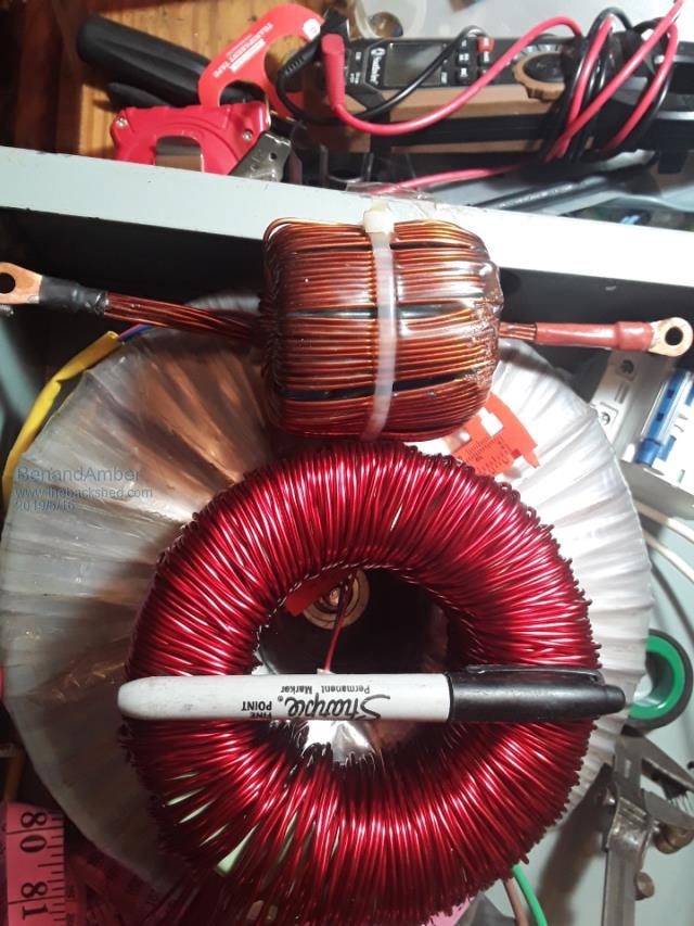

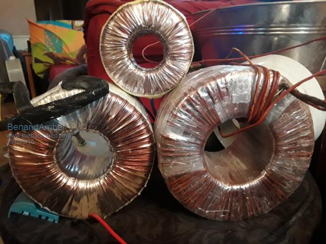

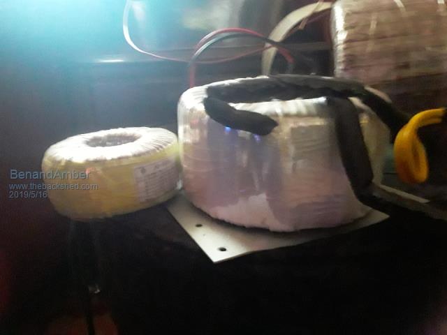

The Transformer on the left is the Transformer out of the 8000 watt power Jack
the Transformer on the right is the one I'm in the process of winding
it will be replacing the one that's on the left and be put back into the Power Jack
it only has 44 turns on it so far and it will have 100 to 110 turns when done
it's the one I made from a bunch of little ones
the one on the top is almost identical to the ones I tore apart to make the big one

It came full of goodies we now use it for a giant candy and snack dish for all the neighborhood kidsEdited by BenandAmber 2019-05-17
Posted: 11:48pm 15 May 2019
Yes its complicated.
And its why when you ask what can a particular transformer do, nobody is going to be able to be able to give an exact answer from just a picture.
If you are serious, strip it down to the bare core, measure it all up, and THEN ask the question.

Did nobody see those ginormous ferrite choke
I got worried that the wire wasn't big enough on the original one I made for my 10000 watt inverter board
The little one in this pic is the first one I made it has 10 2 mm wires as one
The big one has 16 in hand or whatever you call it made in one
I hope that wires big enough I don't know how to do pie squared so 2mm is just the single measurement
And it's round wire
The Transformers wires are still way bigger yeah it has two 2awg wires in hand
So four all together for the low side of the Transformer
I am hoping to get 4 to 5000 watt continuous
Even though I probably won't be using over 1500 watts most the timeEdited by BenandAmber 2019-05-18
