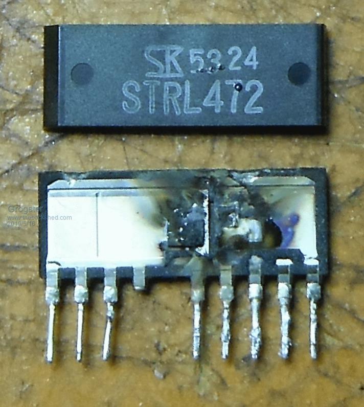

My Toshiba heat-pump went bang the other week, and I have not been able to use it since. As we are heading into winter, I needed to get this fixed, so I pulled the indoor unit to bits, removed the main-board, and found a STR-L472 Switchmode controller IC blown in half.
That would explain why the indoor unit is dead, and will not start.

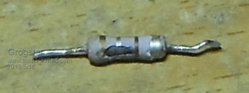

I have also found an o/c half-watt or so 0.91R 5% resistor - R12 between pins 6 and 10 of IC1. I will replace this resistor too, naturally.
When the heat-pump went bang, there was no apparent surge or anything, as I was using other things in the room at the time. It was working happily, then just made a loud crack noise - which I knew was not a good thing - and then never worked since. But my HT amp and computer in the same room kept on going no problems, so I am reasonably confident it was not a surge or spike that killed it, more likely that IC01 just failed. It probably runs hot like most of those chips tend to do. R12 may have gone o/c first, killing IC01 in the process, as R12 is actually cracked. Generally, carbon resistors take quite a bit of killing.
This tests as o/c, which is not good.

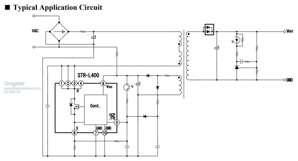

EDIT: Here is the basic PSU schematic from the 472 PDF:
Although no parts are labelled here, you can see that R12 between pins 6 and 10, is what appears to be a little current-limiting resistor on the source of the internal MOSFET driver for the hot side.

The killing probably went like this. The FET died & shorted. Excess current went via pin 6 to ground (R12) went ouch and open circuited. The next path for the current was the resistor between 6 & 9 - or internally sourcing from pins 8 & 9 hence all the components being suspect. The output capacitor or rectifier diode are the most likely culprits that may be faulty and caused the bang or maybe the STRL400 just got bored...
Those dull grey resistors that look like the one in your picture are usually wire wound and have a flame retardant coating. I would not use the carbon one as it will probably fail quickly. By all means use a smallish 1R WW (~1W) and trim it to 0.91R value with a 10R carbon film in parallel. Replace the opto-coupler, if the TL431 (output side reference) is faulty it will be the first one in the many thousands I have used and serviced! BTW the 1R would probably work fine without being trimmed, some engineers like exact values....Edited by wiseguy 2019-05-17

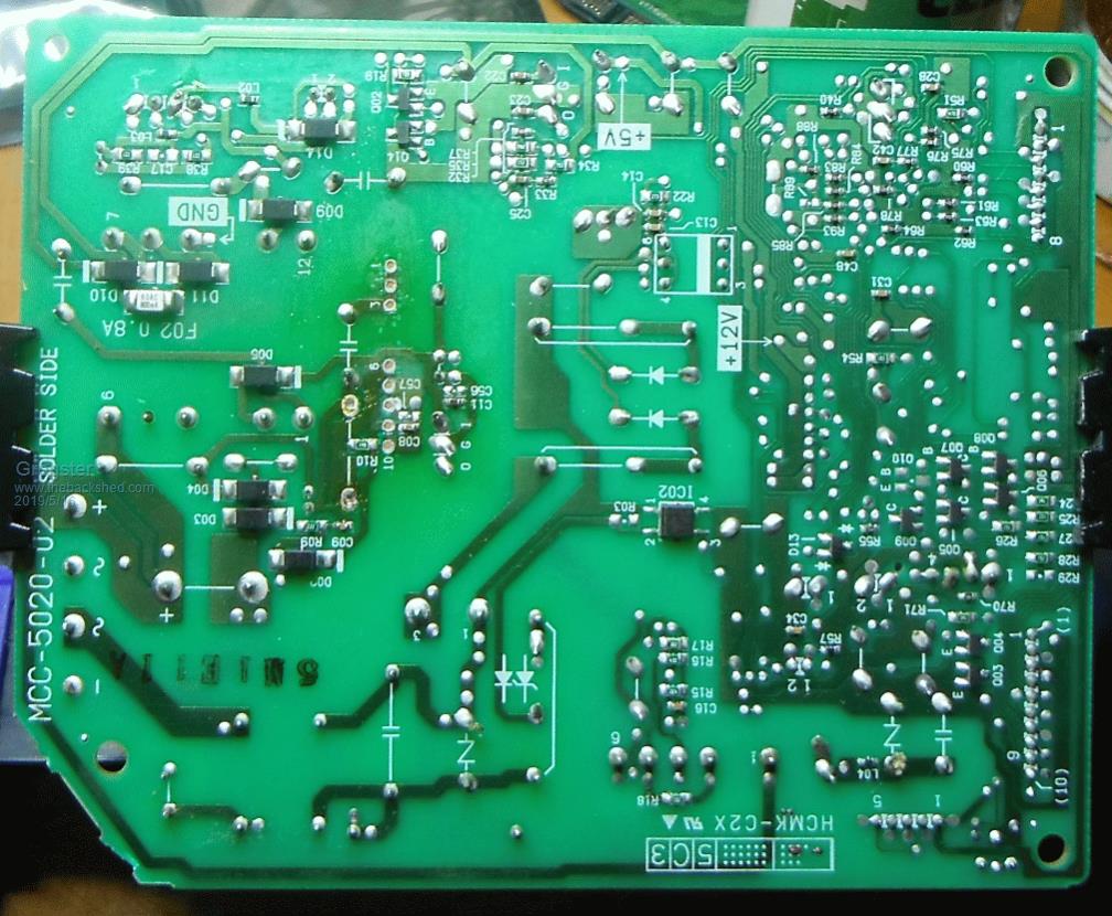

Just FYI, here are two shots of the main-board from the indoor unit:
Does this board look familiar?
EDIT: Note the discolouration around IC01 that blew itself to bits. This suggests that at least at SOME point in its service life, it was running hot.Edited by Grogster 2019-05-17

No not totally familiar - its one of many similar units though.
Just edited my post - thanks for the picture - I hope you sort it out !
Check F02 is still intact and all those SMD diodes too. What is IC08 - is that the opto ??Edited by wiseguy 2019-05-17

F02 is still intact. All diodes test as OK, although in the reverse-biased condition, there is still a reading as the test current is going back via the HF transformer to the other side of things and providing a circuit. I am happy enough that they are OK though without removing them entirely to test them out of circuit.
I have ordered 4x 472 IC's with DHL from AliExpress, so that if I explode another one, I will have some spare ones. I intend to follow the Toshiba service manual and power the board with everything except the front panel disconnected, to see if it blinks at me(the LED) on power up, which would suggest it is reasonably happy again, before final reassembly. Also allows me to test a few voltages as labelled on the board.
IC08 is a 7815 voltage regulator.
