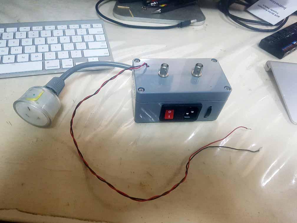

I applied 240V AC STREET power to a unit via the voltage and current sensor box
I built ages ago.
(power factor and Watts measured with a very good power meter -  Power Mate)

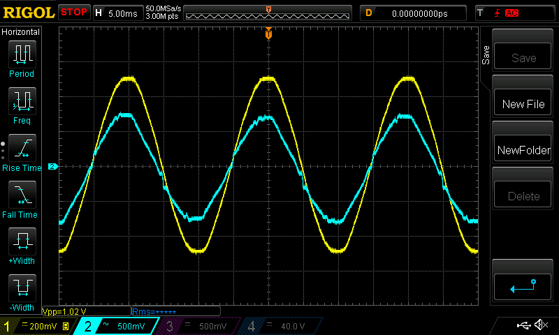

Yellow is street voltage
Light Blue is current.
4W on standby
as the compressor starts up, more and more power is drawn.
We see this shape only for 10 seconds or so.

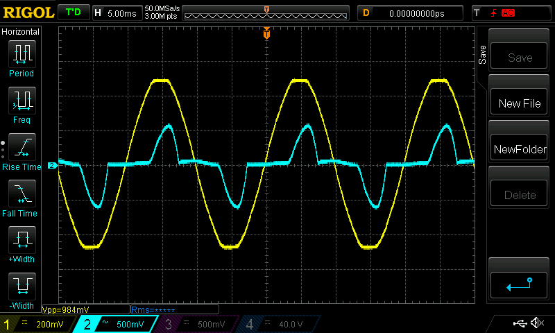

500W:
860W
PF is 0.910

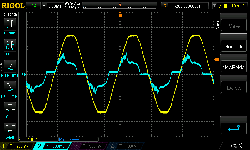

922W (241V, 4.2A)
PF is 0.92

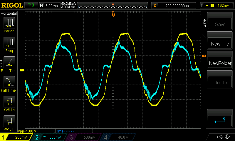

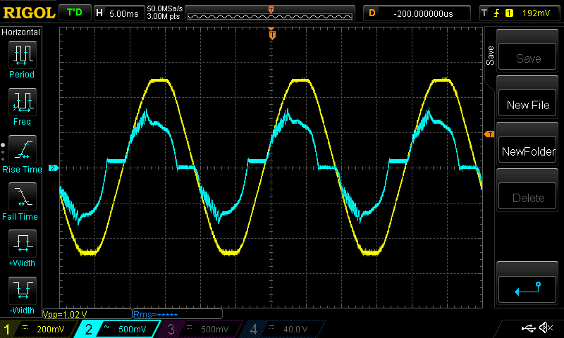

Next I hooked it up to the 3kW home built inverter.
The AC was running near flat out heating the room.
1171W
1282VA
PF is 0.92
Notice the distorted AC voltage waveform. It seems to me the inverter is supplying
a fairly stiff (low impedence) current to the load. OF course the street supply
is very stiff and can handle large non-linear loads and keep looking good.
But I think the inverter can dive at least one of these A/C units with capacity to spare.

Most of these inverter AC's are 3 Phase motors with their own own single to 3 phase inverter built in. This is because the compressors are variable speed to suit the load.
Some of the distortions may be from the inbuilt inverter itself.
I guess they are only as good ( and cheap) as they need to be.

Ahahahahahahahahaha, not many of us have looked at the wave when AC is run on an off grid unit.
That looks pretty good actually, my unit is a lot bigger and stuffed the wave more than that.
On flat out and eco setting it was ok though.

I would say all modern inverter type ACs use the single to 3 phase design.
Speed control of the compressor is the main requirement and it is best met
with a 3 phase motor and (probably) a vector drive.
The compressor is where most of the power is consumed so that is where
most efficiency gains can be found.

Poida, Do you have any details on the voltage/current sensor box?

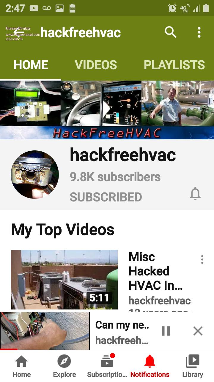

There is a guy on youtube that runs a  3 phase split ac outside unit with straight solar panels no battery no inverter
He uses a vfd that has dc input
I can find the name if anyone is interested
Thanks for sharing  info on these split units
It seems to be the future of off grid ac
These 3 phase out side units can be found cheap some times and do have the benefit of changing the speed of compressor

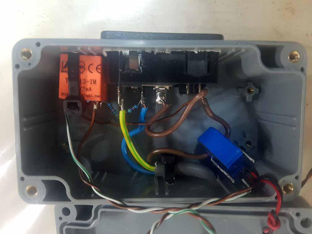

yup.
I use a LEM current sensor for current, so it needs an external 5V supply.
The AC voltage comes from a voltage transformer ripped out of
an Aerosharp.
Both outputs are isolated, well in excess of 2kV.
The IEC input jack has a 10 Amp fuse.
I use an IEC lead to supply it and hook up the load to the 3 pin socket.
It's really accurate and has good frequency response.
Posted: 08:33am 18 Aug 2020
A very handy gadget to have Peter.
Pretty easy to make too.

What are the resistors in series with the transformer doing?

It's to reduce the current to the required value.
The device is limited to 2mA input.
voltage transformer PCB K1080274588.pdf
I forget what I chose, I suppose I aimed for 1V p/p output or something like that.

It looks like maybe a 100K and 47K resistor in series with the primary of the voltage transformer, 240V yields ~ 1.63mA well within the 2.0mA maximum.
The manufacturer specifies a maximum load of 250R - so with a 2.0mA maximum the highest achievable secondary voltage would be 0.5V.
With the above 1.63mA and a 150R secondary termination would yield ~0.24V or 1000:1 @ less than 2% error.
Whilst a higher secondary resistor may still work, the linearity/accuracy/phase shift etc must get compromised.
If you had a spare 240V to 5V little isolated converter handy you could power up the current sensor internally, removing the need for the external power supply.
I like the simple project a lot, instead of setting up each time for independent current and voltage measurements and phasing them correctly its all set up and ready in a flash.
Ok maybe not the best description for a mains device....... do take care!

Peter, with the second test you did was that A/C unit run from your inverter with it's DC input supplied by the EI trans and the eltek?

The second test used the home inverter.
3kW toroid, Madness 6kW powerboard, nanoverter.
During that test other loads on the inverter were present
such as the iMac computer, the electronics bench equipment, many devices
on standby, desk lamps etc.
