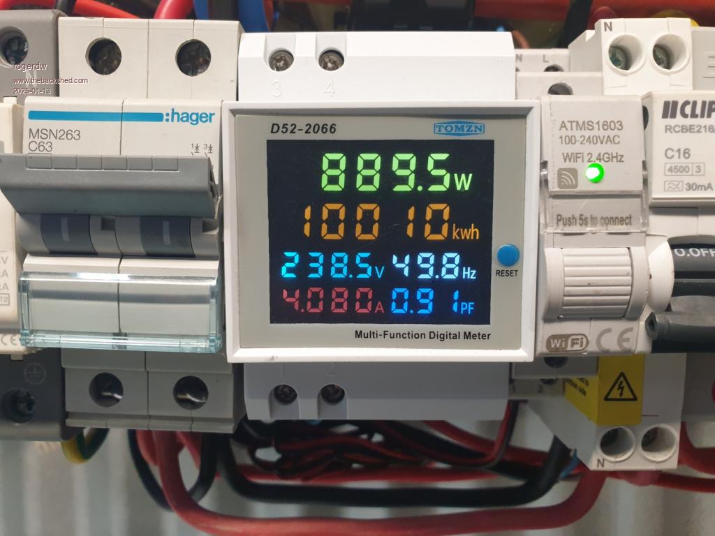

I haven't posted for a while so thought I'd do an update.
I'm not hammering the Warpverter so much over summer  ...  biggest loads are probably the pool pump and the pool heater pump for lots of hours.
It just ticked over the 10,000kWh mark yesterday  ...  just over 10 months since installation.
At ~50c/kWh, that's $5,000 of free power so far. It's a wonderful feeling.

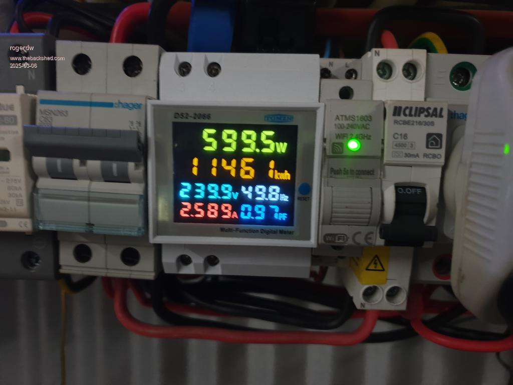

It's celebration time  …  the Warpverter installation is officially one year old today and has clocked up 11,461 kWh of generation so far.
It's all going really well and I have also made some improvements over the last week.
Anyone who's been following Tony's design from way back may remember that the Warpverter doesn't have a voltage feedback control  ...  but that it uses voltage feed forward.
It monitors the DC and if it sees a sudden change in voltage due to more or less load  ...  it knows to compensate immediately. And this all works far quicker than a feedback system which is relying on watching the AC output.
Anyway, in the early days it was found that heavy loads could still cause the AC output to sag  ...  and with mine, at over 10kW, it might drop nearly 10 volts.
I never really worried about it as the only time I ever noticed it was when the fan was on in the ensuite and if turning on the hot tap  ...  which brings on the pressure pump plus the under sink water heater (4,500 watts or so)  ...  then the fan speed would drop noticeably.
It was so noticeable that I checked it early on  ...  but found it was only about a 4-5v drop.
Some early builders had tried Tony's suggestion of an additional Current Feed Forward control and found it successful. I was always going to mod mine to try it as well  …  but Tony recently redesigned the control board to accommodate the additional three components  …  so I built one up too. See more detail on the Warpverter website .
After a bit of tweaking, I’ve found that even up to around 10kW of load  …  the output stays within around a two volt range. I have a bit more experimenting to do, but it has been amazing.
Every time I go in the ensuite now, I turn on the fan to see if the hot water will change the speed  …  but there’s no change noticeable!
I found a post from wayback where Tony describes both voltage and current feed forward operation  …  here
