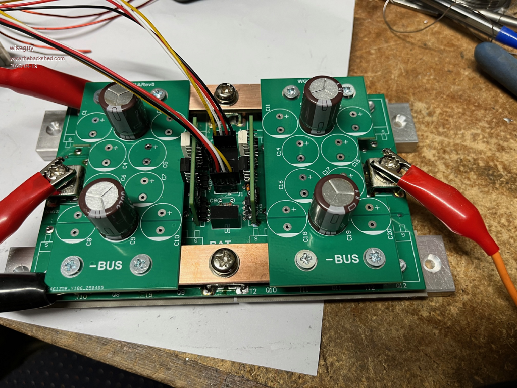

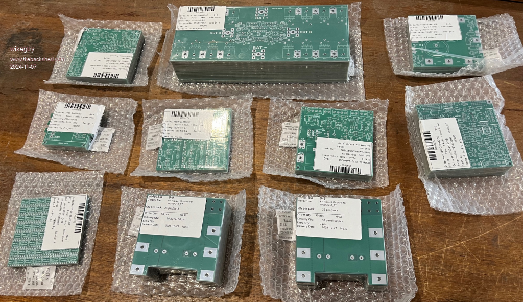

I need to generate all the Gerber and NC drill files and then check them. Should be able to do it in the next day or so. If you pm me your email I'll send them to you.
Just a thought, the Cap boards are probably overkill in 2oz, I think 1oz would be fine in the application.  Why not get a quote in 1oz and 2oz for the Cap PCBs and see the difference, maybe spread out on a larger quantity there won't be such a penalty for the 2oz.
The revised power PCBs should be a tad cheaper but now you need the 2 little half bridge boards (in 1 oz) per power PCB. The capacitor PCBs although modified are probably the same price as before and there are no changes to the Nano controller PCB.
Cheers Mike
