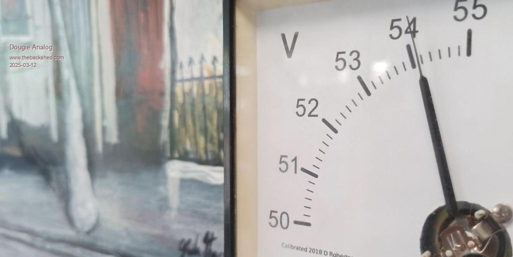

Quick and dirty in home indication of battery condition.

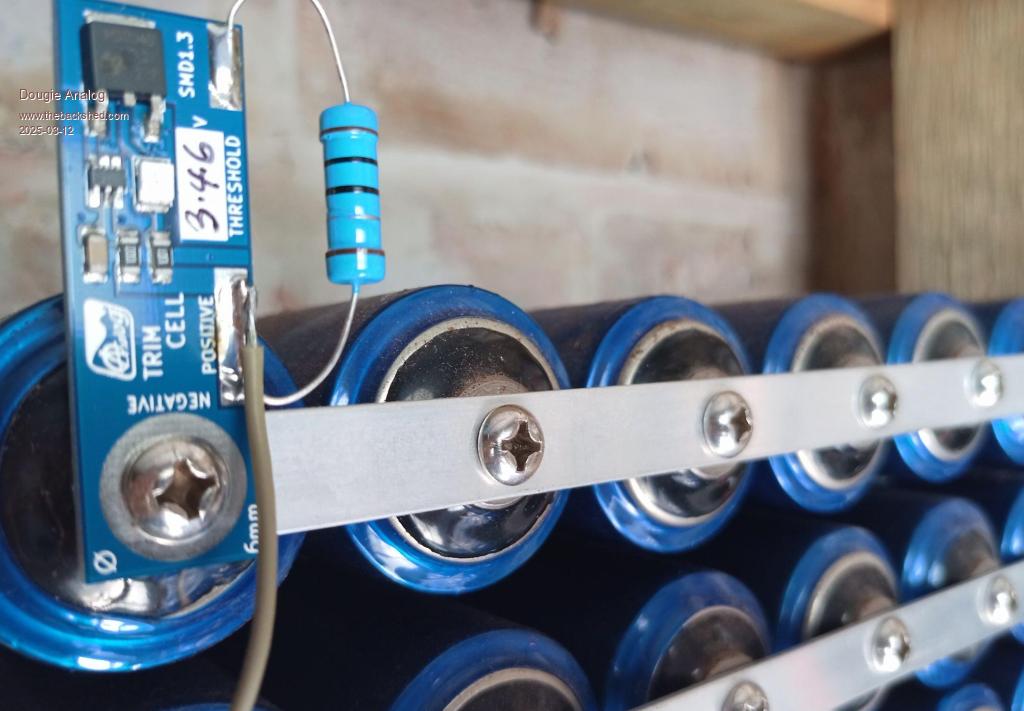

Original battery LIFEPO4 with Headway 10Ah cells 32p 16s

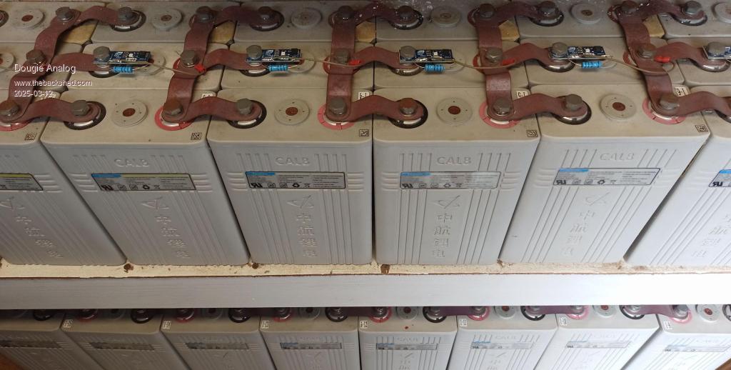

2nd battery LIFEPO4 with CALB 100Ah cells 3p 16s

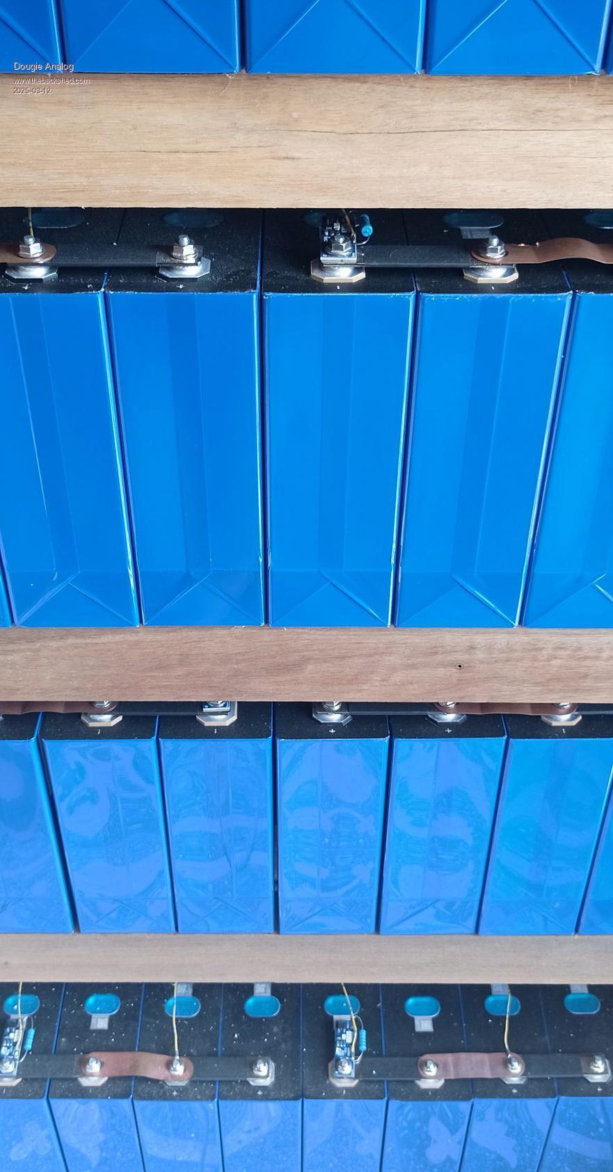

3rd battery LIFEPO4 with EVE 280Ah cells 1p 16s
4th battery LIFEPO4 with EVE 300Ah cells 2p 16s

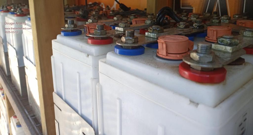

5th battery Ni-Cd with Saft 195Ah cells 2p 35s

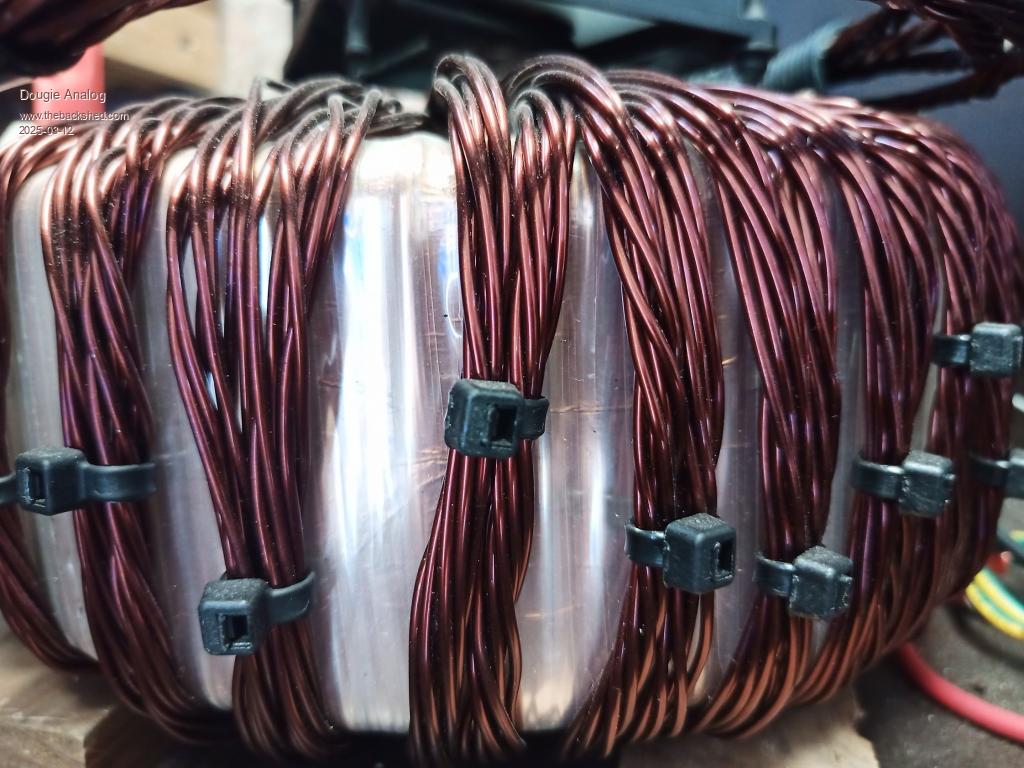

Failed basket weaving however this one works great!

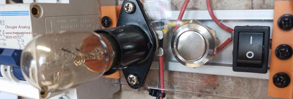

A visual indication when pre-charging the inverter's capacitors. No breaker splat!

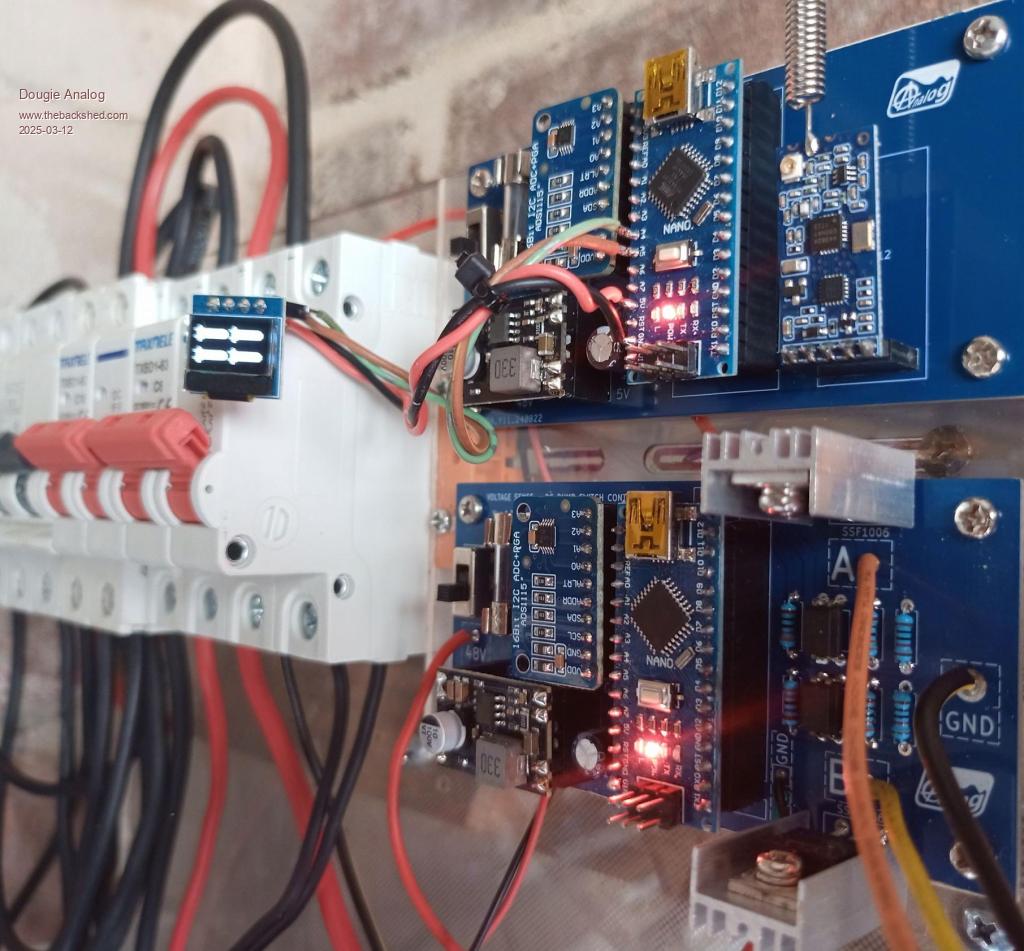

LIFEPO4 battery overflow - dump system.
When the main LIFEPO4 battery is at maximum voltage then this system dumps the excess energy.
The top module switches on HWS elements (I'm learning oled implementation. I will redo this with the oled screen mounted directly on the board. This is showing 4 hot water elements are on. Signal is sent via RF).
The bottom module switches on the dump to the Ni-Cd battery and when that is full it dumps to heat bars.

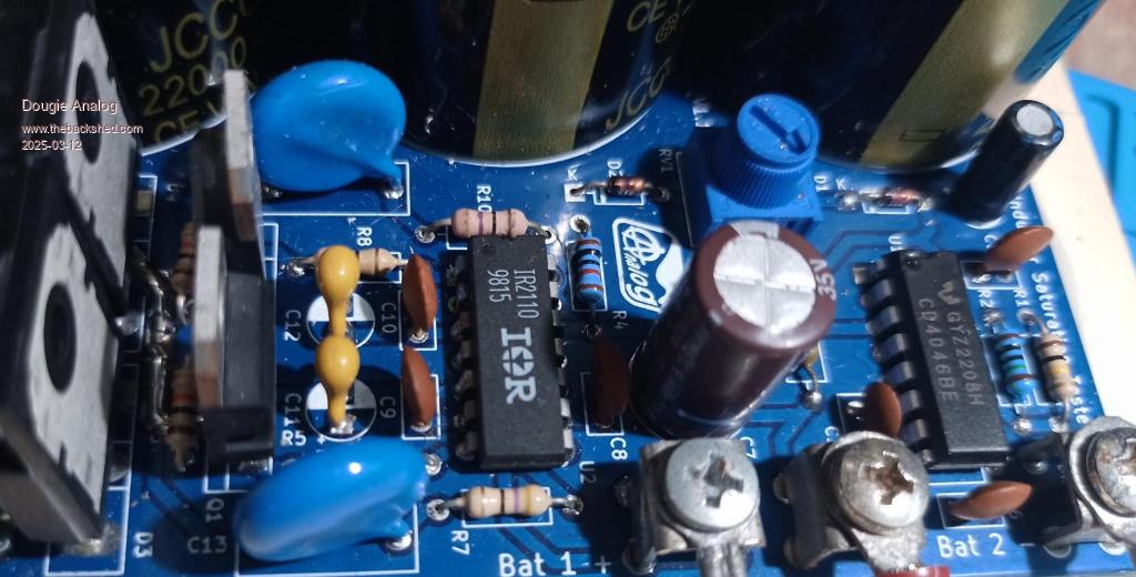

Choke saturation tester. No longer flying blind :)

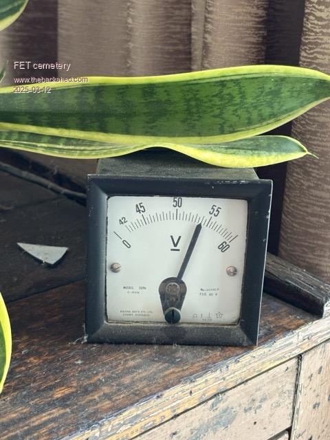

Right there with you on the quick and dirty in home battery condition indicator, and the incandescent globe as a visual indicator of capacitor charging!

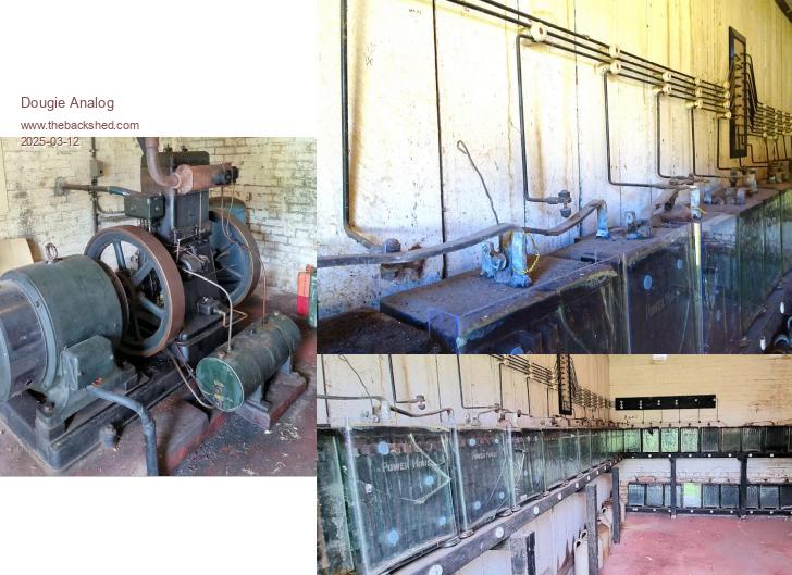

Somewhat related, but check this out!... extremely cool imho.
This installation was put together on a prominent farm house near me in 1927.
Housed in a sandstock brick barn.
This sowed the seed back 40 years ago when I first saw it.
These off grid cats have been around for a while ;)

There's nothing quite like a Bakelite ammeter to improve the look of a project...
Is that a 32V DC setup with Edison batteries?
I once saw an ancient working 240V DC generator at a clearing sale. Terrifying, but I guess safety standards were a bit different back then.

Love the old engine genset
1926 Lister XO, perhaps

Sweet setup Dougie. I am jealous, I would love to go off grid but i just don't have the space. Top tip - get rid of those pig-tail antennas and go for a full wave using a bit of single core telephone jumper wire for ***DRAMATIC*** improvement in range/quality of the link

I quite like analogue meters too, in fact I have some identical to the ones Fet cemetery showed, along with some matching ammeters. If I ever get to build covers for my gear I will mount some in as well.
The genset you showed is very similar to what I remember as a kid having on the farm. If the lights started to go dim while we were having tea, one of us would have to go down to the engine room and start up the generator. We were only little at the time  ...  maybe only 5 or 6  ...  and I vaguely recall the generator was used as a motor to start up the engine. There was a big knife switch involved somewhere too. Haha.
