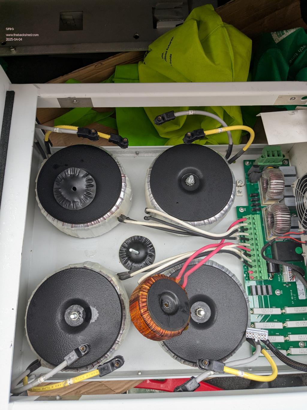

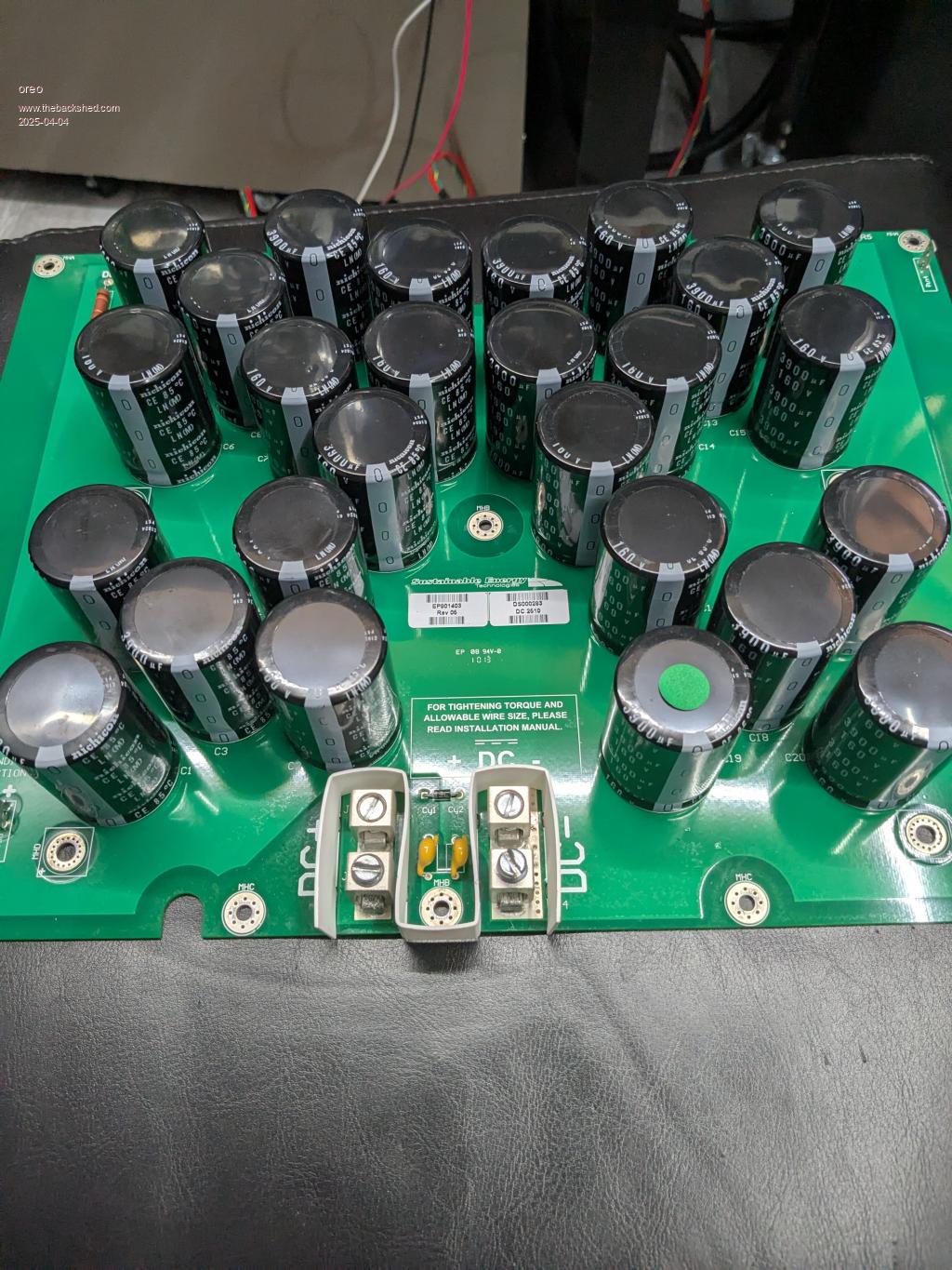

I am normally on the lookout for scrap inverters, but normally do not run into much around here (Canada).  Recently I saw a Tie grid inverter that looked interesting.
Looking up the specifications it's rating is:
MPPT input voltage 54-95VDC
208VAC 5kw continuous
63Kg weight,  10yr warranty standard, 20yr warranty optional
No one would want this, since residential supply here is 240v split phase not 208 and this inverter is 14yrs old.
It has a real low MPPT input voltage range, and since my battery is 72v nominal the transformers might actually work for me (not that I really needed more transformers, but anyway that's not the point right?).
So I got an good price and brought it home yesterday.

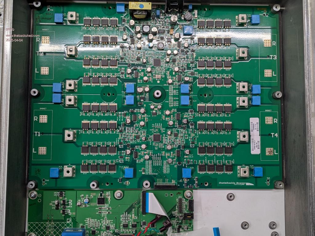

It has an all aluminum chassis and is made up of:
An input capacitor board with 25pcs of 3900uF 160v
A board with 4 inverter sections, each using 4 sets of 4 150v 180a mosfets.
And a transformer section with 4 toroid transformers and 2 1mH chokes and a filter board.

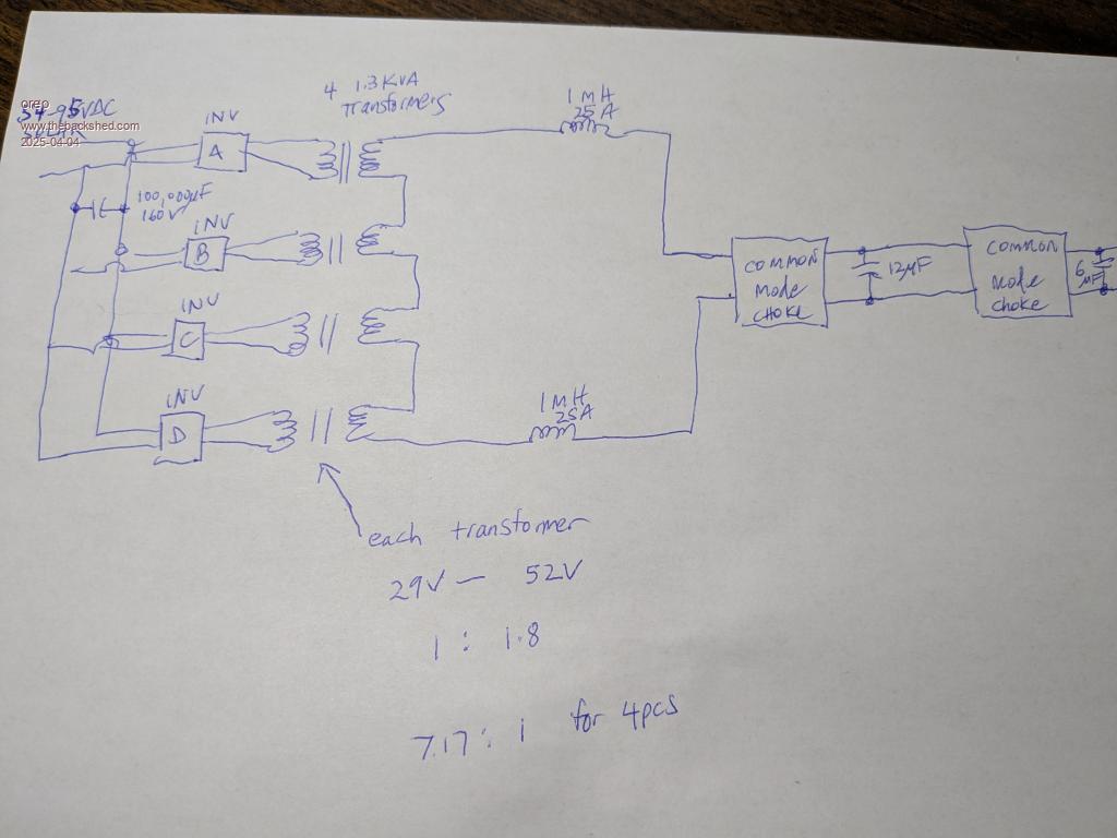

And now the interesting part (s).
1. There are 4 separate inverters (ok, maybe not that interesting)
2. The transformer outputs are connected in series (not parallel)
3. Between the inverter output FETs and the Transformers, there are no inductors!
I jotted down a block diagram/schematic.
So they put the inductors after the transformers but before the filter capacitors.
I have not see this before.
Maybe it only works with smaller power transformers IDK.
Thoughts?
Greg

Thanks for this post Greg it confirms my theory about this. I am aware that in our inverters with a primary choke, if the mains output capacitor is not used then there is almost no current draw from the source supply. Looking at the secondary voltage with a CRO under this condition reveals that the 19KHZ fundamental is passed through the toroid with minimal loss.
I had a discussion about a year ago with Tony/Poida/Roger? (cant remember now) about this exact theory and using a secondary choke is on my list to play with.  The ultimate reason was much thinner wire required, as current in the secondary is about 1/8 of the primary, but conversely the voltage is 8 times higher so more turns required, but luckily this is a squared law so not 8 times the number of turns required.
The inverter you have shown pictures of is the internals I saw recently from a large auction here where about 50+ inverters were sold for $50 each, Roger & I pulled one down to see the internals - the same as yours. But the transformers were not part of the inverter and were sold separately by the pallet. I remember commenting to Roger that the chokes (also sold separately) were way too high in value to be primary chokes, your post suppled the definitive answer!
So thanks for filling in the missing links, the inverters were not sold whole but as separate lots/components towards a complete inverter, if you knew what to do with them.  BTW I picked up a 12KW SolArk brand new for $301AUD at that auction, it is a hybrid type that uses nominal 48V, it has Auto changeover from Mains and it can throughput 12KW from the mains but supplies only 9KW from the battery/inverter. A real beast that can have a separate generator input and can also charge at over 100A

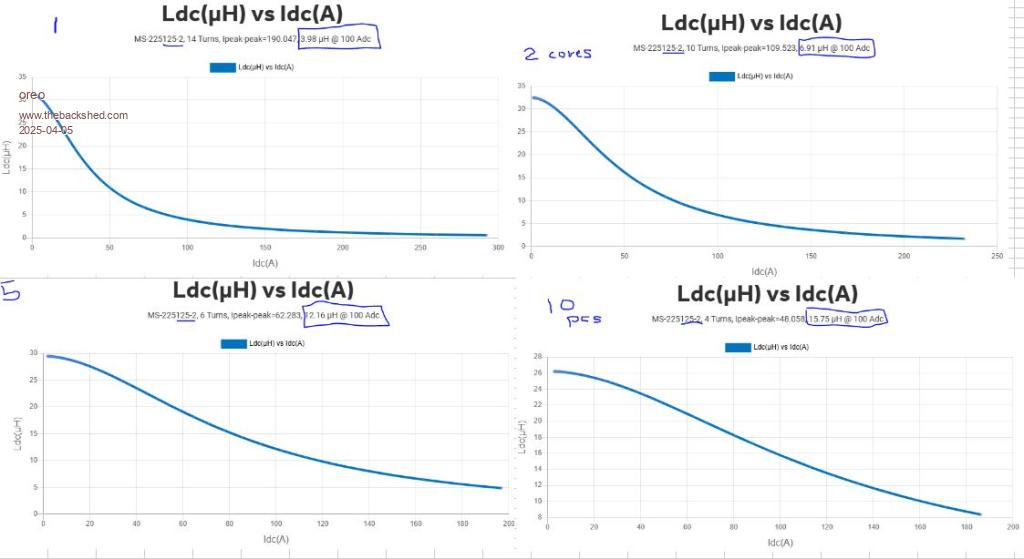

I understand your logic on the inductor position.
I threw one of the 1mH/25A inductors on my saturation tester, and it saturates pretty hard at 36amps.
Honestly, the inductor selection is a bit of a mystery for me right now.
After reading a lot on this forum, I see that over the years the design thinking on what the core should be has changed.
A number of years ago it was #1 and today it is #3.
1.  Gapped Amorphous Nanocrystalline cores (Aero-sharp) measured so they absolutely won't saturate while in operation.  (note I am guessing the makeup of these cores based on description)
2.  Gapped ferrite measured so they absolutely won't saturate while in operation.
3.  Sendust (Kool Mu) toroidal cores

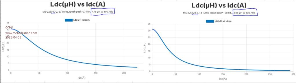

I have been using the Micrometals design tool, "Inductor Analyzer" to run simulations on multiple core sizes, materials (Iron powder and Sendust) and stacking, to see what the effects are.
I have built 3 different chokes using a 3 stack, a 4 stack and a 5 stack, and measured the inductance at different currents on my saturation tester and have found that the program mirrors what I am measuring in real life. (Eureka)
You probably already know this, but here are some of the results.
What happens when you use a core with 60 vs 125 permeability.
(You get more inductance per turn with the 125, but if both cores start at the same inductance, the 125 perm unit will have less inductance at 100 amps.
What happens to saturation when you stack cores and keep the same inductance.
(As you add cores, the saturation improvement becomes less.  With 1 core you have 4uH/core, with 2=3.5uH/Core, 5=2.5uH/core and 10=1.7uH per core)
If you are doing this with 40 permability cores, it gets worse.  With 1 core you
have 4uH/core, with 2=3.0uH/Core, 5=1.7uH/core and 10=1.2uH per core)
Note that after I ran these simulations, I realized I had the frequency set wrong.  Setting it correctly changed the ripple current, but not the inductance.  (less than 1% change)
Greg

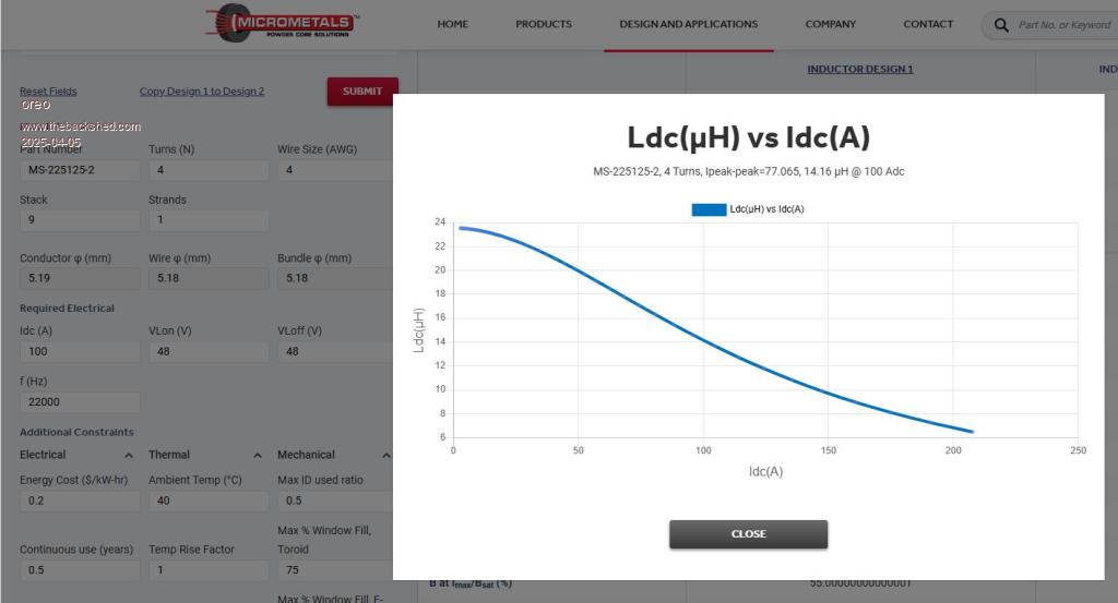

maybe that was a bit overboard, but anyway back on track now.
So if we look at Keepis build (also Mike?) we see he is using stacks of 9 pcs of A225125 cores (MS-225125-2 equivalent)
Here is what this looks like in "Inductor analyzer".
Now I understand that he has a mixture of cores being used, with some MS-226 sized cores which are 1mm larger in diameter and with a 10mm smaller ID, but largely these only measure slightly better than the above.
So Keepis is running his inverter with up to 400 peak amps.  At 200 amps he has about 7uH x2 =14uH.  At 400 amps he has about 5uH.  That is not much, and his system has been running like a top.
Any thoughts on why this is?
1.  Maybe full saturation is really bad, but near total saturation is ok?
2.  Maybe the new inverter design is so robust that having low inductance at high currents won't kill it?
3.  Maybe the toroid design used by Keepis is less inductor dependent? (I read that the amount of transformer coupling there is can affect inductor requirements, but am unsure if the way they are stacked results in less coupling or not)

  Quote  So Keepis is running his inverter with up to 400 peak amps.  At 200 amps he has about 7uH x2 =14uH.  At 400 amps he has about 5uH.  That is not much, and his system has been running like a top.
Along with the smaller Choke inductance at high currents, the lenght of each choke winding combined with using slightly smaller gauge cable.
This results in an additional small resistive loss at normal running loads, but one that really comes into play under very high current short duration events, thus helping the FETS survive switching into the extremely low impedance Toroid primary.
I may have to do some measurements on my test setup and try secondary chokes and a filter. I'm sure if Wiseguy gets the time he likely will do the same, just need to find the time.
BTW with the dual inverter load currents are halved, 400A with two power stages each stage with two chokes and each handling 200A.
EDIT:
  Quote  Maybe the toroid design used by Keepis is less inductor dependent? (I read that the amount of transformer coupling there is can affect inductor requirements, but am unsure if the way they are stacked results in less coupling or not)
There is no coupling and the choke works exactly the same on a single Toroid, and is also the correct (sweet spot) value for that single Toroid.
