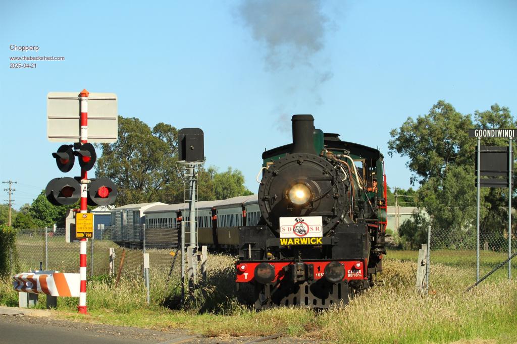

It is to drive the main headlights (front & rear) on the loco shown below celebrating it's 110th birthday built here in Toowoomba. The markers are 24V & run from buck converters so not that critical.

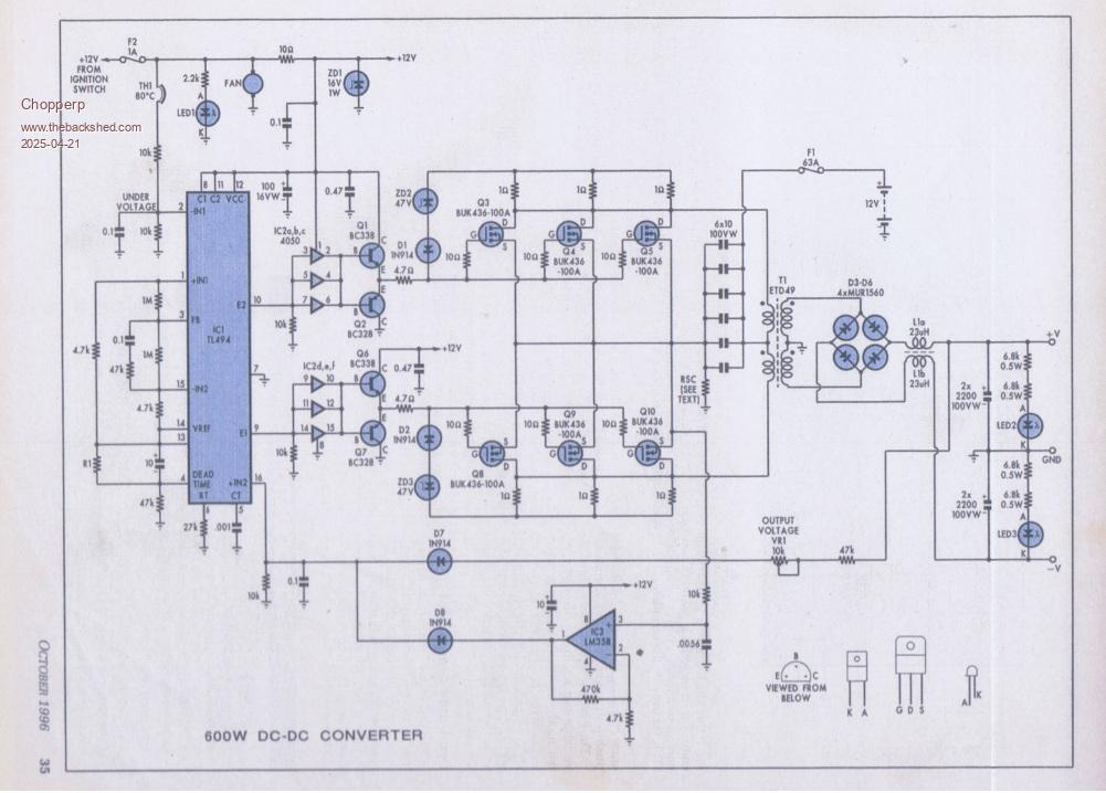

I was thinking of something along the lines of this very old unit below from SC but modified for 32V & single output if possible. Only thinking mind you....

My preference is a full bridge design based on SG3525 or similar, 2 x IR2113 Half bridge drivers, probably 4 x HY4008 Bridge FETs and some synchronous rectifiers such as IRFB3206 or similar. Don't need to provide centre tap on primary or secondary and can use current doubling rectifier topology. Over engineered but will last for 10 - 20 years typically with zero maintenance.  Re cost you cant afford it - that is why I asked for your budget price, I look at it that I get paid something for my hobby

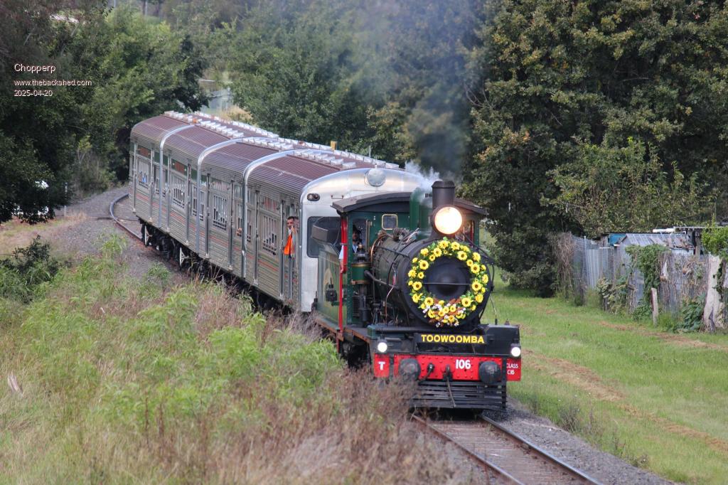

We put 24V 250W driving lights in our other loco along with 24V markers. That was a bit of a pain. See photo.
I think a generously rated 500W unit @ 32V would be the go.
