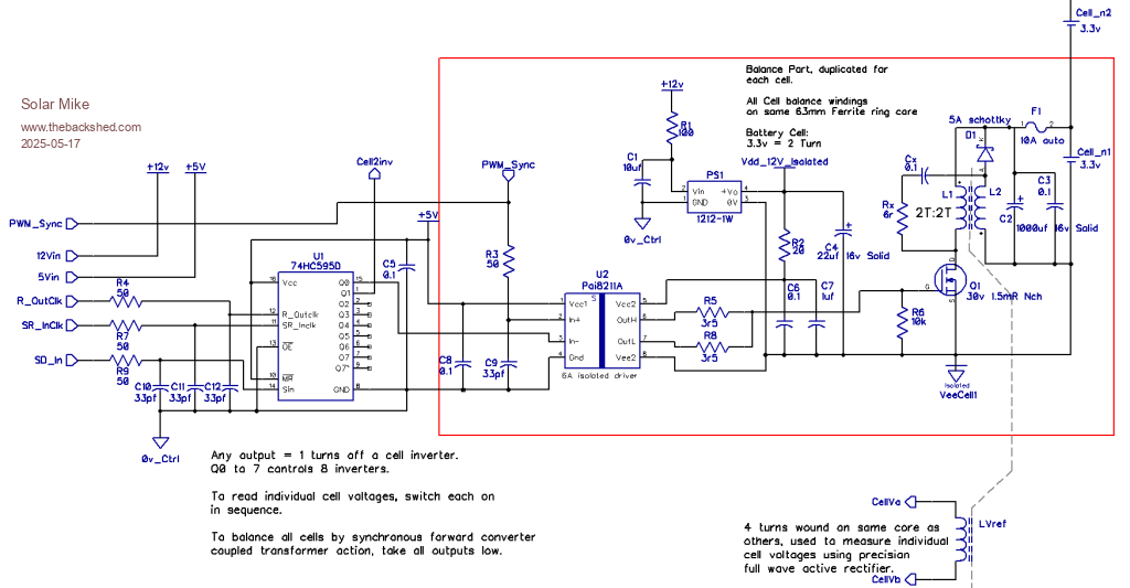

I have been toying with the idea of another active cell balancer design, using a forward converter for each battery cell and a mechanism to read the individual cell voltages by transformer action.
If all coils are wound on the same 65mm ferrite core and drive signals are synchronous, then any cell with a higher voltage than the others will pump current into lower voltage cells, by simple transformer action of voltage difference, at the inverter switching frequency, 60Khz in this case. In order to perform core reset, the pwm on period must be 50% or less.
To measure the individual cell voltages, we have a voltage reference winding and a precision full wave active rectifier. If individual cell converters are switched on, then the voltage at the reference winding is representitive of that cell and as this is a common volt meter, easilly calibrated; thats the theory anyway.
Here is a partial schematic for each cell, it uses an inexpensive mosfet isolated driver (Pai8211A) and 12-12v 1w isolated psu from LCSC. A shift register is used to turn off\on the cell inverters as required; they can be easilly linked to control another bank of 8 cells.
As each cell electronics is duplicated, I might approach this by placing those components on small pcbs, then soldered or plugged into a common carrier board that has the battery cell connections and a cpu controller of some sort.
Here is the base schematic:

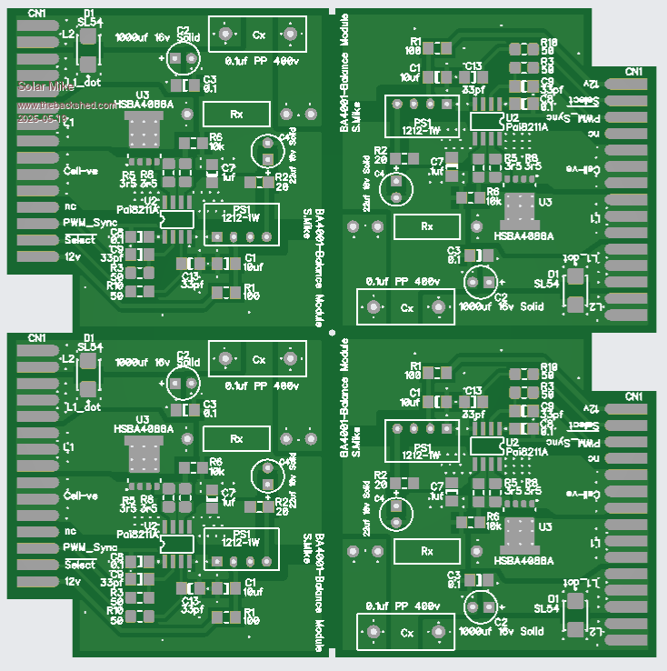

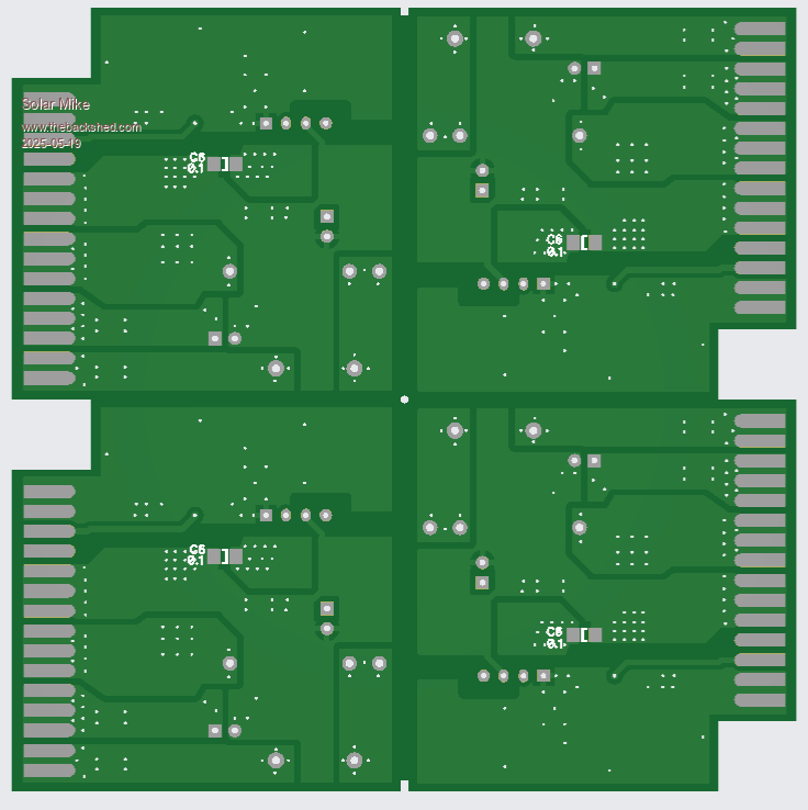

Right some progress, I have come up with a 50x50mm pcb to host the switching components for one cell, as per the schematic in the red box above. Using a 30 pin pcb edge card connector to allow plugging cards in\out for testing.
The mosfet switch HSBA4088A (40V 255A 0.85mΩ@10V,20A 110W PRPAK-8(5x6) ), should remain cold for balance currents up to 20 amps, I doubt it will achieve 20A, as current is determind by voltage difference and impedance or resistance of the circuit including the balance wires, transformer windings and fuse etc to each cell.
Here is the pcb 100x100mm with 4 cards:

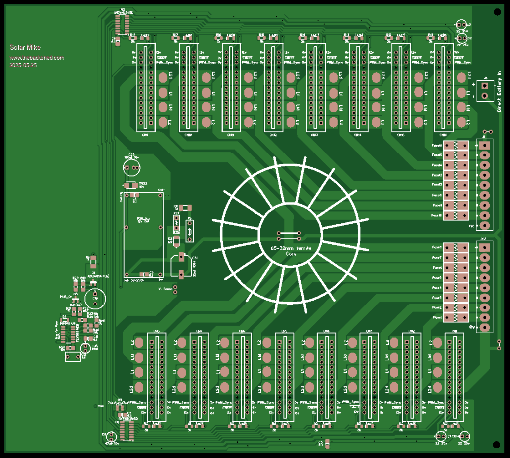

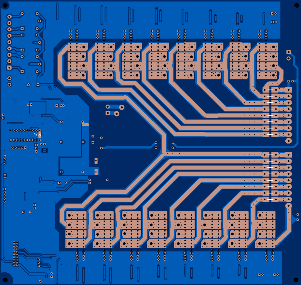

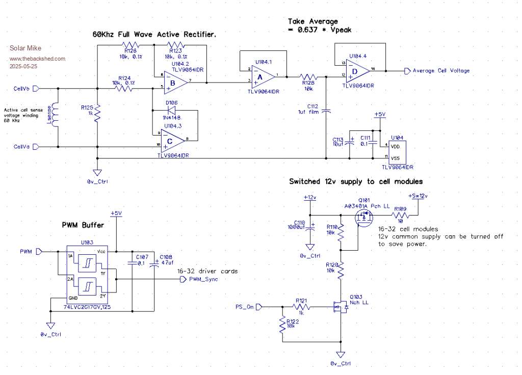

More progress, have laid out the start of a 16 cell mother board, each set of 8 cell modules are driven by a 74HC595 serial to parallel shift register. The large ferrite core sits in the middle of the pcb, using 5mm wide pcb tracks top and bottom to connect to the cell balancing plugs.
The common 60 Khz PWM sync signal to all modules is buffered by a dual 74LVC2G17 logic gate.
12 volt power to cell modules can be switched on\off for power saving.
The 60 Khz cell reference winding for measuring individual cell voltages goes to an active full wave rectifier, then an averaging filter, I'm using a 10Mhz OPamp here TLV9064.
Just have to add a cpu and a few other IO bits.

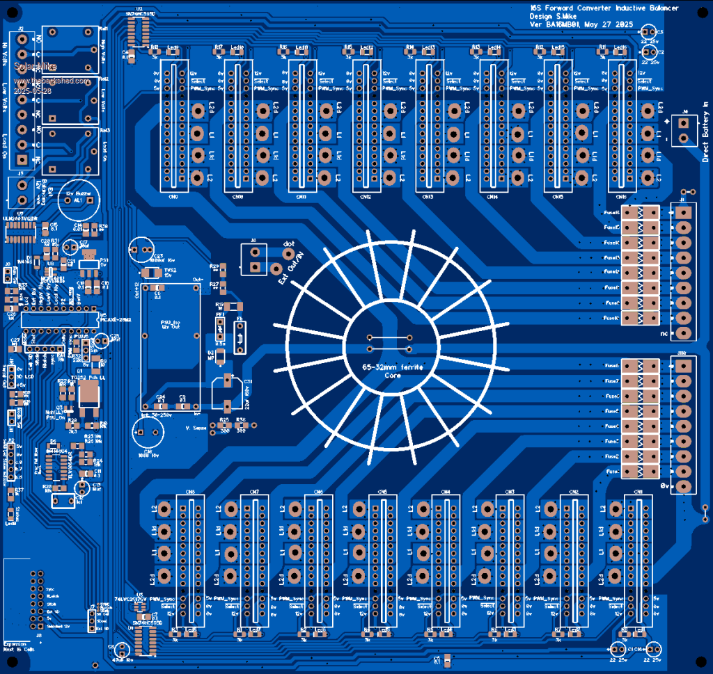

Posted: 11:15am 28 May 2025
PCB completed, hope it works otherwise I have wasted 35hrs; I managed to find some white papers on theoretical design of forward converter balancers, they don't really give any specific details other than pages of maths, so it should work.... in theory.
I haven't drawn up any more of the schematic other than already posted, may do so if it works ok.
Have made the mother board extendable, so a second board can be connected, minus power supply\CPU, to allow another 16 cell modules for a 100 volt Lifepo4 setup. If I wind a number of turns on each core and join the two cores together, then that should allow balancing across all cells, due to the synchronous switching.
PCB has 3 relays for High Volts, Low Volts, Load On, an output for "Balancing" and a serial output to an LCD display or a string of status leds. CPU is the 20 pin Picaxe.
Checked it several times, cannot see any errors, so will send it off to be made, pcb size is 240 x 227mm, a little costly to get 5, if it doesnt work.

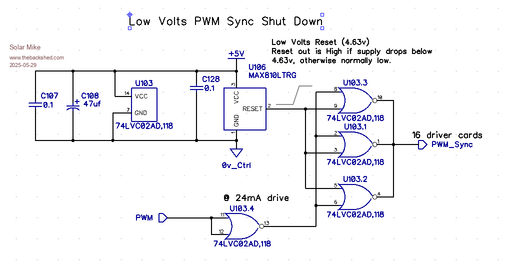

Before sending the gerbers off, have made some last minute changes.
The PIC CPU PWM output can drastically alter its frequency and duty cycle as the chip powers down. If the 5v rail stops or is disconnected and the system was balancing, then the changes in pwm frequency usually downwards may blow things up.
I have noticed this before with various PV controller designs, usually a short grunt squeak comming from the buck inductor, never really did any harm as the power to the circuit was removed. However with 16-32 inductors effectively shorted across each battery cell, there may be a lot of smoke.
To prevent this, have added a MAX810LTRG 5v rail monitor and some logic to shut down the PWM sync drive should the 5v rail ever drop below 4.63 volts.
Amended part of the schematic below:

Hi Mike, IMHO this is a really great design and board layout. Obviously that higher current is not normally needed, but it's nice to have the capability if needed and it certainly makes it robust in normal cell use.
I have also also looked at the AliExpress devices in the past and was also unimpressed.
I wonder how accurate the Cell voltage actuality is. If F1 on a balance board fails for what ever reason, I wonder what the cell voltage output would indicate.
I'm thinking here of an alarm enable and the possibility of expanding the balancer to completely control a pack, everything is basically there to do that if cell voltage is accurate to within a few mv, obviously some code changes but that's easy. Wonder what your thoughts are?

@KeepIS, PCB's are being made now, so until I have them and made one up to test, cannot comment on how well the cpu can read an individual cells voltage, the leakage inductance between the measuring reference coil and other individual cell coils may vary sufficiently as to give inconsistant readings.
As for fuses, using smd reset poly fuses on the cell balance wires, so in theory they wont blow, however if one did, then that cell would have no switching output into the common transformer core and thus no reading on the common reference coil.
