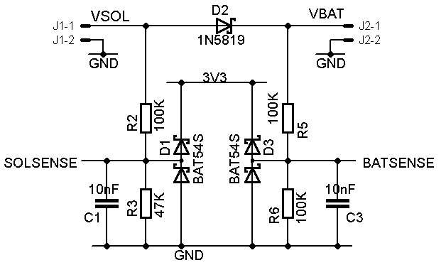

I have built a data logger that has a small battery of 4xAA NiMh cells (so nominally 4.8V but actually seems to sit around 5.2V here)
From the scrap box, I found a solar panel about A6 size that gives 6.1V in bright sun with a short circuit current of about 120mA
The panel currently charges the battery through a single schottkey blocking diode and it all seems quite happy - it does what I expect. I have some quite severe energy saving designs in the hardware for the sensors and radio transmitter (MOSFET hi-side switches) and a *lot* of CPU SLEEPs in the code. I cache the data overnight and only transmit during daylight.

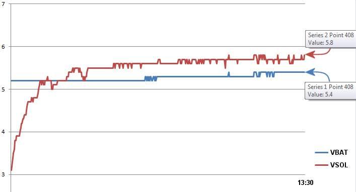

Battery voltage drops to about 5.2V overnight but as the sun comes up, in today's blustery weather with bright bits, VBAT comes up as usual to about 5.4V with VSOL occasionally hitting 5.8V. I sense both solar and battery voltages through potential dividers with D1 and D3 clamping anything nasty to the supply rails and then onto AIN pins, applying a multiplier in the prog to give "real" voltages. All works nicely, but we are coming up to maximum daylight and I am wondering about six months from now when we might be lucky to get 8 hours of heavy overcast.
I am conscious of the voltage drop across D2 and sure enough the trend shows the expected 0.3v-ish difference between VSOL and VBAT (of course VSOL will be dragged down towards VBAT as it tends to short circuit). Clearly this is very blunt and I don't have space or $$$ for some MPPT controller (hence NiMh cells which are quite forgiving).
So now I start thinking about an "ideal diode" circuit (4 components) in an effort to eliminate the "lost" 0.3V and bench tests suggest I might get it down to about 50mV, but does pose some questions for me as I have never done this stuff before.
Ideal Diode schematic and discussion
1. I expect to get a lot more usable energy into the battery - do you see any problems?
2. How do I measure the energy going into the battery? With no voltage drop, I expect ~voltage parity on both sides
3. Should I put a resistor in series? I am thinking 10Ω just to be a bit nicer to the panel and allow the voltages to seperate a bit.
4. what else am I missing?
all input gratefully recieved - thanks in advance

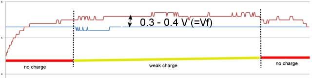

I tried @phil99's idea of a bigger diode (thanks for that) so as to take advantage of it's gentler conduction curve and it was better but with both 10A and 20A variants, Vf was still around 300mV
you can see my dilemma here - was a fairly bright start to the day but now is very gloomy with rain on the way (trace ends at about 2PM, so very dull afternoon).
everything with those red lines and VSol>VBat could be putting a weak charge in to the battery.

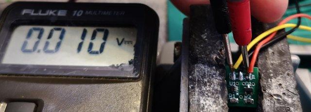

So I got some cute little boards made up for the four component Ideal Diode and assembled/tested one this lunchtime.
Tests I had already done with what I had, suggested I might get Vf down to about 50mV which was very desireable... but, errrr...
Vf=10mV! with the diode into a 56Ω load at 6V (i.e. to draw ~100mA) which are the maximum characteristics of the little solar panel I am using (which I won't get in reality).
So, the question is: "how much 'ideal' is too much?" and what issues do you guys see if I put this in parallel with D2 (easier than replacing)?

I have the ideal diode built and ready to go and at 10mV it is almost the short-circuit that I seek. 10mV out of the panel's 6V (although unlikely) is 0.16% loss - way better than the 5% (probably much worse) I am getting now. I have been watching the traces this morning and it grinds my gears to see dV (VSol-VBat) at just +0.2v and know that nothing is going into the battery, whereas with a "short", the battery would be sucking every last joule from the panel - I aspire to that.
I'm gonna fit the Ideal diode this weekend (or maybe today). I anticipate the voltage traces will become a single line when dV>0 as it will be around a tenth of the resolution of reporting... will tweak that in the next software.

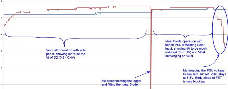

I went ahead and got the logger into the shed and fitted the Ideal Diode circuit board across D2. Below is the trace for the day (almost). The circuit runs as expected and the traces look very healthy.
Next step is to load the new software and put it back in the wild... which will be tomorrow so I can continue to monitor batter use over night.
