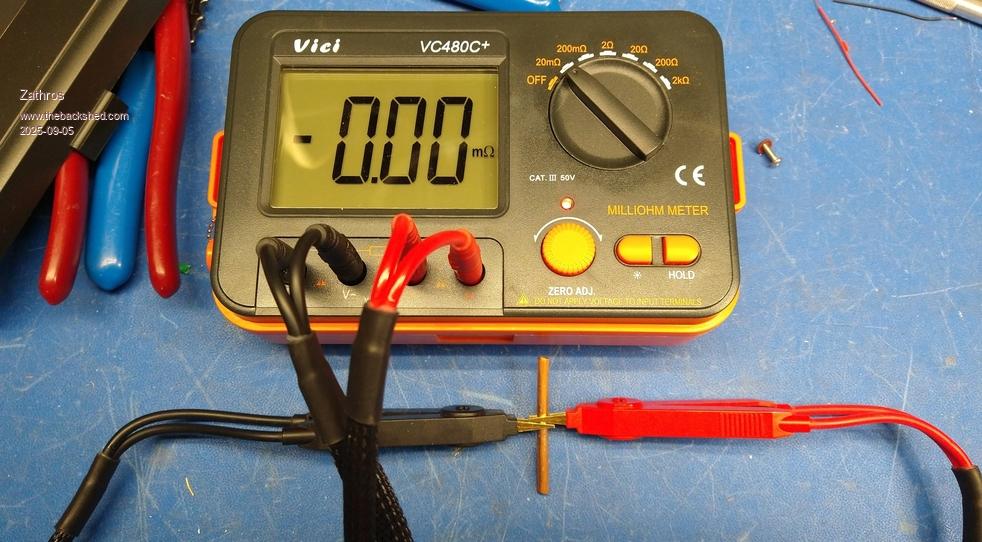

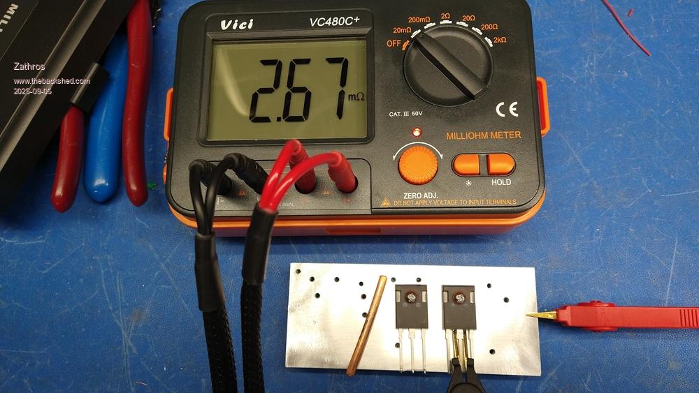

I had reciently purchased a Vici VC480C+ milliohm meter from Amazon and decided to see what could be measured.
For the money, the VC480C+ is a quite capable meter.

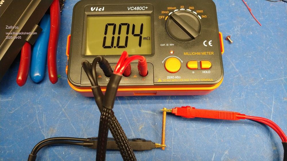

For zeroing the meter, I've been using a 2" long chunk of 6ga (16mm2) wire.
The meter is sensitive enough that if you zero the meter with the clips close together, then move the clips to the ends of the wire the meter measures .04 miliohms. The measurement is quite repeatable.

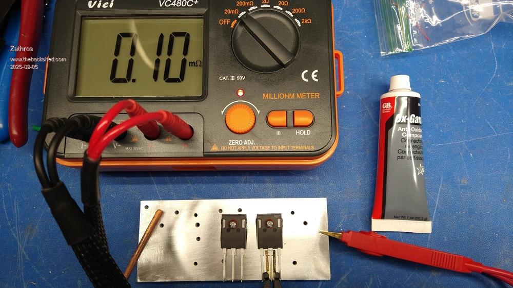

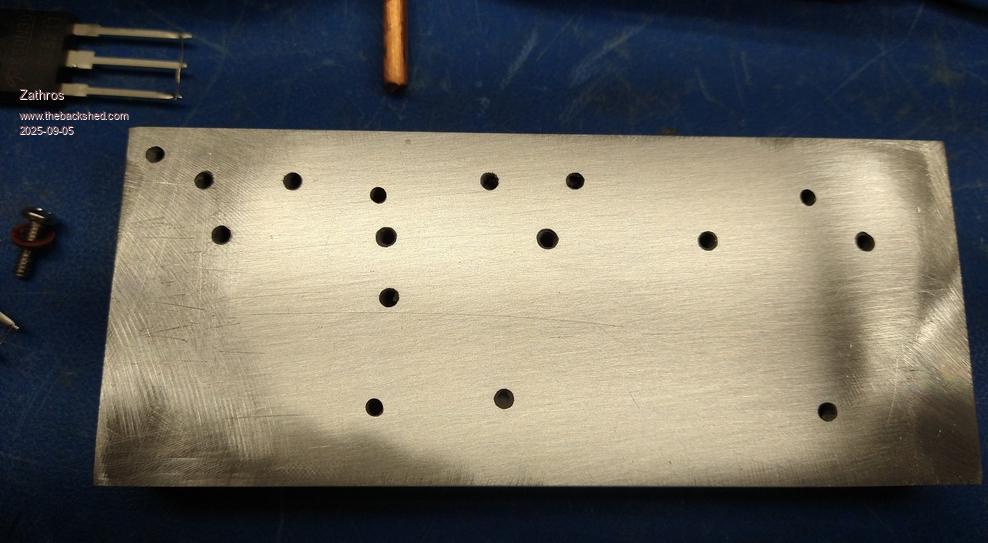

The test heatsink was prepared using a benchtop disk sander to remove the aluminum oxide layer and flatten the back. Final prep was hand sanding using 5" diameter 150 grit followed by 220 grit self adhesive sandpaper stuck to the top of the cast iron deck of the table saw.

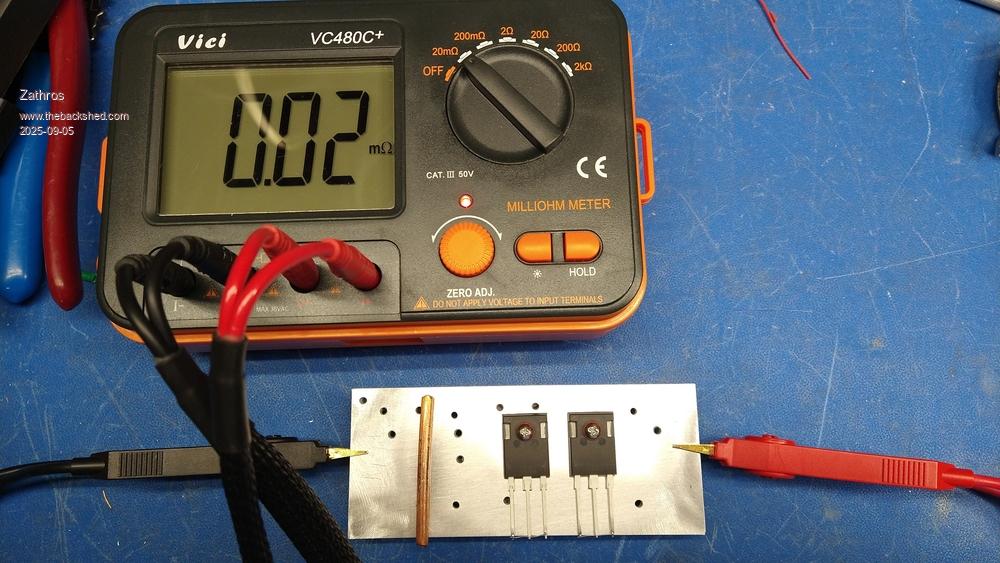

The meter uses 4 wire clips so back side of the heatsink also needs to be preped in 2 spots where the meter will be connected.
For checking the meter connection to the heatsink the clips are connected to opposite ends of the heatsink.

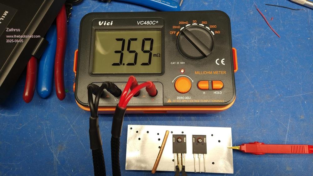

The drain to heatsink resistance was measured with 1 lead cliped to the heatsink and the other lead clipped to the drain lead at the MOSFET body.
MOSFET #1
MOSFET #2

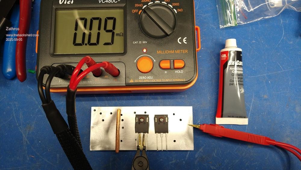

Compound was applied between the MOSFETs and heatsink the same way heatsink compound is used.
MOSFET #1 with compound
MOSFET #2 with compound

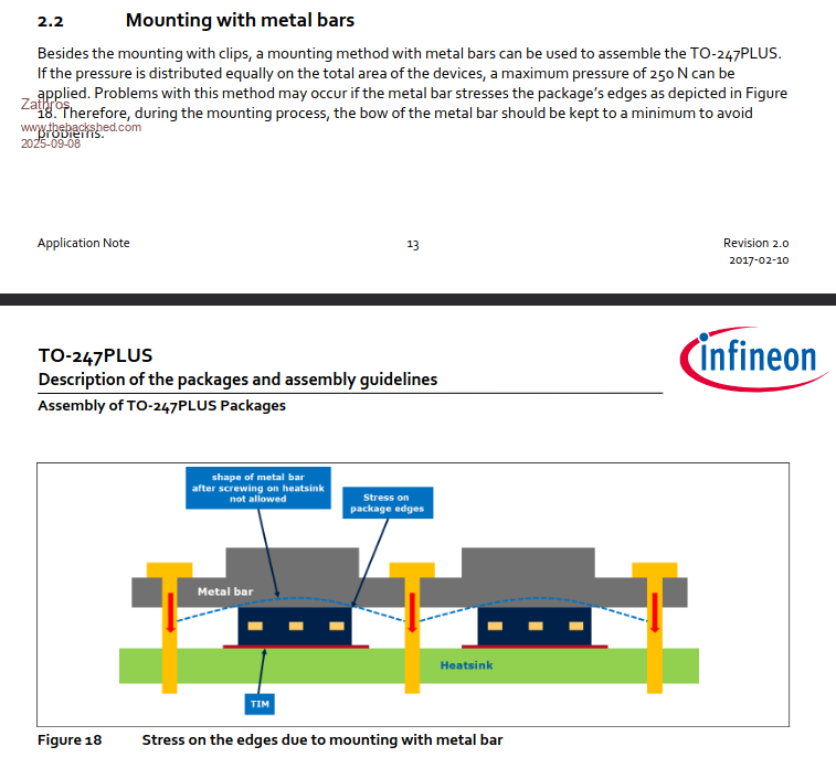

That should help but I think bar clamps that are wide enough to cover most of the MOSFET package and centered across the package would provide even more balanced pressure.
Yes, bar clamps work great. Good choice while designing, but can be difficule to retrofit.
Great information in the
Infineon Application Note AN2017-01
Excerpt from AN2017-01:
