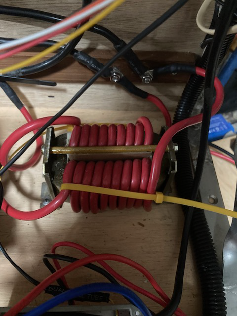

This is the big aerosharp choke I used. I could only get 9 turns each side and increased the gap to 4mm. I tested as a single choke with the transformer end shorted.
5 turns each side @ 1.6mm gap gave 51uF saturation 180-190 amps
9 turns each side @ 4.0mm gap gave 55uF(45uF) saturation 300-350 amps
I did it some time ago, I think inductance might have dropped to about 45uF when wound with the bigger cable.
I have not tested with a big inductive load yet, but it does start a bunnings 1250 watt wet/dry vacuum cleaner without a blow up.

  Quote  That depends on the number of turns and the cross-section of the core.
Obviously, as it does for any core, however I doubt it will come anywhere near the minimum 350A needed, and for a 6kW/25kW LF Inverter, at least 500A saturation would be desirable.
@disco4now, that is interesting, if those figures are accurate then, it might be ok, how hot would it run at around 5kW for an hour.
FYI a big wet dry vac from bunnings peaks at 236A on start, two plug-packs for the new Desktop monitors hit 300A to 350A at morning power on.

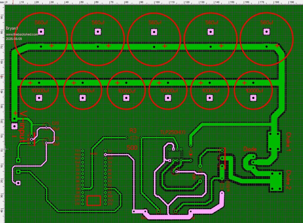

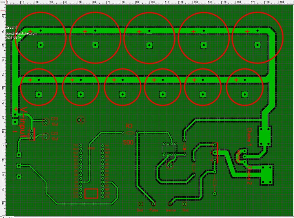

Well Guy's I am having a bit of fun playing with Sprint Layout and in time I will come up with a new PCB design that uses the 5 off 450 volt 560uf caps off the aerosharp board and as I do have 6 off 35 volt 10000uf caps they will be used too.
Now I'm using the schematic to work off and noticed the nano doesn't have a connection for the Vin so that will need to be sorted.
I don't have any BNC to BNC cables and most won't either so for the scope inputs pins can be used with earth pins put in for using the probes.
As my software is new I have to make macros for just about everything so that is taking time so I will get there.
Regards Bryan

Bryan1
Joined: 22/02/2006
Posts: 2100
Posted: 08:05am 07 Jun 2026
Well silly me should of realized the nano will be connected by USB so the computer can read the serial in.

Posted: 01:59am 08 Jun 2026

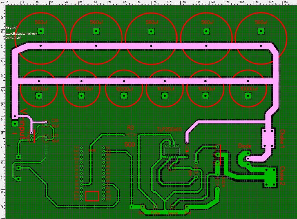

Ok had another look this morning and fixed a few things, now with the 0.02 ohm resistor I found some on Ali so 20 of them are on the way
Here is a picture of the positive rail
Here is the negative rail
Now the board has passed the DRC test so I do think I have everything right   so today I'll upload the board to JLCPCB and get 5 boards made to get started so if any problems arise a V2 board can be made.
Regards Bryan

Hi Bryan. I'm just learning to do some of my own PCBs. What is the advantage of having the negative tracks over just using the copper ground plane and using thermal pads?
BarryH
Bryan1
Joined: 22/02/2006
Posts: 2100
Posted: 04:09am 08 Jun 2026
  BarryH said  Hi Bryan. I'm just learning to do some of my own PCBs. What is the advantage of having the negative tracks over just using the copper ground plane and using thermal pads?
Well Barry Mixtel put me onto doing the ground plains and he IS the guru of Sprint Layout. I was surprised I could get the circuit on the one layer, now with my first upload which did fail and I'm glad it did as I only had 1.5mm holes for the snapin caps so I opened the holes out to 2mm and uploaded the zip file where it went thru
As I had used Sprint Layout before relearning has been pretty easy and with this board first measuring with my dial vernier to get the distance then using the measure tool make the pads to suit. Then finish off the part and select it all then save as Macros so it's there for future use.
Regards Bryan

It's not completely clear to me but connect your power ground/negative rail plane and digital ground in 1 point. It looks like you have 1 plane for the 2. You can have a positive power plane too instead of a single track so it acts like a laminated bus.
Have some inspiration from solar mike his posted design. That is how I would do it.
