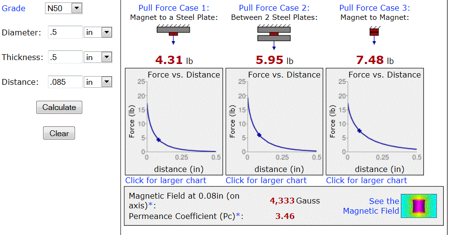

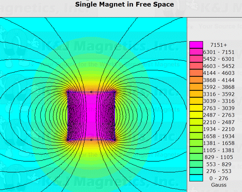

Posted: 09:23pm 18 Dec 2011
Ok heres what I am thinking of ordering 12- N50 discs 1/2"X 1/2" With a Gauss of 4333. Here is all the information on them in the Pics, provided I get them uploaded.
Do you think they will produce a usable amount of power?
Ken

Posted: 01:25am 19 Dec 2011
Hello Ken;
Your research of the magnets is good. Now have you wound any coils ? It might be a good idea to match the magnet with the coil size you are planning to use.
Regards Robert.
