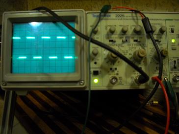

Hi, the new used oscilloscope arrived. It displays the calibration wave form on each channel. What connections are needed to view the AC output of the PMA? Until now, I have been using a 12 volt test light and multi-meter to test a 3 phase star PMA. Any help will be greatly appreciated.

When testing the output of a 3 phase alternator, you need to be carefull how you connect the earth clip of the test probes. If there is a voltage difference between the earth clips of both probes, you could damage the cro. The earth clips are connected internally ( unless its got a fancy floating input amp, not common ), so you only need to connect ONE of the earth clips to whatever you are testing. If you have access to the star connection, you can connect the earth clip to that and the probes to two of the phase outputs, and then see the two sine waves on the screen, out of phase with eachother.

Hi, thank you for the help. Spinning the PMA by hand I am to confirm that the PMA does produce a sine wave output.

If you can't access the star point, you could create a star point with 3 resistors.
Connect the gnd of the cro to the star point of the resistors.
For 12 Volt, three 1000 Ohm 1/2 Watt resistors would be safe since the power dissipation would be 12 * 12/1000 = 0.144 Watt.
