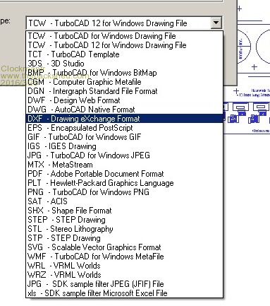

Hi.
I have been doing the OzInverter New 6kW-15kW Power Board.
For my use and individual masks for this large A4 size board, I have CAD software TCW Pro14, it does the boards and the separate layer masks, no probs.
Now it seems that to get these Power Boards made, (seems other folk would like them ready made), at PCB manufactures ShenZhen2u or other PCB folk.
They request RS-274X gerber files.
Here below is what my CAD files can be exported as......
I see that there is reasonable cost software on the market that can do conversions, like GerberView etc, but I am not sure it this software will work.?
My PDF files of the layers/masks comes out real nice, and at real size.
I really do not want to spend monies on PCB software and start again.
Any help or advice would be appreaciated.

I have looked at Eagle, but the board I am doing is 282mm x 174mm double side.
So the Eagle low cost option is out.
I looked at PADS, very costly. I looked at Autotrax but again no particular mention of importing DXF etc.
Sprint layout 6, at least says it can import a file and use as background and you can build the PCB board over it.
All the file conversion software mentions PDF, DXF to gerber, but only under circumstances when the PDF DXF is a created file.
So it seems that even Auto CAD to gerber needs modifying as the track size and other vectors disappear when gerber, so you need a gerber view to modify the gerber.
So if I get this right.....?
Ordinary DXF, PDF files can not be converted to gerber unless modified, and the PCB software folk have limited mentions of functions.
To see the gerber you need a gerber viewer.
To get the PCB to suit the manufacturers, I disregard CAD, and I need to start again and buy some PCB software, and learn.
Once the PCB is created, the particular PCB software companies files need converting to RS-247X.
Personally I have not done a PCB since the 1980's, and it seems that in the last 30 years the PCB brigade have not moved forward very much.

http://bayareacircuits.com/wp-content/uploads/2013/12/DXFtoGerberConversionGuide_rev2_12-10-13.pdf
according to this what you are doing now is a valid option. I guess you could email a DFX file to someone with a cad program that outputs RS-274X, you would still need a viewer.

I should have wound this topic up some time ago.!
DXF file to PCB layout to Gerber files.
I purchased AutotraxDEX and Sprintlayout6, both of these were limited for my use.
However, .... I purchased the TARGET V18 PCB software, and this was spot on, thanks to FranknFurter for his info and help.
It imported my DXF cad file and incorporated it into a TARGET file with all the incorporated layers and text. I had to outline draw some parts as TARGET wants closed borders on entities.
I personally do not like delete files running with the normal files, so I redrew in a few places to remove copper around heatsink holes etc.
I found most of TARGET creation was very CAD orientated, but still with some PCB DOS type chunkiness here and there, but I have got used to that now.
Printing out actual real size A4 size masks with my little laser printer is also spot on.
Producing from a TARGET file to Gerber is very easy, and saving and changing the file name to match what the PCB manufactures want is also very easy.
So Yes, I like TARGET, yes a few hundred Euros, but it does the job for me with out busting the Bank.
