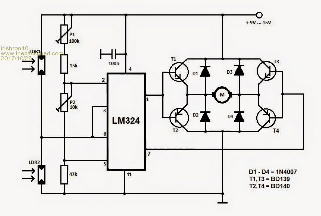

hi all. i havent been much on the web as electronics are taking over my life haha
can someone tell me if this system be able to drive a wiper motor.
I have the mechanics all build with 2 wiper motors
one for horizontal and one for vertical tracking.
ron

The BD139's might not handle the current of the wiper motor.
Atm I have a dual relay module driving a motorised water valve.
One relay pulls in for open, the other for closed; in effect just providing polarity in either direction.
The relays are controlled by a 28 pin Micromite (easy bit).
Cheers.

Prone to over current on the transistors.
Those wiper motors are low impedance so the start current to over come the start inertia will probably lead to destruction.... unless you soft start it of course.
I guess you could use the spare comparators to use one for triangle wave generation, and the other for the pulse width generation, and modulate one side of the bridge.... but still would be evil.... and start to get complicated quickly.
Not how I would do it, but it really needs something to mitigate the high inrush currents in what appears to be a delicate controller. It does not address o/load either.
Perhaps the better route would be to get a controller from ebay like this
https://www.ebay.com.au/itm/6V-12V-24V-30V-DC-Motor-Speed-Controller-Reversible-PWM-Forward-Reverse-Switch/401396178765? hash=item5d75139f4d:g:xVUAAOSwl9RZ5xPp
If you set for slow speed on the pot, you will likely not over current.
Or for power then a few of these... then you can go for broke.
https://www.ebay.com.au/itm/DC-12V-24V-48V-PWM-DC-Motor-Speed-Controller-Forward-Stop-Reverse-Switch/282605740898?_trkpa rms=aid%3D555017%26algo%3DPL.CASSINI%26ao%3D1%26asc%3D20160630134829%26meid%3D9ddd6db9cee5474a90f1a4e5bb7acff3%26pid%3D1 00507%26rk%3D1%26rkt%3D1%26&_trksid=p2045573.c100507.m3226
Then use your cunning 324 to control them/it.
........oztules

i might use 12volt 30A relays, andlet the main current run thru those.
I have plenty of those soit saves expense lol
the transistors would have no problem swithing the relays
i got a few low voltage hallogen lamps and ut the back off,
have the ldr`s fitted inside in a little bit of pipe.
perfectly sealed that way. just thought I share this idea.
thx for the replies.

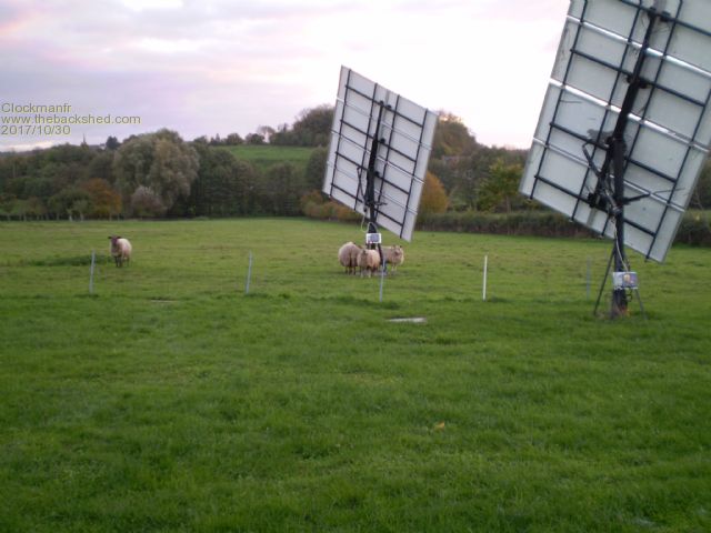

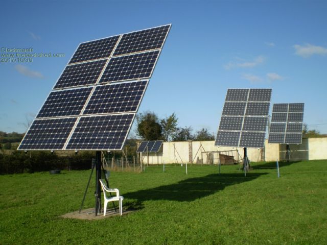

Heres my three double axis.
Yes they go flat if I know about a hurricane.
Been up nearly 5 years and well tested.
8 panels about 2kW each, any more than that then we start getting really serious about the frame structure and the lump of supporting concrete.

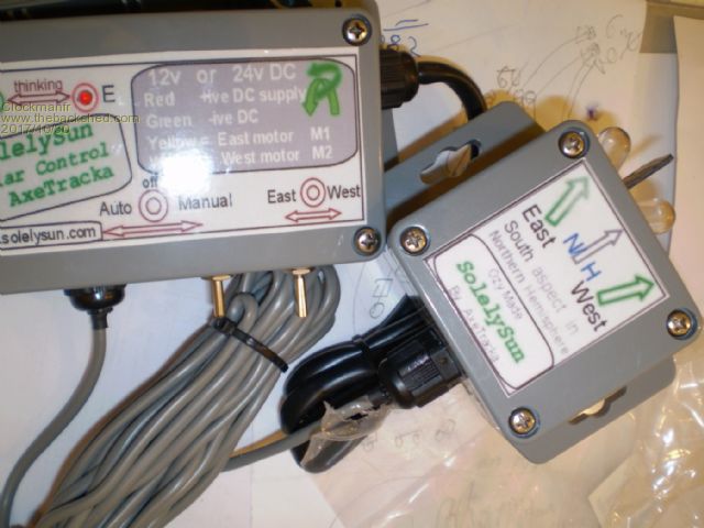

LED light sensors that moves the 24v actuator & tracker every 10 minutes or so, and circuit made by a guy called Dave in Cowa. Night time it parks itself for the morning Sun.
Costs, about $600 for each materials, then theres the panels cost.
To make a good sheep proof static steel frame etc, for a static PV array for 8 panels is about $300.
Daves circuits were at his site Axetracka.com and on ebay.
Heres a retailer selling his stuff http://www.bobssolarpanels.com/solar-tracking.htmlhttp://www.bobssolarpanels.com/solar-tracking.html

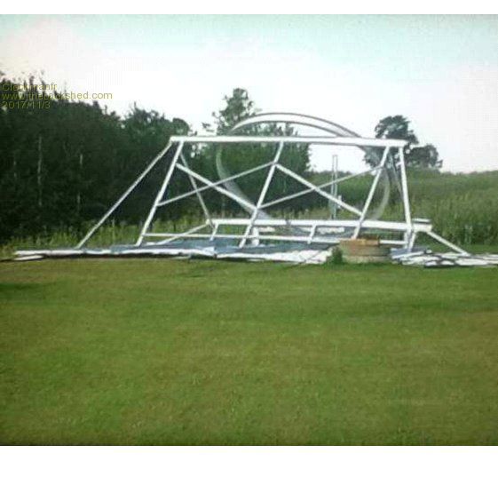

Here's a poor rotary 10kW design that just lifted away, Oh dear!
Edited by Clockmanfr 2017-11-04
