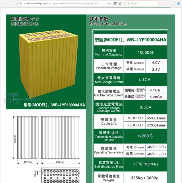

Posted: 01:11pm 25 Jan 2018
I imagine 16 of those 335kg cells would beat Mad's forklift pack hands down by weight .
I also think at that size they get a wee bit impractical but just imagine, you'd need to charge these monsters only every two weeks at my place.

What is the price of those? Going rate for Lithium is around $1 per WH which at that rate would put 16 of those at $500,000 AUD.

I did find this WB-LYP1000AHC, 3.2V, 1000AH, 560×360×130, 35kg $2000
So 13 times that is $26,000 USD a lot more than FLA and a 10,000 AH version is going to be in region of $260,000 USD, that's $353,000 AUD with GST Plus freight etc.
So was my estimate of $500,000 AUD that far-fetched? Maybe 20% over.Edited by Madness 2018-01-27
