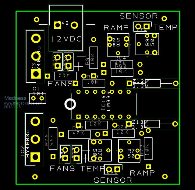

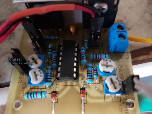

Just finished doing an upgrade to Oztules 12V fan controller originally designed for the Ozinverter but could be used for anything needing automatic fan control.
The original version only had one output, I have used one of the spare channels of the LM339 Comparator so that there are 2 separate inputs and 2 outputs. In my inverter I use one side for the Heatsinks and the other for the transformer. It all fits on a 50mm square PCB. Sensors are 10K Thermistors .
2018-01-26_105714_TempFan2_Silkscreen.pdf 2018-01-26_105740_TempFan2Copper.pdf
This is Oztules explanation of how it works.
"It is a very simple use of a quad comparator chip I have lots of. We only use 1 in this case, and I was surprised at how well it worked... so I built some more.
The comparator compares two voltages, and if the + input one is higher than the other the output transistor is turned on, if not then off.
So we have an open collector output to deal with....... which means two things.
1. we need to supply it with voltage on the collector ( via 10k )
2. when the +>- then the transistor is turned on and shorts the collector to ground.... so on is off and off is on.
To see how it works,
1. we use a 10k and a 3v zener to establish a fixed reference voltage on pin 7 ( +input) This gives us a set point that we can use to compare the temp probe to.
2. We set up a voltage divider using the 47k, the 50k pot and the temp probe all seriesed with Vcc to ground.... fed to pin 6 (-input)
3. When the NTC temp goes up, it's resistance comes down, pulling the output of the 50k pot lower and lower
4. When it gets lower than pin 7 voltage, then the comparator will switch off the transistor ( which was shorted to ground when on), and the 10k pull up resistor ( Vcc to pin 1 output) will be able to deliver voltage to the now open circuit collector on pin 1... this voltage then fed to the fet to switch fan on.
Now thats as a comparator, it is on or off..... if we introduce negative feedback into the - input ( pin 6) then we alter the stage gain, and the more feedack we introduce, the lower the gain, and the sharp on/ off behaviour of the comparator is made wishy washy.... thats tech talk for it will now switch on and off before and after the set point, with a voltage slope rather than hard on or off..... this translates to the fet as more or less voltage to the fan/s.
The feedback is introduced at pin 6 via the 50k pot on the right. It takes some of the output through a 10k and then a 50k pot back to the input of pin 6.... so we can change how hard and fast the fans turn on.
I set mine so that as it approaches the set point, the fans wake up and start rotation, silent and slow, then as the set point gets closer, they speed up, if they can stabilise it at low speed then good, else it gets hotter, the fans spin faster until you can hear them... all the way up to full on at the set point... so feedback pot for slope rate."

I have an Arduino version also using Dallas digital temperature sensors, records maximum temperature too so you know exactly how hot this get. The digital sensors allow you to have lots sensors on the one input pin plus give accurate actual temperature readings.
The board here is Analogue, the noise is resulting from fans that are designed to controlled digitally, I could do that with an Arduino but have not bothered. The circuit here is quick and simple, works well especially for those who don't have Arduino experience.

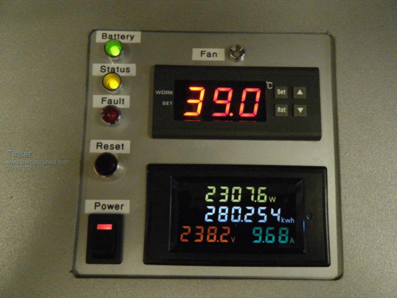

Here is a case in point; the picture below shows the panel of my converter PJ inverter. This has a 8KW (Chinese) power module and a rewound 3KW toroid which, BTW, has a very generous copper section primary and secondary winding.
But, unfortunately, I did squeeze the lot in an recycled Aerosharp enclosure.
Note that there is virtually no load on, this inverter only powers the lights in my house. Yet, its 4 x 80mm fans (2 in, 2 out) have to cycle on constantly to maintain the shown temperature on this, relatively cool, 30 degree Perth summer day.
And we do have our share of 40+ days here as well Madness, the fans will just about run non stop then.

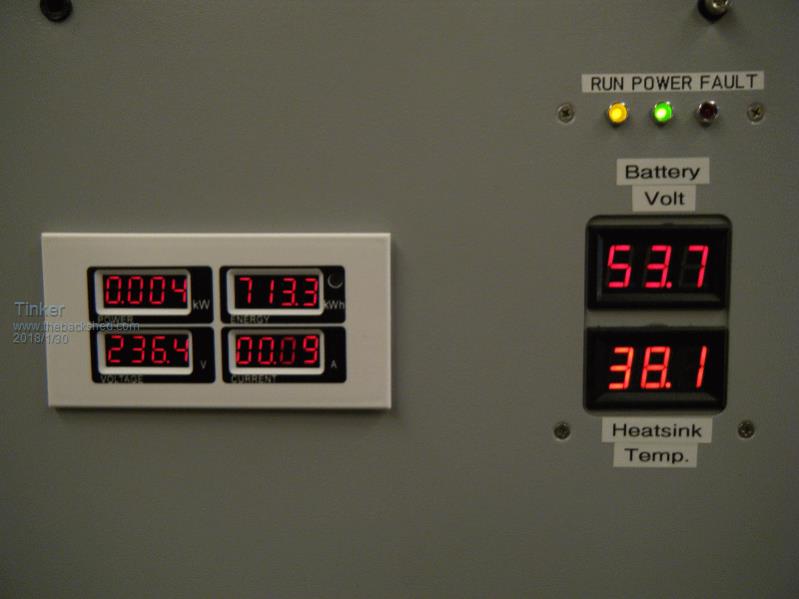

Next a picture of my new, own design, double stack inverter.
Note that this one *does* have a reasonable load on, yet its fans took 15 min or so to come on and then have long off times with that load. With no load the fan never runs at all unless the ambient gets very close to the 40 degree fan trigger temperature.
I am not worried at all about the expensive capacitors getting too warm, they are located on the cool side of the PCB and do not see more than 42 degrees or so on a very hot day.
So, having smaller fans that virtually need not to run at all with my usual cycling loads does not matter at all.

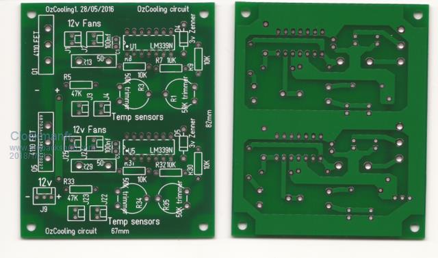

OzCooling board.
2 Fans and 2 temp sensors for the toroid, ..... and 2 fans and 2 temp sensors for the PCB's

What I did is make better use of the IC, it has 4 channels but that circuit only uses one, my modification just eliminates the 2nd LM339. I find it works fine with single thermistors.
