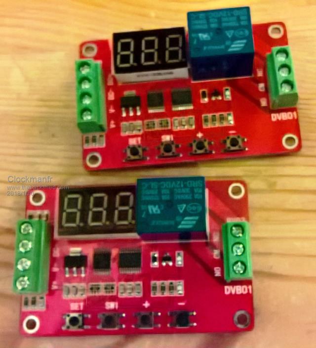

I have been testing several voltage comparators for the OzInverter projects.
This particular comparator gave me interest, it seems to do/promise what I want in its description. If it worked, it would be a simple cost effective addition board I could point folk towards.
https://www.aliexpress.com/item/quality-12V-DVB01-Digital-window-voltage-comparator-voltage-measurement-discharge-over-v oltage-overrun-protection/32718271902.html?spm=a2g0s.9042311.0.0.WkgMjD
But sadly the awful Chinese translation to English is just diabolical, although it had my tech savvy teenager boys here rolling around the floor with laughter.
Its a step through menu system with 4 push buttons, but sadly the normal logical steps for programming the unit is beyond my foolish comprehension.
Can any of you intelligent bright sparks here help?

Normally there are tutorials and explanations of these boards on YT.
Had a look for you but came up empty.
maybe they are relatively new and no one else has been able to figure the things out yet either. :0)
You are right about the terrible translations. I have come across these boards and even the descriptions are totally and pathetically wrong as to what the thing does.
Surely somewhere in china thee must be like an interpreting/ copyrighting service that these manufacturers can send the description in Chinese and get a reasonable English ( or other languages) back.

http://www.ssigjern.dk/manuals/41000275_uk.pdf
Is that one any better?

Thanks Mark, that's a better translation than the one I have. I will give it another go for more fun and games.
I have set up a dispute with the seller saying that because of terrible programming instructions the product is useless, I await to see what alliexpress has to say.
I think the Chinese language is very different to English in its back tracking on the subject matter, hence the utter confusion.
Still have to smile with this below bit of translation from yours Mark !......

Mark, ..... Its for following my 48v battery system state of charge, and switching stuff in and out at a basic level.
Mad and Oztules have GTI control on the DC side of the GTI, ie they control what DC from the PV panels is going into the GTI, by looking at the state of charge of the battery.
My GTI control is done with 2 methods, firstly with the PJ boards from China, as my battery's filled up the batteries would push back and increase the 230vac that the OzInverter is creating, remember PJ boards only. The internal settings in the GTI will shut down the GTI if the AC voltage goes high.
On Our New Boards, OzControl, OzCooling and Power Board the AC voltage stays rock solid at what you set it, say 230vac. So we have to use a battery monitoring circuit to shut down our GTI;s.
I am happy with disconnecting the AC side on the GTI's and this has worked well for the last couple of years. But its getting a simple circuit to monitor the Batteries DC state of charge.
There are many ways of doing this, but at present I am trying to find the most simple, robust and importantly cost effective way.
To complicate matters further I also have DC dump loads for my 3 wind turbines with a SSR on the dump side that can divert AC side to water/underfloor heating.
Now with this commercially obtained, Tristar/Midnite classic, controller I can use their internal battery monitor to tell me when it goes to dump to switch of the GTI's because the controller says the batteries are charged.
But again there are variables, no sun but the wind turbines are seriously kicking in DC to the battery bank, the controller diverts excess over a set limit, then this set limit is internally reset when the controller thinks the batteries are getting full.
I have tried an Arduino circuit that recognised that the controller had gone to float and was dumping by using battery voltage alone, but this needed time lags to ensure that the float was really at float and not just a dodgy mediocre day for RE energy input. So this was not really successful and had a habit of leaving the battery undercharged.
Hence me testing stuff that comes ready made, and can be easily incorporated into a simple system for AC GTI control. At present I have 4, eventually I will have 6 GTI's putting into, AC Coupling, with my OzInverter created mini grid.
We need to switch the GTI's in and out.
What would be nice to get/find, buy, is a simple controller that watches the batteries and can switch relays in and out depending on the battery's state of charge. With variable settings and time lag settings depending on your own particular size and type of batteries.
Then I could put this in the OzInverter Book and point folk towards it, as a general GTI control system for a 48vdc battery OzInverter AC Coupling power system.

You could use the "waste not low" function in the Midnite controller on Aux 2 (not Aux 1 as it can not do PWM) to drive MOSFETs to regulate the GTI.
What it will do is supply 12V until Absorb or Float voltage is reached then it will apply PWM to the AUX which will make the MOSFETs regulate the output of the GTI. The circuit required is the same as Oztules GTI regulator but with no Arduino, instead the Midnite Classic will provide the signal required to the A3120 Opto isolated driver IC.
For most GTI's you also MUST isolate the MOSFETs and power supply to the A3120 IC, I have posted details in Oztules thread.

If you are looking for something like this that is a bit more "up market" check out the JLD5740. Its far more expensive though at US $37
http://www.lightobject.com/Programmable-4-Digit-Red-LED-ACDC-Volt-Meter-with-Dual-Control-Good-for-HHO-System-P408.aspx
What you get is four large digits with 10mV resolution up to 99.99 volts.
Two alarm relays each with changeover contacts.
And each relay has independent programmable pull in and drop out voltage.
It can also be calibrated (digitally) against a good reference voltmeter, although it comes already factory calibrated.
It can also be used to measure ac and dc voltages up to 500.0v
Plus, it is housed in a plastic enclosure that can fit into a front panel.

Is this the same as the manual you already have?
2018-02-04_071708_41000275_uk.pdf
Here is a detailed video. Edited by Madness 2018-02-05
Posted: 11:54am 04 Feb 2018
Thanks Mad, just looked at that video, it is excellent. For once an utube really showing the goods.

The manual is as Mark listed.
Thanks Madness regards the video. It has better explanations for fools like me.
At the beginning I started to fall a sleep, hypnotic drone.
About 5 minutes in the stuff is explained and we are seeing the operation and setting the thing.
At 15 minutes the time delay is explained.
Its still far to geeky for normal folk, just trying to work out how to make the instructions more understandable. ?

Yes the time delay is important so the surges and voltage sags to the batteries can be allowed for.
