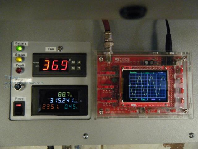

Some time ago warpspeed mentioned those (can't recall the thread) cheap kit digital scopes.
Well, I had ordered one and it duly arrived. To my surprise it worked well the first time it was switched on.
Anyway, I also ordered that acrylic case, supplied in kit form.
That one never arrived but I got another oscilloscope kit delivered instead - I was not going to complain about that .
So, after then ordering two acrylic cases, they arrived yesterday.
Has anybody used them? If you do get one you will be in for a little challenge to put it together . Just as well I like doing jigsaw puzzles, that case provided me with an hour or so of capital 'fun'.
A hint: its best to assemble the three internal acrylic panels first, to one of which the small plug in display board attaches. That particular panel is rather fragile, I managed to easily break it when inserting the display board connector.
So, temporarily screw these 3 panels together with shorter M3 screws. This makes all much more rigid for the display board attachment and plugging in - saves superglue too .
Here is a pic of the finished case, the screen shows the inverter output at low load (<100W).
That wave form got a lot cleaner, BTW, after I re located the ferrite choke to the high F primary leg. All the little spikes at the peaks have gone away now.

Yes, the case has been well designed. There have been a number of hardware modification submitted by community members. Likewise, a few firmware updates.
Good support from the manufacturer.
A great 'scope for working on off-grid and power supply systems.

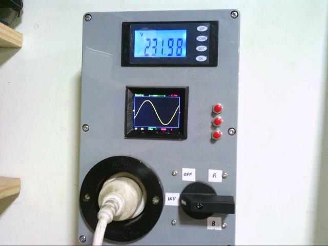

When I bought my two kits the plastic cases were not available back then.
I wanted to mount this behind a front panel, so what I did was cut and glued together the bezels from a couple of old digital voltmeters.

Quick and possibly obvious question for you Tony.
Do you run an x10/probe or resistor divider or transformer for your mains sampling to your scope?
Ralph
Posted: 04:00am 10 Feb 2018
I run a very small transformer to isolate the mains from the oscilloscope input.
And dc power for it comes from a dc plug pack.
