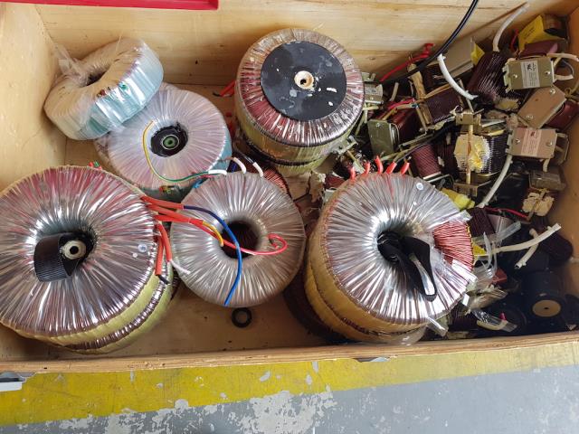

Hello All,
Trying to source parts for an OzInverter, but I'm having a really hard time finding old GTIs for toroids which I imagine is going to be straight out impossible very soon. Does anyone know of any other equipment that might be salvaged to get suitable transformer cores?

I was hoping you could offer some advice on what toroids from the pic would be suitable. Ideally I would like to make two units in the 4-6kW range. I was thinking the matched pairs on the bottom right and bottom left?

renewableMark
Joined: 09/12/2017
Posts: 1679
Posted: 03:18am 28 Mar 2018

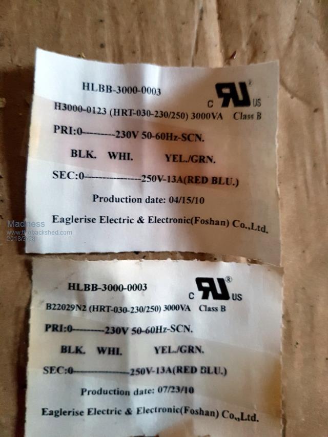

Ryan, there should be a visible label on them, if it has 3000 w on it then buy it.
I was thinking that three 2000w units together might be ok too, but you'de need to remove some off the centre, so try and get 3000w units.
If the label isn't clear what wattage it is, then go by the secondary amps.
That will be listed on the label.
2000w unit will say secondary 0-250V/8.7A
3000w unit will have secondary 0-250v/13A
Dunno what you are getting charged for those, but I got another 3000w for $20 recentlyEdited by renewableMark 2018-03-29

Madness
Joined: 08/10/2011
Posts: 2498
Posted: 04:32am 28 Mar 2018
Jackpot, this is one type of label used on the 3 KW units but they used several different manufacturers so not all 3KW ones have 3000 on the label. Multiplying the current by volts on the label will tell the truth.
I like Coopers homebrew :)
2 of those smaller ones would probably make a nice 4KW inverter stacked together, are you able to post photos of the labels?
