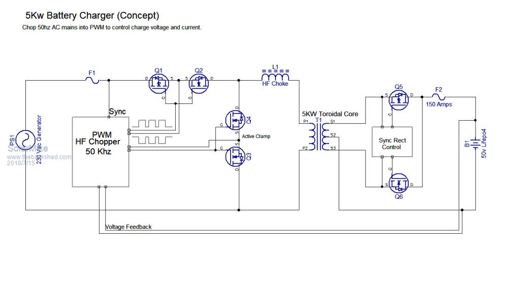

What to do with a spare 5KW toroidal core, perhaps use it to build a big battery charger for use with a 230 vac generator.
The requirement is to allow bulk charge into the bank independently of the existing solar chargers. There must be voltage control and perhaps current control at the charge end point. With a 100 or so amps I don't really want to be actively managing the output, would prefer to control the 230 vac side.
30 years ago I built something like this using thyristors and phase control, feeding a transformer, yes it worked but not that well. Also worked on high power rectifier sets that used bridge rectifiers with 1/2 the bridge being dual thyristors for power control, sort of old tech, so don't want to go there.
Today is different we have mosfets, so what I want to do is chop the 230 vac sine wave into high frequency PWM controlled square waves and feed that into the transformer primary. To prevent the back emf spikes, an active clamp shorts out the primary when the other mosfets are turned off, some dead time will be required.
Rather than use a diode output rectifier, will use a synchronous rectifier to keep the losses down.
Here is a concept schematic:
The waveform after chopping.
I don't know if the HF choke is really required here, but cannot hurt.
Normally the AC mains would be rectified and the high voltage DC switched into a ferrite core for isolation, resulting in a compact power unit, however whilst I do have some ferrite cores to play with, I don't have any big value 400 Vdc cap's on hand; with this big core sitting here, shame not to put it to some use.
Comments please, is there an easier way of building a big arse battery charger...

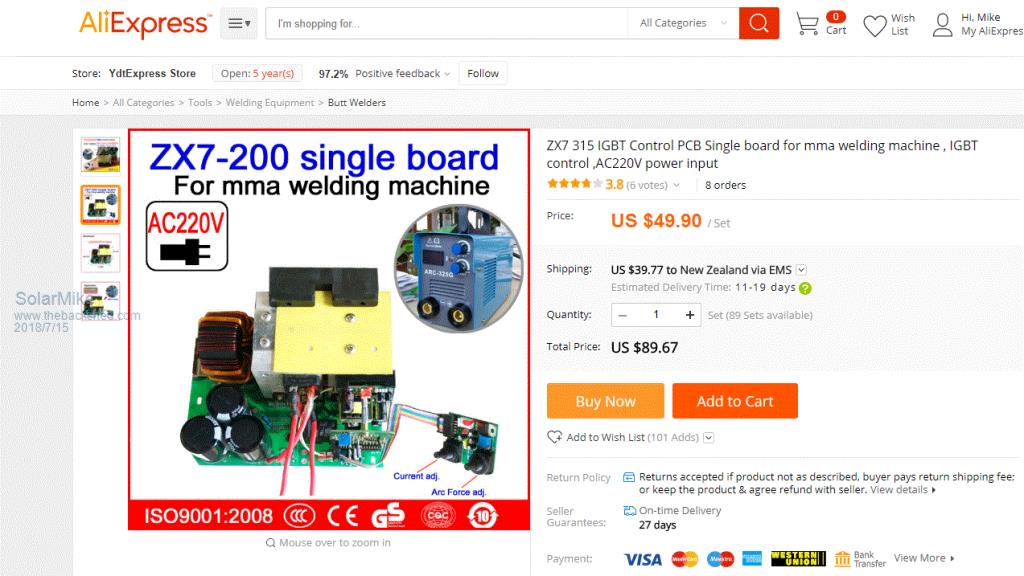

Did a search on AliExpress, the guts of those basic welders are available without a case; now this is something perhaps better to experiment with.
IGBT Welder Control Card

For about the same price here in Australia you can buy the whole welder on EBay as per the links above. They are quite light apart from the PCB there is not much else to them. The toroid on the right in the photo above needs one extra turn, the factory winding is Aluminium, it is not hard to replace with copper.

Mike your proposed topology does work. I used the front end of your topology (minus output synchronous rectifiers) to have a controlled AC current source by simply using a POT to manually dial in a fixed pwm from 0 - max. The AC output looked to have almost no distortion. It was for measuring earth resistivity @ 25A RMS for a whitegoods manufacturer. It was going to incorporate a feedback loop to regulate to a set current but the project was abandoned by the customer before we got that far.

Duplicate post - but I will add, that the choke between the switcher & toroidal was required. And I never hooked it to mains only ~ 20VAC but I am confident it would work ok on mains.

  wiseguy said   Duplicate post - but I will add, that the choke between the switcher & toroidal was required. And I never hooked it to mains only ~ 20VAC but I am confident it would work ok on mains.
Cool, thanks wiseguy, might order some IGBT's 600V 60A or similar rather than mosfets and have a play, probably use pulse transformer for gate drive in order to take the inputs below emitter potential for good switch off. Sync. output rectifier can have parallel mosfets (3 or 4) for efficiency.

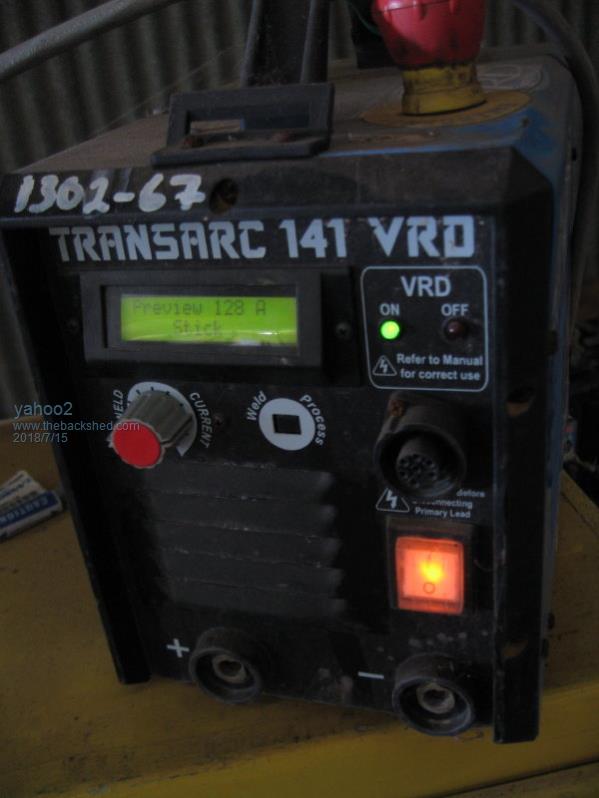

I would be very interested in what you guys come up with, I have several inverter welders like this professional grade CIG jobbies.
they are outstanding welders, I can weld something at 100 amps that a yum cha welder cant at 180 amps but I cant get them to run as a power supply at all. I know the lincoln welders dont work, there is to much "welder assist" electronics that cant be switched off.

  Solar Mike said   Man we have had days and days of cloudy dull weather this winter, need something to keep the batteries fully charged, cannot rely on solar here in NZ.
yeah, I understand that but there are practical things that become blindingly obvious when you do try and run a big charger.
if you go completely off grid, the power comes from a generator, most generators with a capacitor voltage regulator struggle to start a big charger.
Inverter welders are even worse, my 140 amp CIG's have a recommended generator size of 12 kw. A 7 kw cap reg genset wont run them at 100 amps.
So we buy the biggest single phase generator we can find and end up running it for hours trying to top up our lead acid cells at a trickle.
Alternatively we can install a bank that doesn't need to be fully charged (lithium) at a cost of 25% more, use a 2kw inverter genset and smaller PFC chargers but we lose that large reserve capacity for that once or twice a year night time heavy load.....so we start the little generator.
Nothing is perfect just some things are a better match to certain situations than others.
