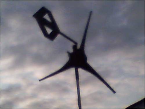

I would like to say thanks a lot to start, The Back Shed website has helped me greatly. I'm totaly new to electronics (well all of this really) So sorry if this is stupid. heh I have made a windmill and have a shunt regulator working (picaxe) that i basically copyed from the website. My regulator has 3 dumps 1 batt other 2 just dumps and it works but i would like to put a diode on the batt leg. When may batt is charged and the volts increase load 2 comes on and if volts continue to rise then load 3 comes on. What happens to me though is the battery runs load 2 and 3 but i would like just the windmill power going to those. Anyone know what kind of diode or whatever i could use to isolate the batt from flowing back into the loads. It would have to handle 30 amps into the batt and nothing back out. I tryed 6 amp rectifier diodes from radio shack ( twisted together 5 and ran through them ) but they seem to get pretty hot with only 7 amps going through them. I don't know what any of the stuff on the back means but does Vr: 35V imply that they only run at 6 amp when at least 35v is applied to them? My system is 12 volts.
Thanks for your time.

Thanks for the info guys. I finally did find a data sheet for that schottky and saw that. I could just use one leg on those couldn't i? Or go into the outer legs from one power source and run the load off the middle?
sorry my cell phone cam is pretty crappy
