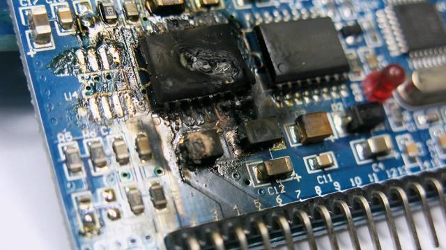

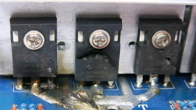

The story always seems to begin with
".. and it was all going smoothly."
Time for the pictures.
I wonder if the tantalum cap went short then the gate drive IC.
Some EG002 boards have electrolytic caps now. I wonder why.
Cheaper parts? Or better to use caps that fail open...
Dunno.
Both legs of the 50Hz 1/2 bridge blew.
The DC-Dc converter (50V -> 12V) survived, which drives the EG002.
No problems really, the biggest issue is the stink of magic smoke
we enjoyed just as I had finished cooking dinner.
I have a standby unit already in operation.

Oz referred to those tantalum caps in the past being not suitable for this particular gate drive situation. .in fact he tried just ceramic and said he had problems too.. maybe something in that...
