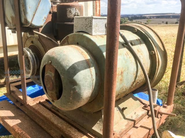

I've come across this big old 6kva 4 pole Dunlite generator with a Lombardini diesel engine. I'm not sure if the engine runs yet but thats not really important, my main concern is getting the alternator running.
It has what seems to be an old style of AVR. At first I couldn't for the life of me figure out how it was supposed to work, until I realised that the field findings are stationary and the power windings are in the rotor. I've never seen an alternator set up like this but maybe it used to be more common.
Basically there seems to be a transformer, the primary winding of which is in series with the load. So the greater the load, the more current through the primary and I guess the more current is produced in the secondary, which feeds the field. There is some capacitors and a contactor in the circuit, the purpose of which I haven't really gotten my head around.
I'm not sure its worth attempting to resurrect the original AVR, its not in great shape. I was originally going to throw a cheap universal AVR at it, but they seem to be made for more common rotating field generators with a field winding resistance of 10-100ohms and operate at about 90v. My field winding has a resistance of 140ohms. I'm guessing its designed to operate at a higher voltage (and therefore lower current).

I thought I'd update this old thread because I did finally get the old girl up and running, and maybe it'll help someone else out some day.
I did get the engine running and connected one of the chinese cheapy AVRs. It did work, but as I suspected the high resistance field windings need to see a much higher voltage than the chinese AVR can ouput in order to maintain a stable output with any kind of load.
Essentially, the AVR had to run flat out at 100vdc to maintain the output at about 230vac with no load. Any load and the voltage dropped, because the AVR was already giving all it could.
I thought about it for a while and posed the question to some engineers on another forum, but received no really useful suggestions. Scrap it and buy a new generator, spend big $$$ on an AVR that can output the higher voltage you need, that sort of thing. But the purpose of the exercise was to get this particular generator going and not spend a pile of money on it.
I decided to take a closer look at the field windings. Being a four pole unit, there are four field coils in the stator, and they are connected in series. They are quite large coils and I suspect they have lots of turns, which explains the high resistance.
So the simplest solution I found was to rewire them so that instead of all being in series, there are two pairs of two in series, in parallel. This means each coil sees a max of about 50v, instead of 25v as before. This doubles the current draw, of course, but its still well inside the rating of the AVR.
It performs beautifully now. It actually belongs to my uncle now, and he's given it quite a flogging. He ran 5-6kw of halogen flood lighting off it, for probably 50 hours or so, and it took it like a champ. The Lombardini diesel is a horrible noisy thing though.

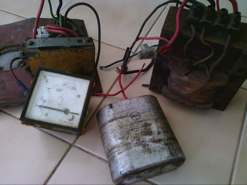

My old original 5Kva 12Hp single cylinder Wisconsin had a regulator similar if not identical to yours.
It was horrible when it worked, voltages all over the place, and it would occasionally pin the 300 volt voltmeter at max. I was too afraid to connect anything up to it, it would pop light bulbs with ease.
Never did figure out exactly how the voltage regulator was supposed to work.
Your best bet is to use a modern electronic regulator, as suggested.
A lot of this stuff is truly ancient and not worth trying to restore back to original.
Much more sensible and practical to add some modern technology to it.

I just found my old original regulator, thought I had tossed it out long ago.
Very similar to yours, 20uF oil filled capacitor, current transformer, and big screw terminal block.
