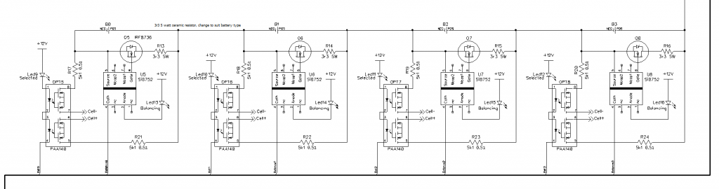

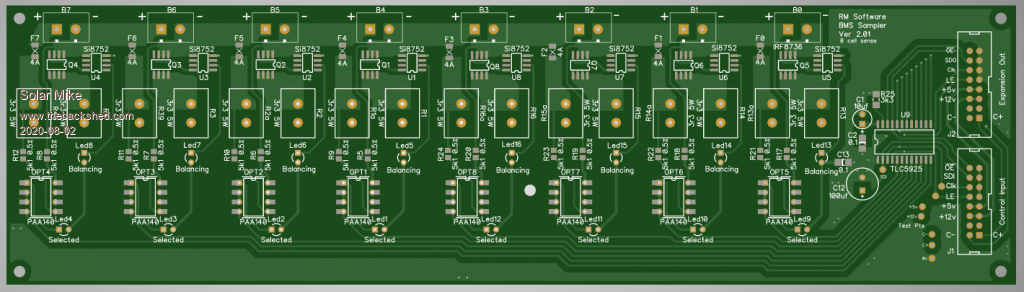

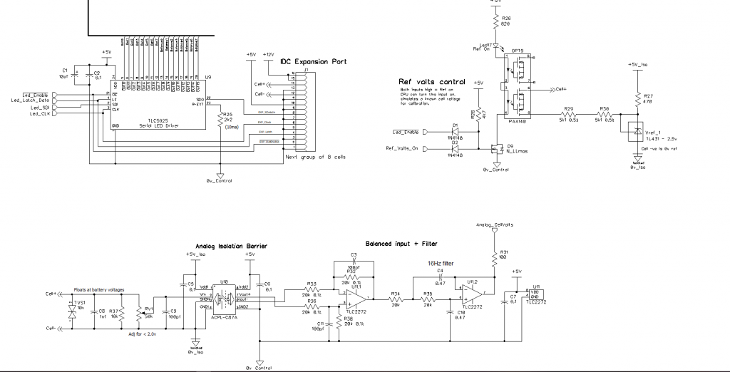

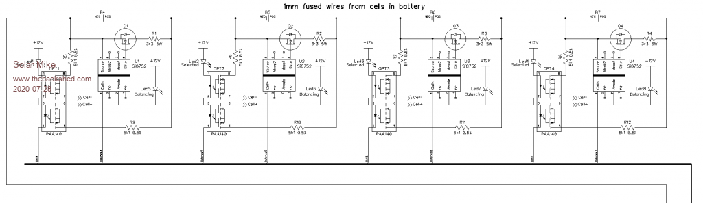

In the process of re-designing my battery management system, now that we have moved to Lead Carbon Cells @6 volts, 8 in series for the 50 volt bank; the Lifepo4 BMS design needs re-visiting. As an aid for initially getting all 24 of these batteries to the same state of charge prior to assembling the bank, I want the BMS to have a cell balance load capability of 3.5 - 4 amps. This will allow connecting up any 8 cells in series to a current limited fixed voltage supply, the new BMS will ensure they all charge evenly and still charge reasonably quickly, will use a 300W PV panel + small up-converter as the charger (no AC power on site).
Have decided to make this system modular, the cell sense balance boards especially are all identical, for 6v cells only require 8 monitor points, however if someone else wants to use 3.2v Lifepo4 then 16 will be required. Initially was going to construct a small pic based cpu board placed across each cell in the bank, with opto connected serial bus to talk to a master controller. But having made the decision to have a high dissipating cell balance load it makes better sense to run suitably rated wires to each cell via a 10 amp fuse and multi-pin connector on the other end; plug this into a central unit with large heat sink + fans etc. This setup has the advantage of allowing changes to the system without having to mess around in the battery bank eg. there was some discussion here last year about transformer balancing, still want to do this, and easier to accomplish having all electronics in the one place, just swap out the balance boards with new ones.
Here is the design for each cell sense\balance module, they will sit vertically and plug into a mother-board.
Each cell module is opto-coupled to the mother-board driver, using optimos switches to select each battery cell in the bank, if the main driver is also running off an isolated power rail then essentially the driver is connected directly across each cell. OnSemi make some neat LED driver chips that are serial driven, they make connection to the cell modules very easy, a single resistor selects the led current to the module opto-couplers. Will have the CPU board plugin also to allow a PIC or Arduino etc.
2019-01-13_162248_BMS_DriverSchematic.pdf

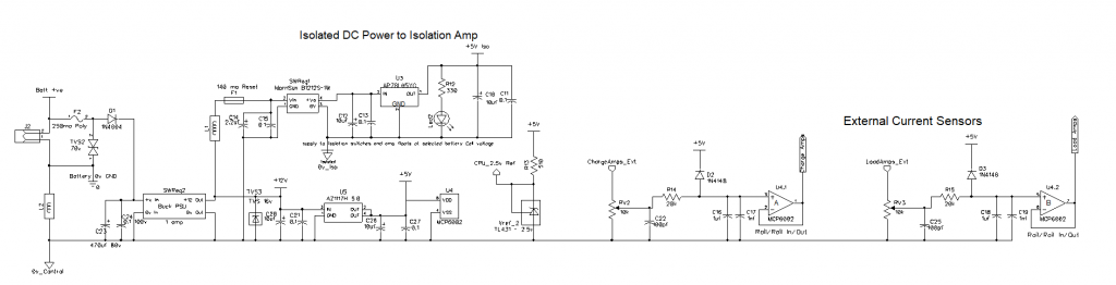

The driver-CPU board floats up and down across the battery bank, so any external connections to it will have to be via data-bus isolators or opto-couplers.

I'm working on a simular project for LTO and lifepo4 battery. I'm using Laa125 optomos, I think it's cheaper but a bit slower.
For the active balancing, I've build something for 2 cells and it works great, it's modular so I need to make more boards for expanding and testing the setup. It's something simular then wiseguy suggested. I will soon post a photo.

nickskethisniks
Joined: 17/10/2017
Location: Belgium
Posts: 499
Posted: 09:59am 14 Jan 2019

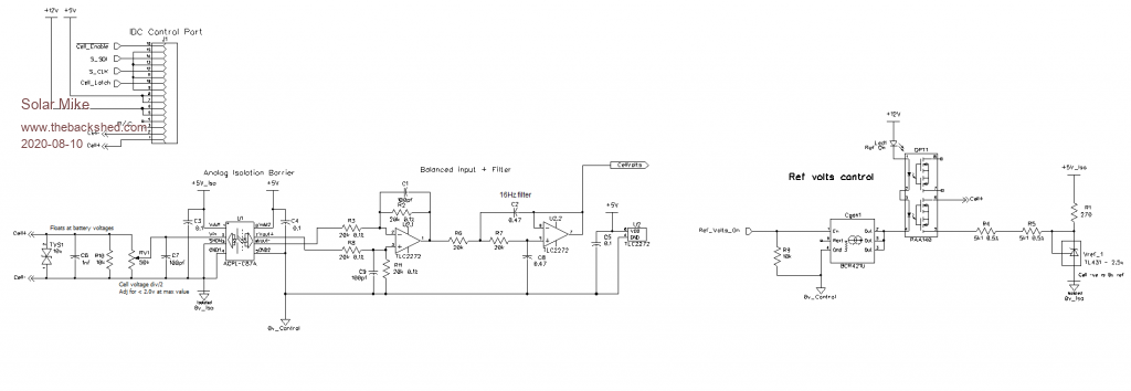

Is it smart to use that 1uF capacitor?
There are 8 capacitors in parallel to charge(with 2kohm), won't it influence the measurement, or the rising/charging time of the capacitors?

Solar Mike
Joined: 08/02/2015
Posts: 1255
Posted: 10:23am 14 Jan 2019
One RC per Cell (2k,1uf ceramic) = 2ms time constant, its only there to lower the impedance to HF noise, wont affect any readings. It is paralleled by another 2K on the driver board (latest schematic) to half the battery volts into the cell voltage filter, that's now running off 5v instead of 12, using 0.1% resistors.

Posted: 10:49am 14 Jan 2019
Noise is definitely going to be a problem. All those large cells, all that wiring, and heavy ripple current from the inverter, plus the one bit ambiguity of most analog to digital converters.
I tried analog smoothing, but found it not to be as effective as hoped. I even tried some 1 Farad Ultracaps that had about 15 ohms of esr. Still had noisy bouncing bits.
Software averaging was vastly more effective. I read my analog to digital converter 256 times with a delay in the loop so it took as close to 20mS to take all 256 readings as I could get it. Lovelly smooth repeatable noise free readings after that.
Those optically isolated mosfet switches are slow, and you need to give them plenty of time to turn both fully on and fully off.
I also multiplexed the drive to the opto switches.
My thirty cells are physically arranged 6 x 5 so I needed only eleven wires to control 30 switches. And it still looks like a rats nest....

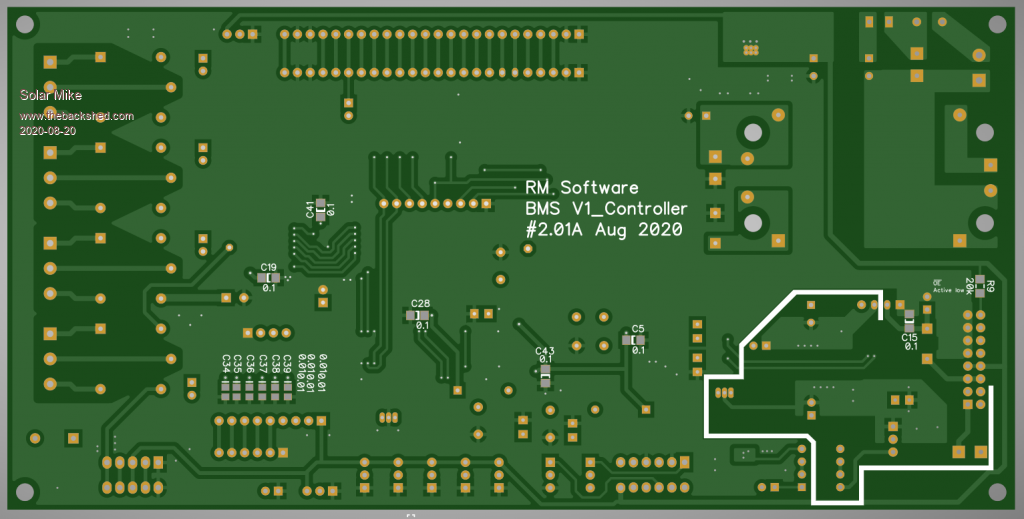

Just doing a tentative PCB layout now for the driver board, Rats Nest is one way of describing it...
Posted: 11:29am 14 Jan 2019
I used one six way, and one seven way screw terminal block on my driver board, and two lengths of seven core light duty trailer cable to connect to the battery.
Solar Mike
Joined: 08/02/2015
Posts: 1255
Posted: 03:19am 24 Jan 2019
Took awhile to do the PCB layout, bloody rats nest of connecting wires everywhere, having the battery sense component connections as plugin modules helps a lot.
In the end used a Picaxe 20M2 cpu, all IO's used bar one. If I want to export the battery cell data to a master unit, will have to use a cpu with more IO's, 28X2 or similar and use opto couplers or data-isolator's onto something like a 1-wire bus.
I think I need to start using Arduino chips, these Picaxes are quite expensive especially the 28/40 pin versions.
TOP:
Bottom:
Mike
Posted: 04:58am 24 Jan 2019
I had a similar problem, just ran out of i/o and pins on the processor.
Had to use the serial PIO port pin to drive an external shift register.
That can then be stretched right out to drive any number of output bits, its slow, but plenty fast enough for this kind of ultra slow motion battery cell sampling.
I also fused both sides of every cell before the mosfet voltage sampling switches.
I discovered that a 100mA M205 fast blow fuse will pop every time before the mosfet switches are damaged.
If the software has a brain fart and crashes, there will be fuses flashing all over the place. A real pyrotechnic display.
Fuses are cheap, the mosfet switches much less so. My score so far is an estimated 120 blown fuses and zero blown mosfet switches.
The fuses fail open circuit which is a self limiting disaster.
Mosfet switches invariably fail shorted, so if just one shorts out, it will probably take out every other in a cascading failure.
A prospect too awful to even contemplate.

  Warpspeed said   ...The fuses fail open circuit which is a self limiting disaster.
I hope to avoid that scenario, all battery sense wires are fitted with 10a fuses at the battery to protect the cables. Each module board has a 6a resetting fuse for the balance load and 2k of voltage sense resistor prior to the switch, so max current that could flow assuming lowest and highest cell switches on simultaneously would be 25ma. I'm hoping that is enough to survive the probable initial programming stuff ups.
As there is already a common clock and data lines running to the switch mux's, I could add another serial//Parallel chip to control the relay's, thus giving me the extra IO's needed for Remote 1-Wire bus connection...
