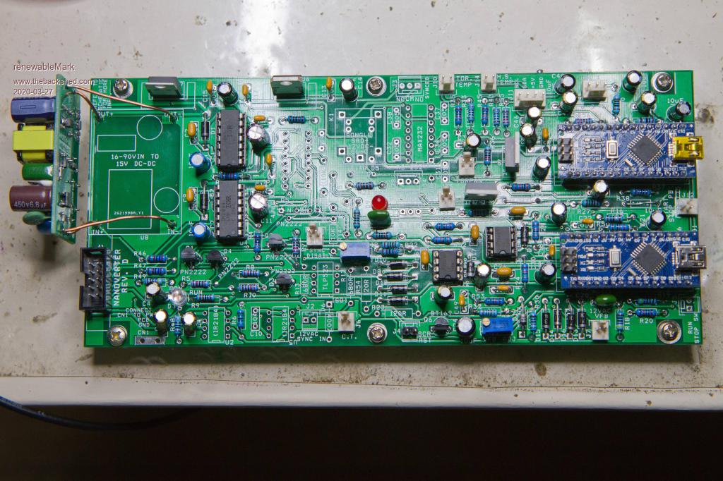

Hey guys, just started assembling my nano control board.
Just want to confirm the silkscreen markings, does the line here mean the negative side?
Cheers Caveman Mark

Yes, it is the cathode of the LED. If you have a DMM with diode test function, placing the negative probe of the DMM at the cathode and positive probe at the other LED pin (anode) will show voltage across the LED and most of the time will also make the LED light up.

renewableMark
Joined: 09/12/2017
Posts: 1679
Posted: 08:26pm 17 Jan 2019
All done.
Sourcing the dip pinned chips was a bit hard so ended up making some smd adaptors using the long header pins.

tinyt
Joined: 12/11/2017
Posts: 564
Posted: 12:49am 18 Jan 2019
Nicely done.
As a precaution, prior to first power on, I would remove all socketed ICs, then apply power and measure for correct voltage outputs of the dc-dc, the 7812, and 7805 linear regulators. If all good, install one IC at a time and remeasure the output voltage of the linear regulators after every IC install.Edited by tinyt 2019-01-19

renewableMark
Joined: 09/12/2017
Posts: 1679
Posted: 08:40am 18 Jan 2019
Thanks Poida, here is a pic of the board.

Maybe this will also help. Use a power supply with voltage output close to your battery bank. If your power supply shows load current reading, note the readings as each of the socketed ICs gets plugged in. Increase in current should be small. After all ICs are plugged in, do touch temperature test to the body of 7812 and 7805 every 5 minutes for maybe 30 minutes. Maybe heatsinks are not required on them.
Edited by tinyt 2019-01-20
renewableMark
Joined: 09/12/2017
Posts: 1679
Posted: 11:38pm 18 Jan 2019
Thanks Tinyt,
did that test, first with no chips, power supply was fine then the 7812 and 7812, tested fine.
Added the 21844 one at a time and voltages all ok, then the lt1638's one at a time and voltages still the same.
Then removed all chips and did the same test measuring mA.
Each addition of a chip rose the current slightly, when all 4 were in place the current was 11 mA, then when adding the two arduino's it rose to 53mA.
No noticeable temp on the 7812, 7805 is slightly warm to the touch after a while.
Will still put heatsinks on them though.
Prob not enough room for this
this should be fine.
So far so good.
No smoke!!!
BTW green LED bottom left was dimly lit.Edited by renewableMark 2019-01-20

Posted: 12:13am 19 Jan 2019
  renewableMark said  ....So far so good.
No smoke!!!
Excellent!
That green LED is being driven by nano1 pin 15. Try removing nano1 from it's socket and see if it turns off. I don't know what code is preloaded in the arduino nano when purchased.
renewableMark
Joined: 09/12/2017
Posts: 1679
Posted: 01:33am 19 Jan 2019
Yep, removed nano 1 and it goes out.

Posted: 02:25am 19 Jan 2019
  renewableMark said   Yep, removed nano 1 and it goes out.
I think it is intended to be just a visual indicator that PWM is running if the code uses it for that purpose.
I looked at the nano1 code, as far as I can tell PIN 15 is not being touched by the code. So just ignore whatever its condition is.
