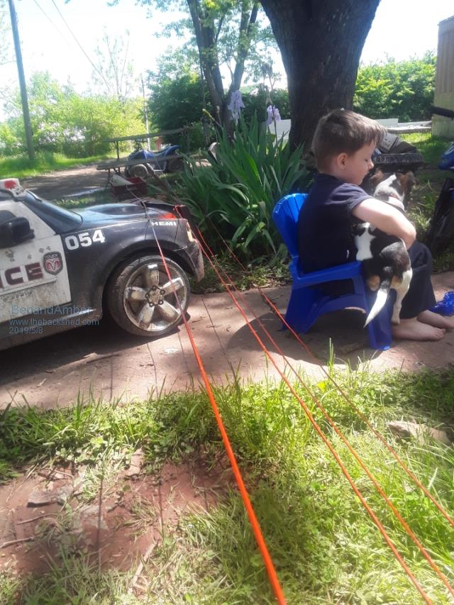

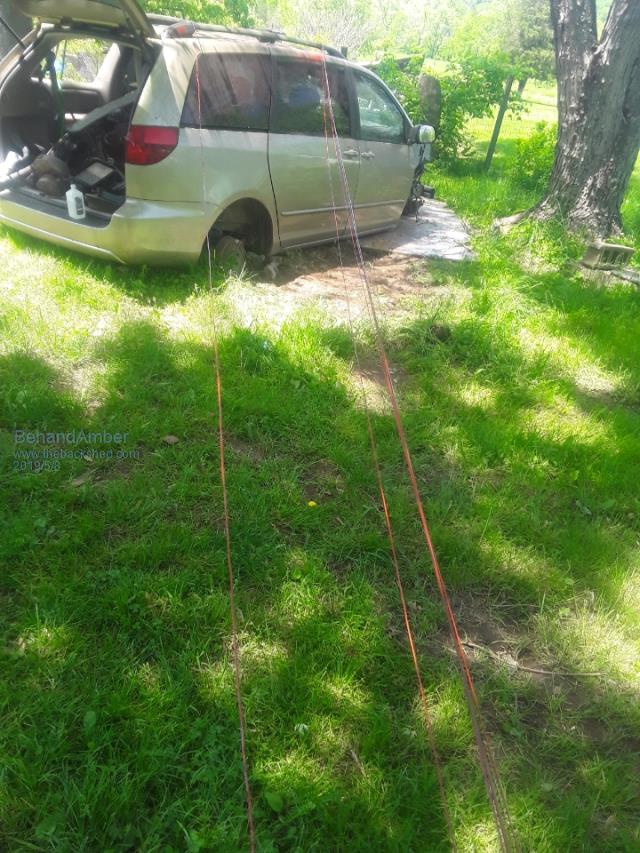

LadyN
I have wire stretched out right now in my yard
I tied it to the van my wife crashed and tied the other side to the hitch of her new used van
the wire was a little bit sketchy so I brought 3. 15 Oz cans of wire enamel paint and repainted it also
I stretch the wires one at a time
Then tied them off to anything heavy enough I could find including police car four wheeler milk crate with a bag of sand in it
Anything heavy enough to keep it off the ground so I can paint it
That's my youngest Sun (Zahyia) in that one pic he likes to do anything I'm doing and he is awesome at helping
He has his own toolbox and own tools and he can already take just about anything apart without my helpEdited by BenandAmber 2019-05-09
BenandAmber
Joined: 16/02/2019
Posts: 961
Posted: 06:39pm 07 May 2019
Yes for all of you that may be wondering I do have a junk car in my front yard I am from West Virginia what do you expect LOL
