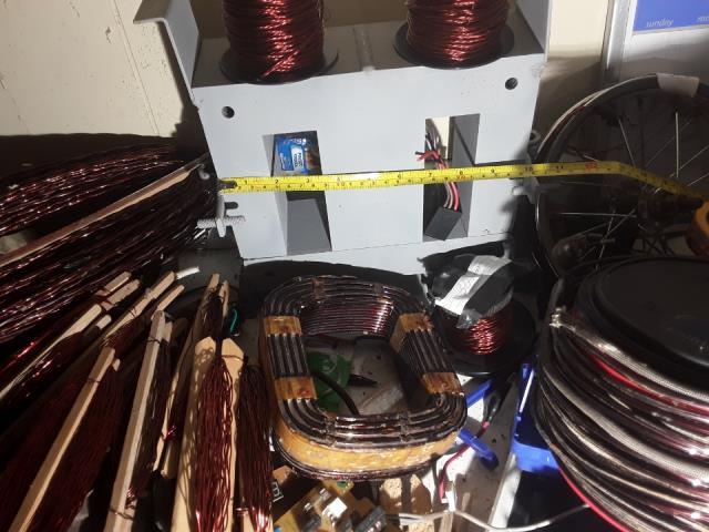

I've ordered a battery control module off of eBay when it comes in I'm going to wind Giant Transformer core I have and hopefully make a pretty decent battery charger in case there's one day that my solar panels don't fully charge my battery Bank I might be going about this all the wrong way the module I ordered is adjustable and it goes on the Mains voltage side of the Transformer 30 amp relay on the board that turns the Transformer off at the set voltage of the low side I'm thinking this may be able to give me 60 or so amps on the low side of the Transformer but I could be very wrong any comments would greatly be appreciatedEdited by BenandAmber 2019-02-20

This is the big heavy Transformer core I was planning on making into a 48v battery bank charger

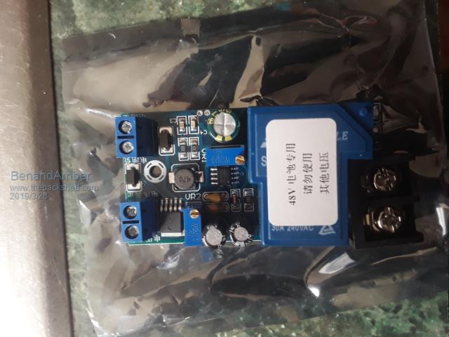

This is the little shut off module I ordered off eBay
It was under $10 including shipping
got to love that China stuff
If I understand it right
it has a 30 amp relay on there that goes on the main side of the Transformer in series
So on the secondary I was thinking I should at least be able to get 60 amps including all the losses
is this thing so big it will flip the 20 amp 1 20 volt breaker with a really dead battery Bank
I think that breaker will probably flip it around 18 amps
the breaker should do a little over 2,000 Watts
at 60 amps should only be about a thousand Watts on the secondary other Transformer
I may be going at this all the wrong way
I may need something to limit the amps
please chime in
I appreciate the helpEdited by BenandAmber 2019-02-27

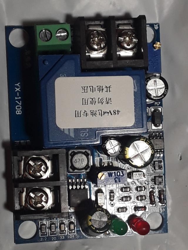

Picture above was the wrong module shipper sent the wrong one so I ordered the right one

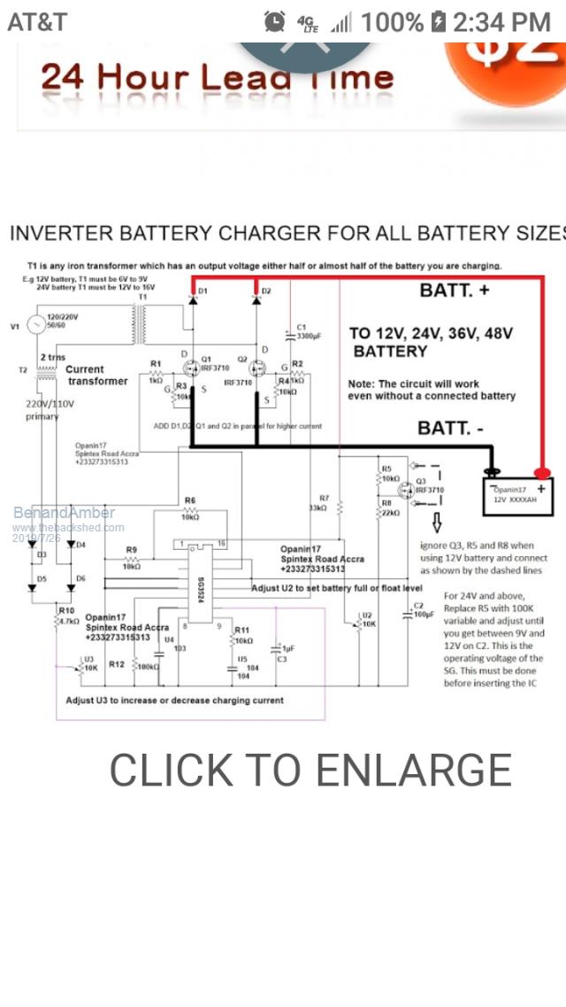

Any thoughts on this battery charging circuit
In this post earlier somebody mentioned using an mppt charge controller which sounds pretty awesome alsoEdited by BenandAmber 2019-07-27

  BenandAmber said
Any thoughts on this battery charging circuit/QUOTE]
That's a strange circuit you have there, the 2 mosfets will always conduct on -ve cycles, regardless of their drive due to their internal diodes, wired as they are, at best they will turn on harder shorting out the diode. In effect there is an uncontrolled bridge rectifier supplying DC to the battery... just doesn't make sense, are you sure that is a validated circuit or has someone posted a theoretical schematic that has errors in it.
Please post a link to the original.
