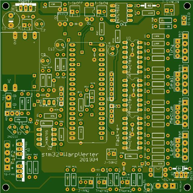

This project has been a joy to work on. It's come along very well.
All the resources can be found at stm32_Warpverter Github
The PCB features the four Transformer outputs which take pluggable terminal blocks or molex connects - and are 100% compatible with Tony's Inverter or my Eprom based Inverter board.
Other features include:
INPUTS : Battery Voltage is sensed on board, Two thermistor inputs, ON input, OFF input, Current Sensor input (3 pin 5v,gnd,signal), Sync input, and 12V input in case the ACDC power supply is not installed.
OUTPUTS : Four Transformer outputs, Two Fan controls, 50Hz pulse output (allows for Sync signal), Sync Relay control.
SPARES : Pins on PCB to break out 2 more analog pins, 4 digital I/O, RX-TX port.

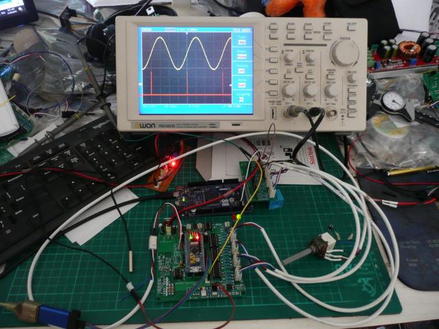

Forgive my messy bench. The Simulator has been invaluable.
The software went through an evolutionary process. The Warpverter software makes extensive use of table look-ups. And why not, the basic BluePill has 64k flash Rom. Eventually I peeled the table building process away into another Arduino program.
The Warpverter is fully functional. The ADC is fully implemented making use of the dual ADC of the BluePill. I have the DC voltage as the sole input to ADC2 and is running in continuous mode. All the other analog inputs are muxed, or using scan mode of the ADC and results are DMA'd into an array. Apart from setup, this happens automatically by the processor, without software intervention. Very cool.

mackoffgrid
Joined: 13/03/2017
Posts: 460
Posted: 05:41am 21 Apr 2019
Tony, as soon as my plug-in terminal blocks come I'll send you a board.
I have just uploaded Version 008 of the software which includes Poida's Mains Sync routine. The stm32_Warpverter has a 50Hz signal output (about 25uSec pulse) which should allow multiple Warpverters to synchronize.

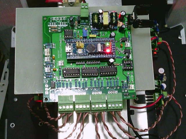

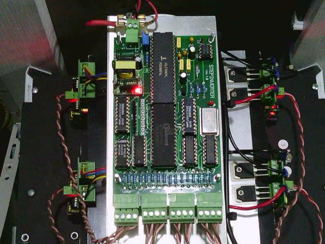

Posted: 11:43pm 07 May 2019
After a huge amount of anticipation Andrews stm32 board has now arrived in the mail.
First I hooked it up to my simulator to verify operation and select some suitable components to suit my 90v to 180v dc operating voltage. Everything worked exactly as expected without any surprises.
It plugged straight into my inverter replacing my driver board without any changes, applied dc power and up came a beautiful clean 242 volt sine wave. Tweaked the adjustment potentiometer back to 235 volts. And it was as simple as that.
The largest load I had that was convenient was a 1.6Kw hot air gun, so I switched that on and off a few times which caused the inverter load to change pretty instantly from about 200 watts to 1.8Kw, not the slightest trace of light flicker.
Next test was to switch the battery off and most of the solar panels off, just leaving one 2Kw string to drive the inverter. Switched on the hot air gun, and the ac voltage sagged to just over 100v, but it was still a perfect sine wave.
I just wanted to see how it responded and recovered as the dc input voltage went from about 140v down to a miserable 60v a massive overload. Switched in a second string of solar panels and I was back to a rock steady 235 volts.
Fantastic performance Andrew, a perfect sine wave and the speed of response to step load changes from a horrible saggy solar voltage source is incredibly fast. Its at least as good as my own board, possibly even faster.
I am just going to let it run for a day or two. The stm32 board is a complete and total success, and it raises the Warpverter concept to a whole new higher level.
The inverter part of it is now proven to work very well indeed in a real inverter, and it offers huge future possibilities for increased functionality.
Here is the mighty stm32 in action:
And with my own original board:
I have not shown any output waveform, it looks identical to my own output waveform which everyone is probably tired of seeing by now.
