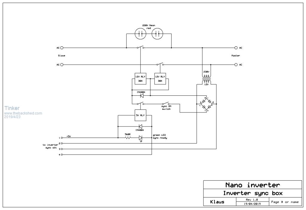

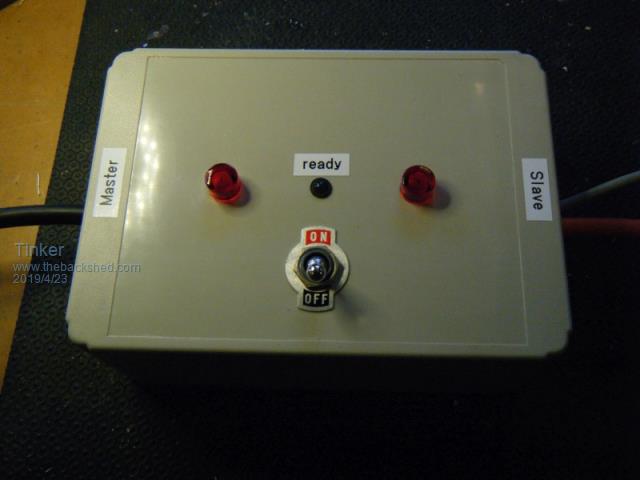

To connect the AC of my two test inverters together in sync I made this box:

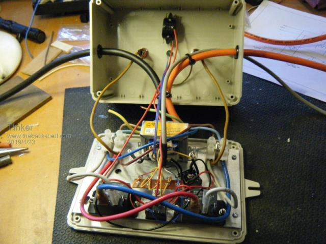

It looks plain enough on the outside but not inside :
It was surprising that the connections of the simple schematic created such a rats nest of wiring. Just as well I choose a large jiffy box as it got pretty full in the end.
Some explanations:
The two Neons in series indicate when the two inputs are in sync or not. They go bright when 180 degrees out and extinguish when in phase. Its just an indicator if a two trace CRO was not handy. BTW, that CRO must have its ground isolated. I use 100:1 home made probe adapters which can plug directly into a AC GPO.
The switch is the final manual control to synchronise, I did not want that to happen automatically - and just as well .
The green 'ready' LED shows when the nano inverter (Slave) has synchronised to the master inverter.

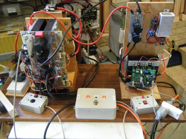

This is the test set up:
Setting up: Switch OFF, Adjust both inverters to the same voltage (230V), no load connected, both inverter outputs monitored by oscilloscope trace, Synch inhibit link in place on nano inverter control board.
The Master is a EG8010 based inverter, the Slave a nano inverter.
OK, powering inverters up, the Neons light & go dark and the CRO traces show how the two sine waves drift in and out of sync.
Good so far, now removing the sync inhibit link (I use a two pin shunt header). The green ready LED comes on and the CRO traces immediately try to align but come to rest 180 degrees out of phase.
That is where fitting that switch had paid off
Problem was easily fixed by swapping the primary leads of that little transformer inside the box.

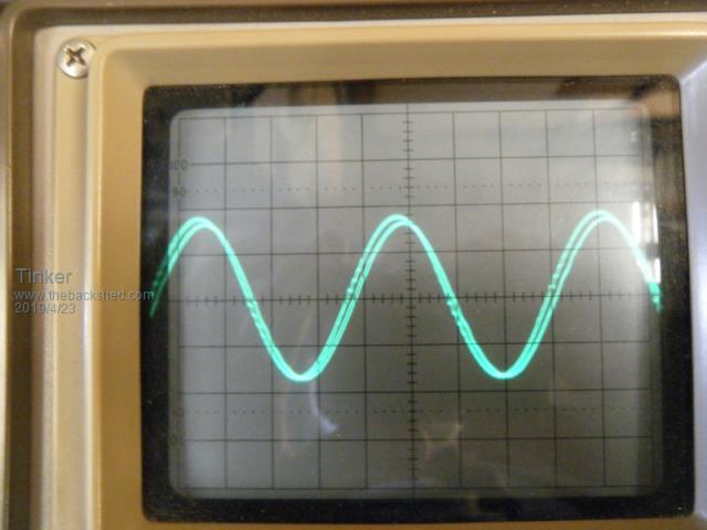

Try again, the CRO traces now in sync but not quite , see pic:
The 'serrated' trace is from the EG8010 inverter.
No idea why, so, after scratching my head for a while, I decided to throw the switch ON.
Well, no bang but the 5V relay was cattering badly and the sine wave developed a hump on its side.
No good.
So, poida's nano program enables the inverters to synchronise but not quite complete, the wave peaks are a few degrees out from each other and locked in that state.
I am open to ideas as how to fix that.
ISR (INT0_vect)
if (int_f == 0)
return; // only once per 50 Hz cycle. Noise! much noise...
int_f = 0;
pcint = pcount + (v1low == 1?200:0) - 200; // get position in 50Hz waveform, -200 to 200 counts
// pcint is position in output waveform when this interrupt occurs
phase_error = (pcint - 4); // subtract setpoint, 0 for my setup, in counts
the "location" where the slave locks onto the master is defined in the below line:
phase_error = (pcint-4)
pcint = the phase angle of the slave when the mains sync interrupt occurs.
The angle is measured in counts, where 200 counts = 1/2 of 50Hz.
Each count = 1/20kHz
Now, I subtract 4 since that lines up my test mains sync master signal quite well with the slave. The 4 accounts for delays that exist in the mains sync signal sample processing, including the opto coupler delay and interrupt latency.
We can have any value, it does not need to be 4.
I expected we will need to alter this value, to suit local conditions.
Each of our builds probably will need a different value than 4 to align the two waveforms.
So, could I suggest you try a different value than 4 in that line, maybe 0.
This value can be anything, positive or negative.
Try 0 and load that code into nano1 and see how things line up. Or not.
0 - 200 counts is equivalent to 0 to 180 degrees phase difference.
Have a go and show us what value lines up things with your system.
