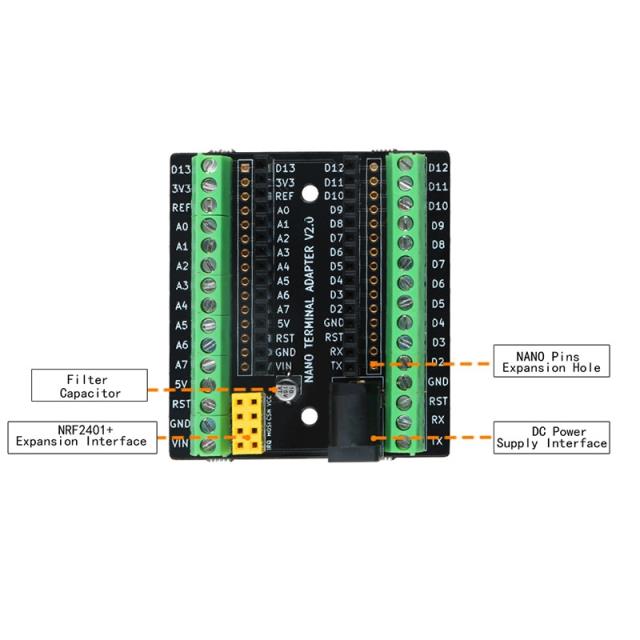

Mark, I just got one of these
from Aliexpress
Maybe useful to check the function of the little beasties?
I could write some simple digital output tests, you hang a CRO probe off it and observe or not the 5V pulse. Code the ADC to read each of the ADC channels, you run the serial monitor and put 5V on each channel in turn. Then check for digital inputs.
Maybe all we need.

Very handy, I was running low on the recycled aerosharp ones, so got some of these
Just need a simple power board for testing really.
